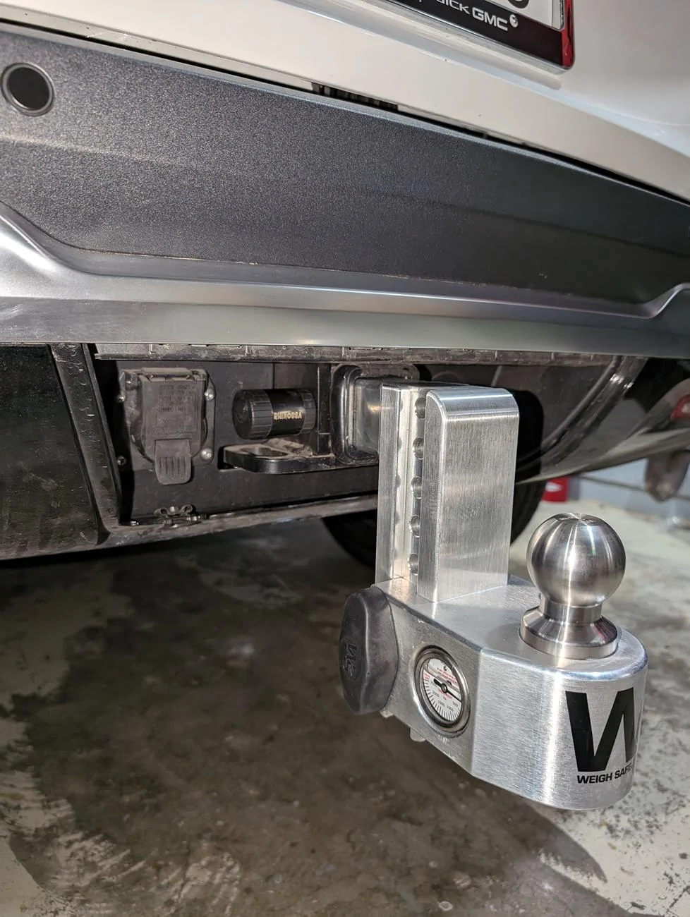

Hey All. First post!
Have been looking at the Weigh Safe hitch and am wondering on the drop length. From those that have them, what did you go with? Just got the truck and will be (eventually) towing different trailers, from teardrops to U-hauls. Want the most flexibility, but not overkill. Was thinking the 6”? Anybody find it fits too close to the truck?
Thanks!
Thanks!
I got the 6" aero hitch and it's worked well for a variety of trailers. It does sit pretty close to the truck but I have yet to have an issue with interference or anything like that.
If I had to do it again I might go with the standard weigh-safe instead of the aero. The ball on the base model is replaceable, while the aero has a permanently mounted 2" ball. There have been a couple of occasions where I needed to tow a small trailer with a 1.75" cup and needed to borrow a different hitch.

I'm tempted by the aero as well. Were you able to test it as a rise instead of a drop? I thought I saw someone say that clashed but can't track it down. Thanks!
Sorry for the long delay but I finally tested this and you cannot use it in a rise position because it hits the bumper.

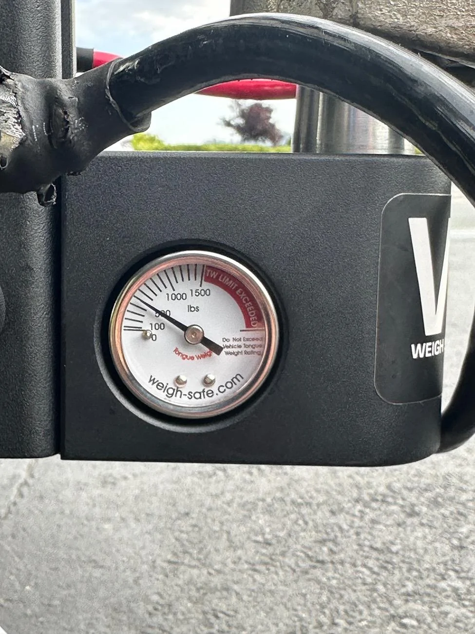

Thank you! You still beat me to an answer even though I already bought it and haven't tested it. Prime Day sale was too good to pass up.
Was disappointed by how inaccurate it is at low tongue weight but I'll just have to stand on the tongue and do some math for light loads.
