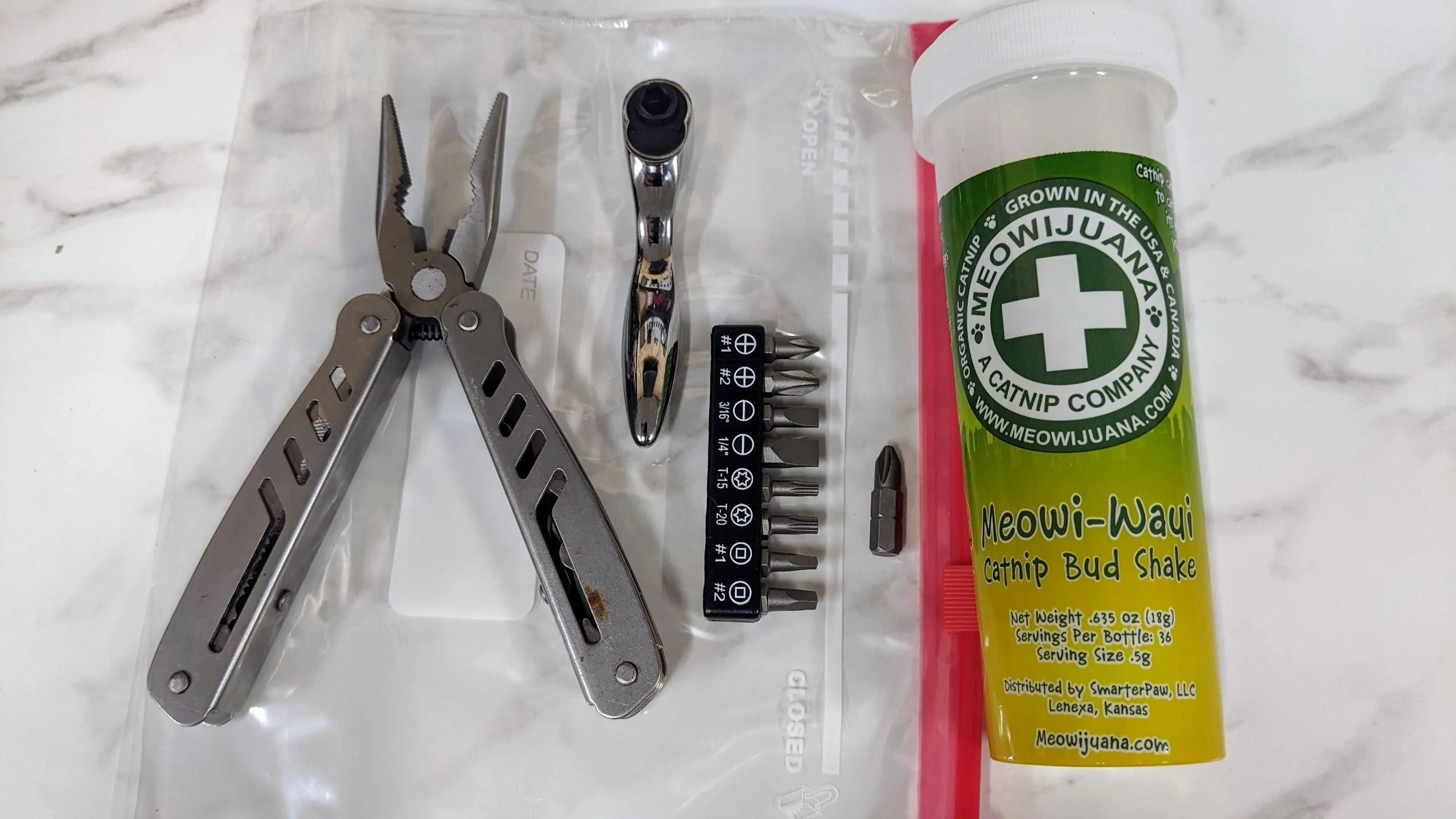

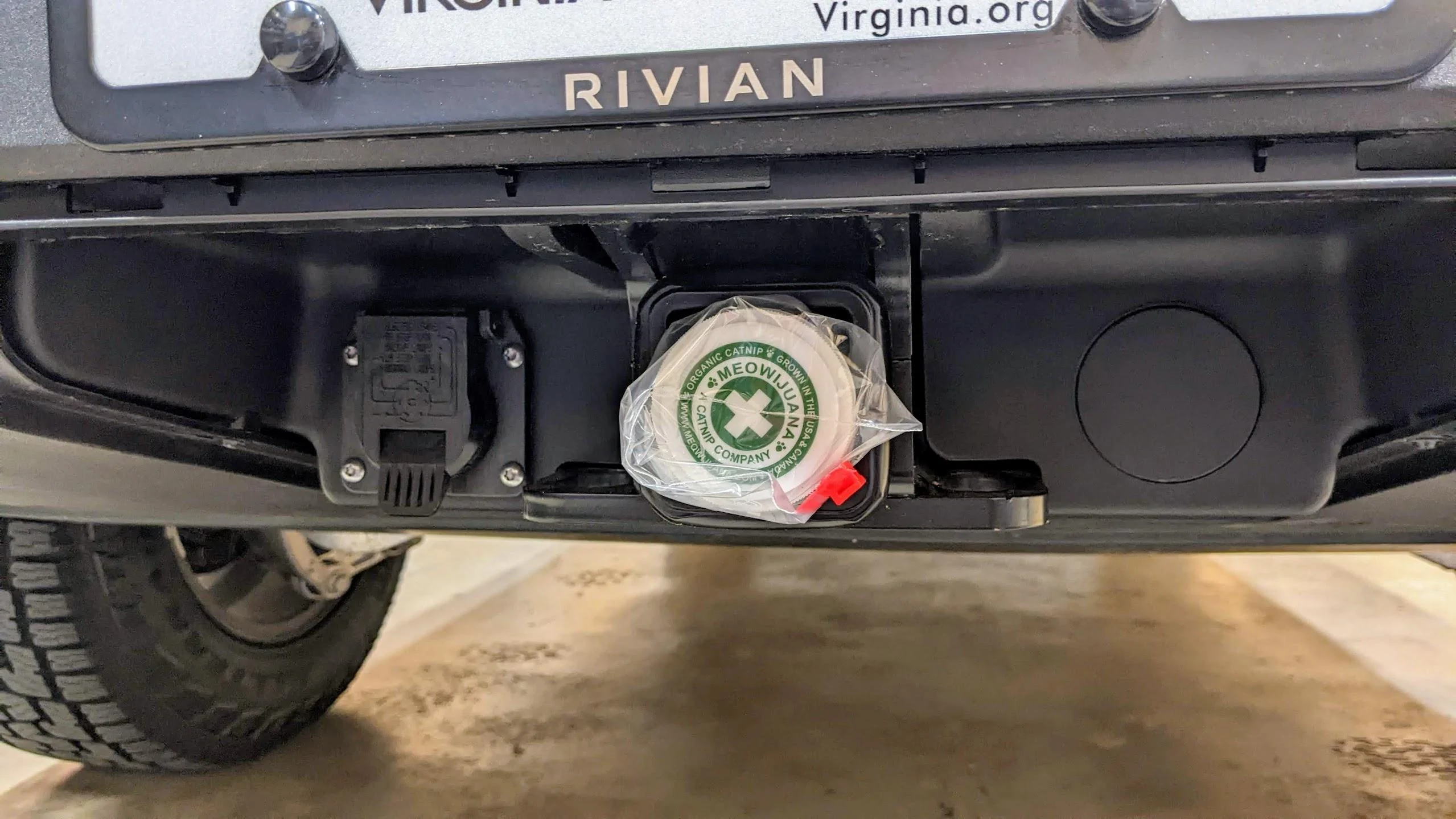

My truck is loaded with tools in the frunk and gear tunnel for my job. But for the truck itself, I would recommend T15 and T20 bits in a location you can access if the battery is completely dead. I went with this. Partially for the humor value. ?
Rivian R1T R1S Tool Kit? original_5ee5dab2-aaba-4664-8e2b-ef513b31f781_PXL_20230803_041316699
Rivian R1T R1S Tool Kit? PXL_20230803_041644065
ah yes! Those Torx bits are a critical one! That's a perfect example of what I was hoping to get out of this, aside from general wisdom of the crowd. A set of screwdrivers doesn't do any good if you don't have the right bit!
My first tool addition was a Klein ratcheting screwdriver that does have T15 and T20, but those won't do me any good if I'm locked out. I've got a couple of hand tools that can use a hex bit in a pinch. Might throw one of those and a set of T15 and T20 into my EDC (and transfer to hiking bag as appropriate).
