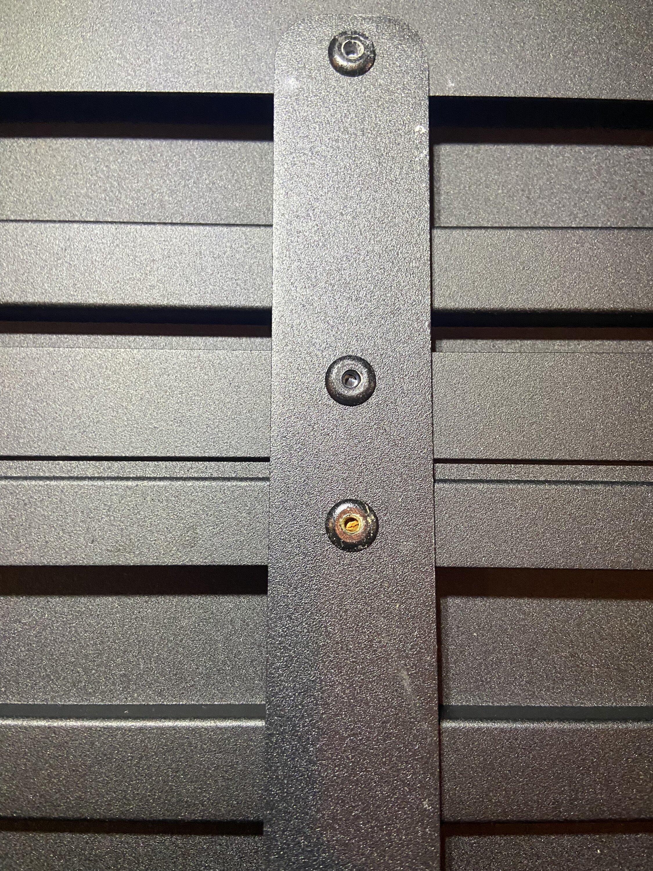

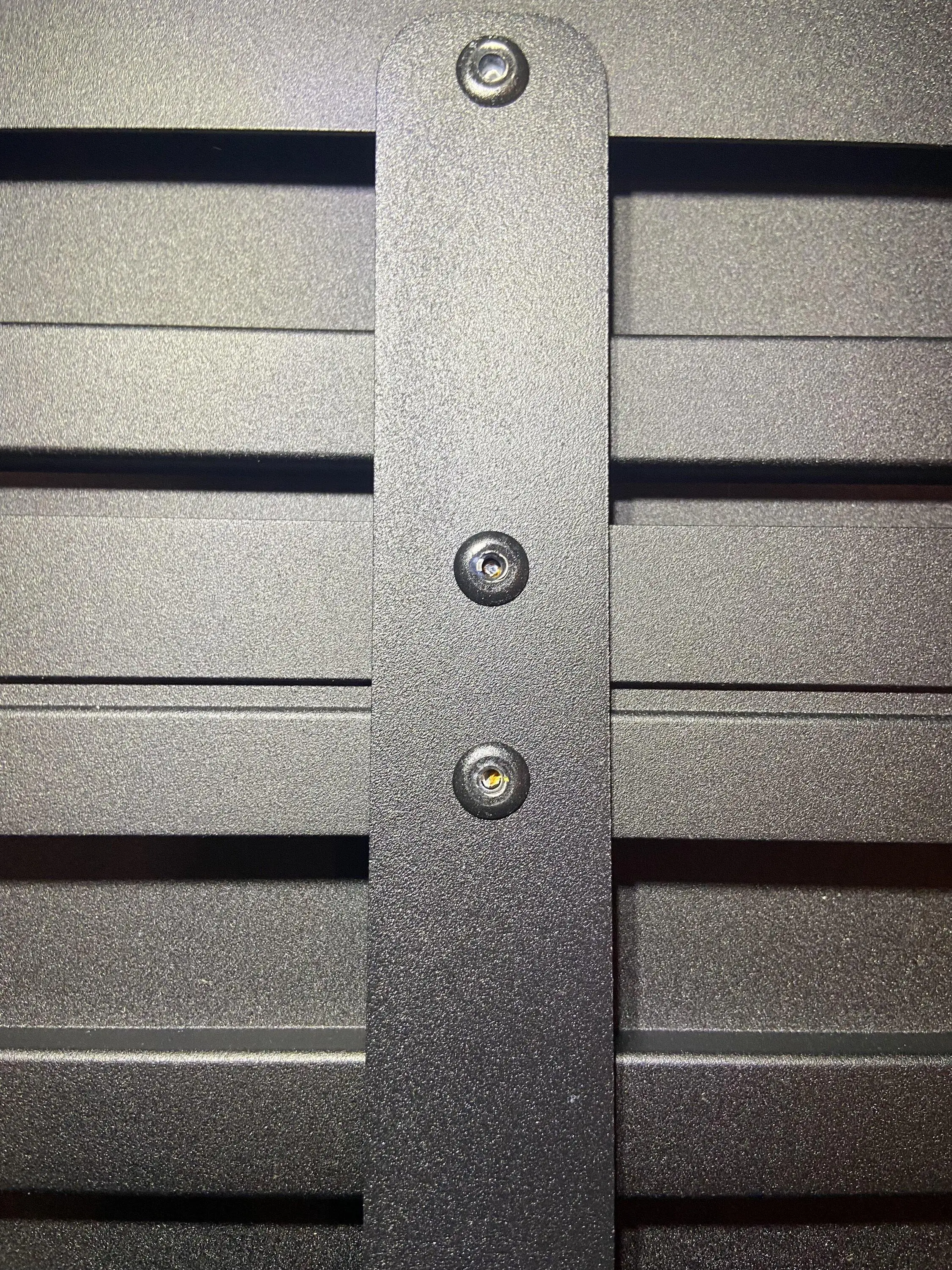

also added weatherproof sealant to the OEM manual tonneau along the edges. it was already pretty good about water intrusion and its gotten slightly better with the sealant.
fyi, my tonneau is starting to rust on the underside. luckily, its the broken one that was shipped to me. still waiting for the replacement. but going to treat the new one before i install it.
