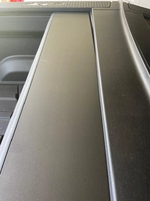

Anyone else with a slight overlap of the panels? Or does everyone have this? the last two panels lay flat when it is out - the rest are slightly overlapping at one end.

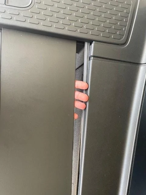

My tonneau “broke” today but then self repaired. It was open for a couple days. I tried to close it and two panels came out then everything stopped moving but the motor kept making noise.
I thought it might be stuck so I grabbed the panels to help it come out and, surprisingly, they disengaged from the rest of the cover, sliding loosely back and forth in my hand.
I slid the panels back to the far end of the bed, hit the “open” button and the two orphan panels engaged with the rest of the cover and disappeared.
Reluctantly I hit the “close” button one last time and all the panels came out to cover the entire bed.
Note: the cover has only been opened three times since I’ve owned the truck (10 days total). I said “broke” in quotes because I wouldn’t consider this actually breaking but wasn’t clear that this was behaving by design.

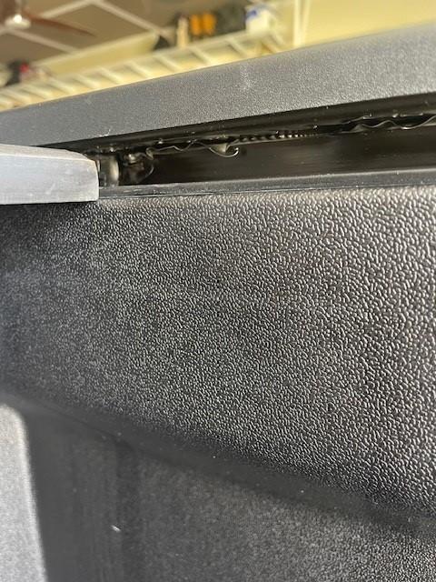

Add me to the list of broken tonneau covers.. mine just jammed up this morning. :mad: Appears it tore through some plastic liner on the inside of the track on the passenger side. I can't get it to move at all and the one panel sticking out is pretty much disconnected from the rest as I can pull it out almost.

Ours has overlapping panels which I thought was wrong, service tech told me they should be overlapping some, if they are flush they separate and if they overlap too much they hit the trim below the window… ours is apparently in the sweet spot and is working better than most. But the panels overlap a bit.
