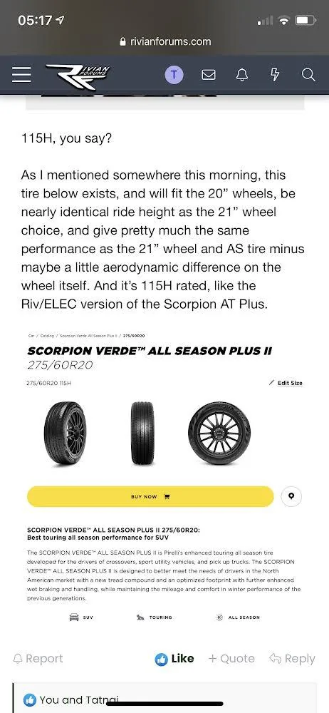

this one:
That's not the same size, but would probably work.
There are 10 all-season tires listed in the correct size.
https://www.tirerack.com/tires/Tire...&rearRatio=65&rearDiameter=20&performance=ALL
Looking at it, most are E load range, so the weight rating isn't an issue. Most do not have the same speed rating as the stock tire, but I don't think you need 130 mph rated tires (at least I don't). They are just going to be heavier overall, so that is most likely going to hurt your range more than the compound and tread pattern might improve it.
