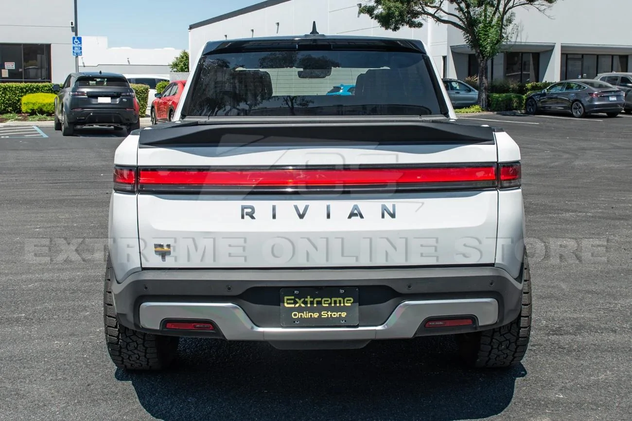

I’ve had my R1T for about a year now. I really like the truck but am disappointed that the plastic trim at the top of the tailgate is so susceptible to nicks and scratches. Because the R1T bed is short, I often end up carrying items like lumber perched on this trim and then pull them out over this trim. For a truck this is a common area for abuse and it is highly visible outside the truck. So why did Rivian use ordinary plastic here? I know there are pads sold for bikes and such, but I don’t want something I have to prethink to employ. I also know there are bed liner coatings but doing only this piece would look odd with the texture difference. I did a Google search and failed to find this really addressed. For those entrepreneurs out there, can you make a replacement or cover out of a more durable material? In fact, you could improve on it as I understand the stock trim has a tendency to come off on its own.
I had my light bar replaced this week (I bumped into a post and cracked it)... I learned that the top piece on the tailgate is considered a consumable one time use item. It's $190 by the way for a new one.
The ones that they are putting on now are much better. More rubberized, less soft plastic.
A 3rd party, carbon fiber part for that (and maybe a stronger/better tail light bar) would be pretty cool.

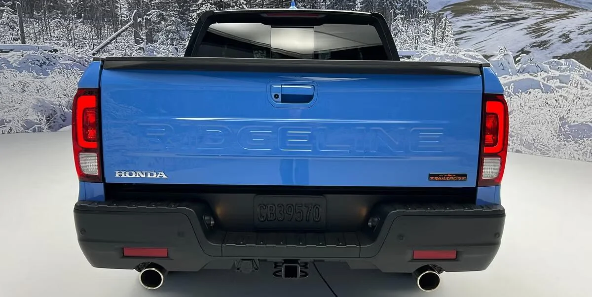

I'm not so worried about the tailgate trim getting marred - it's a truck. But it would be nice if there were a better way to get a purchase on the tailgate. The trim at the top is contoured to the same line as the tailgate itself. Looks nice and may be aerodynamic, but as others have said, it doesn't give you anything to grab onto.
My Ridgelines had a "spoiler" as well, but not as pronounced as those pictured. It was easy to lift the tailgate:

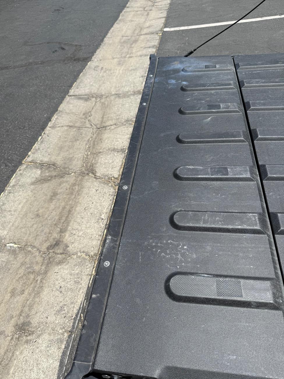

I haven’t seen this mentioned.
There are four torx bolts under the tailgate plastic that can be used to drill/tap through the trim and lock the plastic in place. I’m away from the truck at the moment but I’ll edit this post later. It’s a casual easy fix for a flawed design.

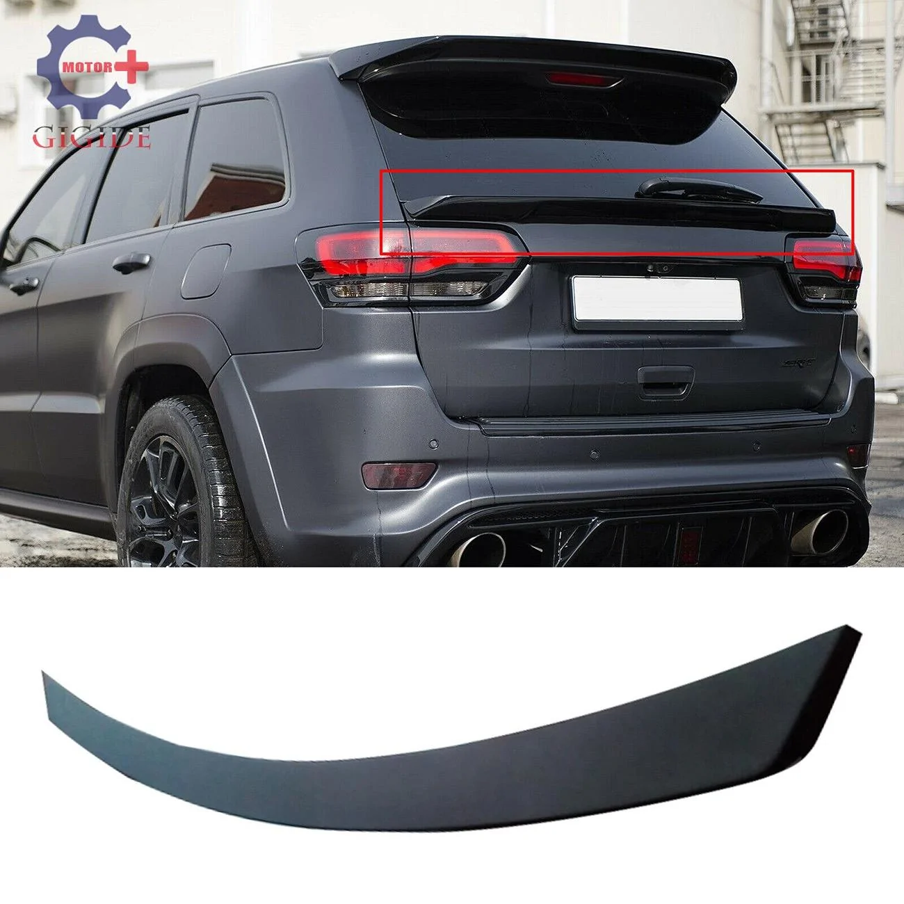

Not a fan of it when you see it from the sides or rear. It looks like the tacky spoilers some add to the rear of a Grand Cherokee.
I actually saw one in person. I sold a set of wheels to a gentlemen who had one of those spoiler / tailgate caps on his R1T. I thought it looked pretty good in person, but the fit and finish was was not that great. If I remember correctly, he had to make a few modifications for it to hold on securely to the back of the tailgate.

There are four torx bolts under the tailgate lip that can be threaded through to secure it better. Works well enough, and you don’t need any extra parts to do it.
Are you saying those bolts are already there, just under the plastic lip? All I'd need to do is unscrew them and screw back through the plastic? No tapping the metal?
