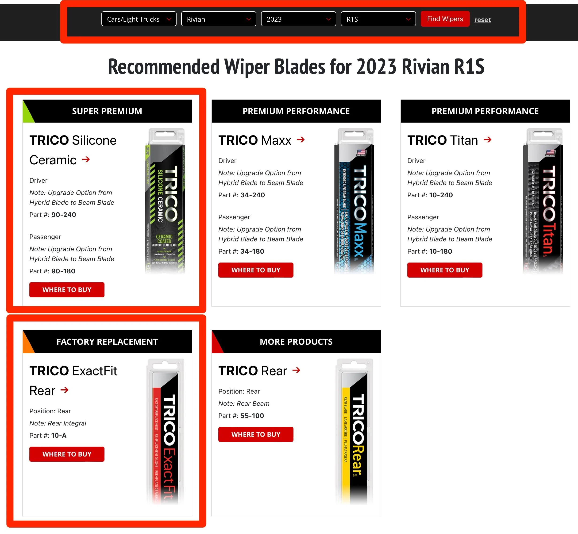

As for the wipers - agreed - the stock ones also suck. Another RMR FB group recommendation - I switched out to Trico Silicone ceramic blades (replaced all 3). They definitely seem to work better.
https://www.tricoproducts.com/products/super-premium-performance-wiper-blades/trico-silicone-ceramic?origin_product=product&part_product=90-140&body=&model=&skus=90-140,90-150,90-160,90-170,90-180,90-190,90-200,90-210,90-220,90-240,90-251,90-260,90-280,90-281,90-290,90-291
Fortunately yesterday's ice storm is pretty rare for here.
Which is the correct size replacement wiper blade?
They have a vehicle selector on their site. Just put in the R1. This is for my R1S. Then click on 'where to buy' - I got them at a local O'Reilly's. The rear doesn't seem a big change (and was harder to switch) - but the fronts were well worth it.

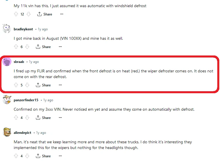

Where does it say that if you turn on rear defroster it also warms the wipers?
I don't think it's in the manual, and that might even be incorrect.
I was reading about it on Reddit and one owner used his FLIR and said the wiper area heater is on with front defrost (double press defrost icon till it turns from blue to red), not the rear defroster.
