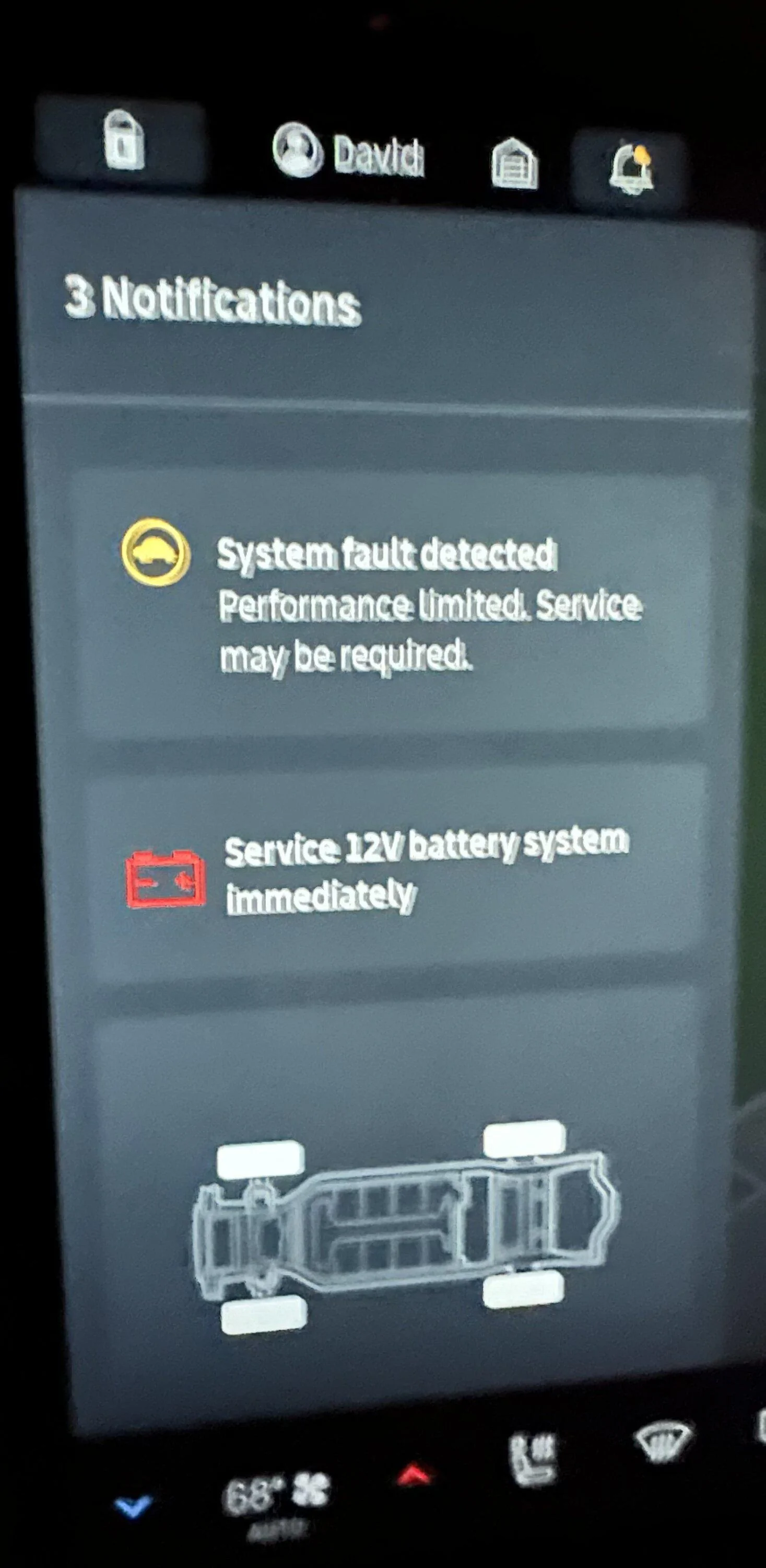

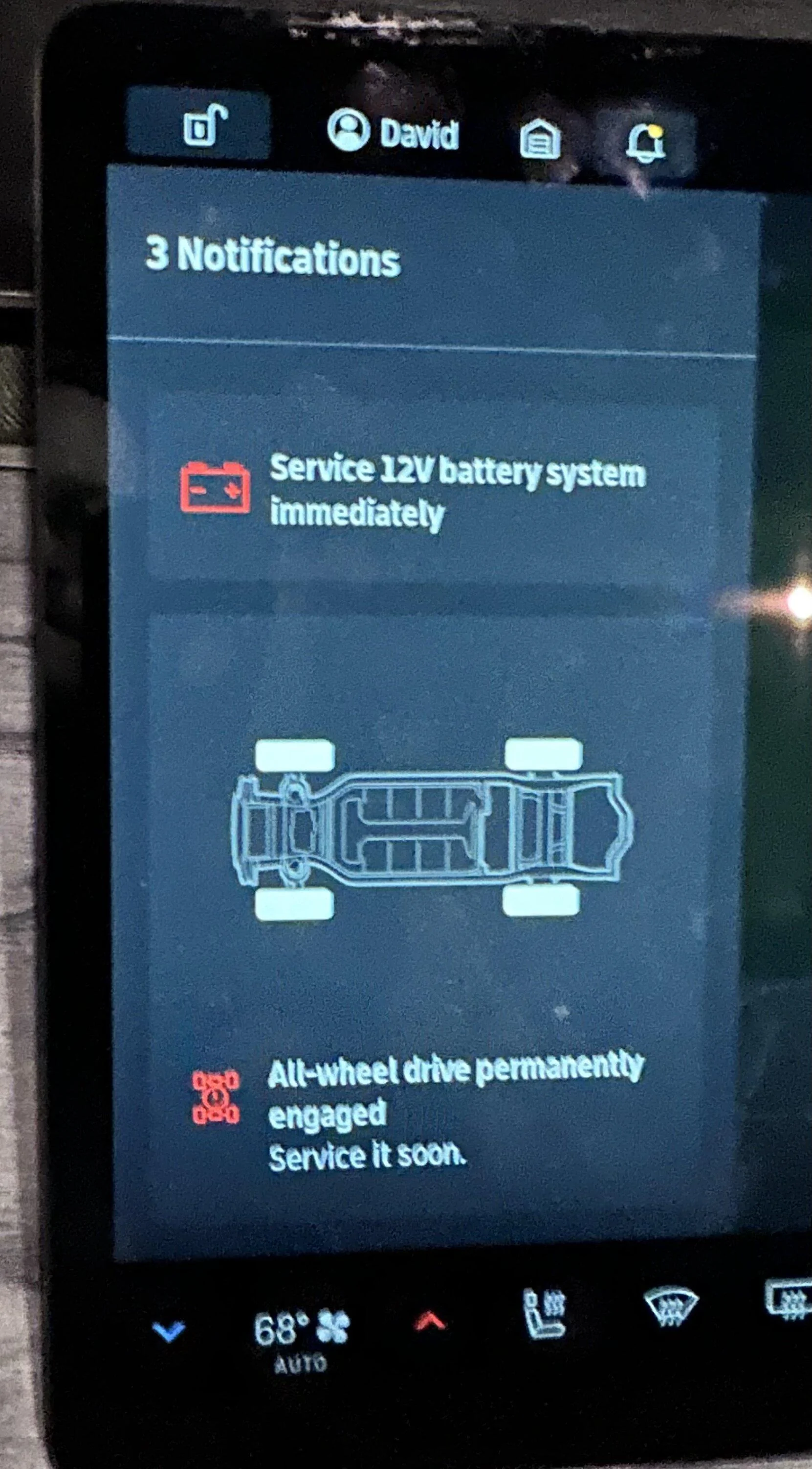

Yes, our new R1T had the same 3 messages which I’ll attach for others to see. We returned back to the house since we hadn’t gotten far, let the car sleep for over 30min. When we had come back the messages were gone. Support line did not want to do another hard reboot since we had done one earlier in the day for Driver+ unavailable warning.
Rivian R1T R1S Service 12V System Immediately error message 0AD3955D-63C3-417D-8564-75281C71209E
Rivian R1T R1S Service 12V System Immediately error message D1E4CBE3-656D-4BB5-AAF8-BAB22B343769

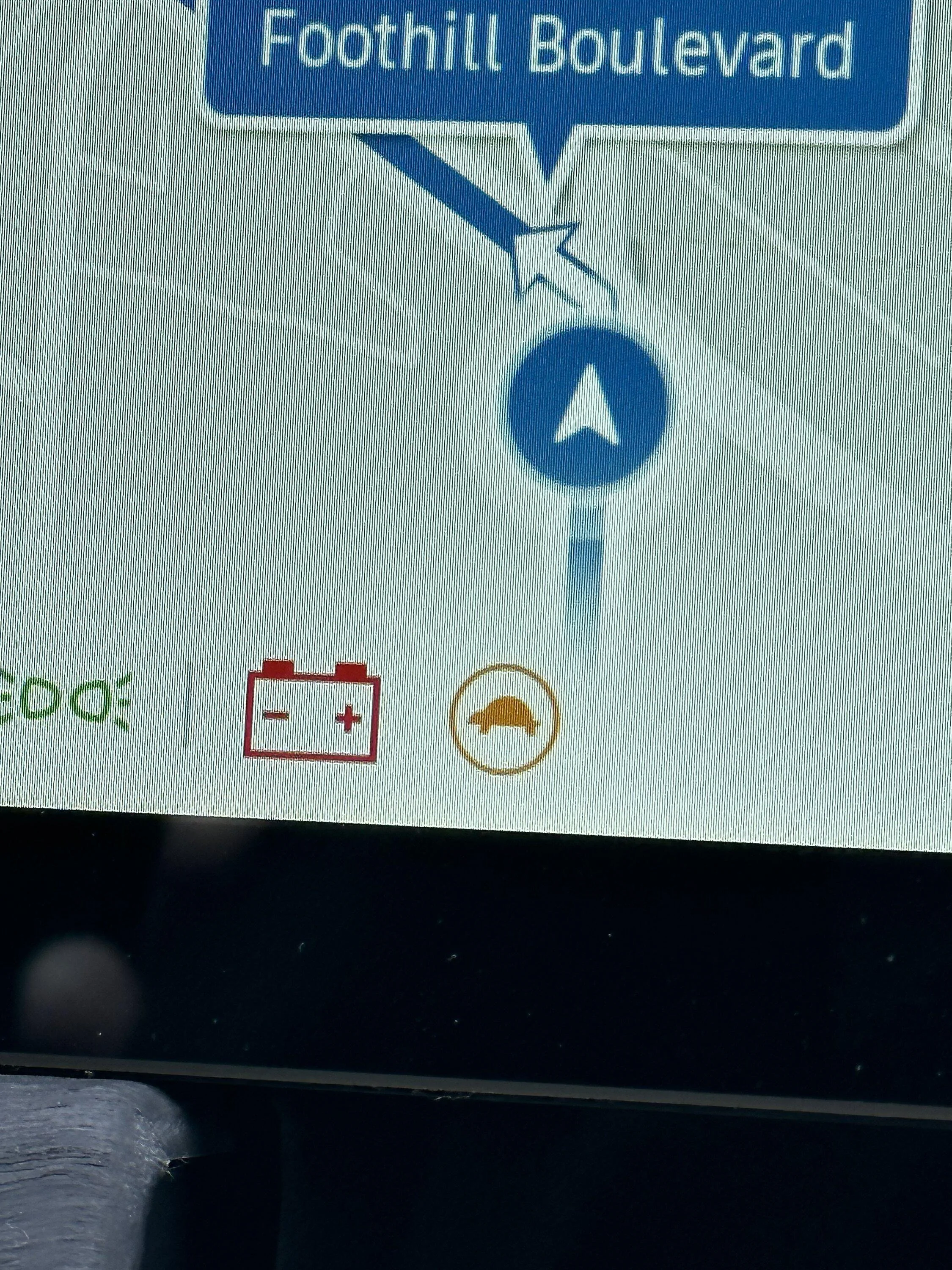

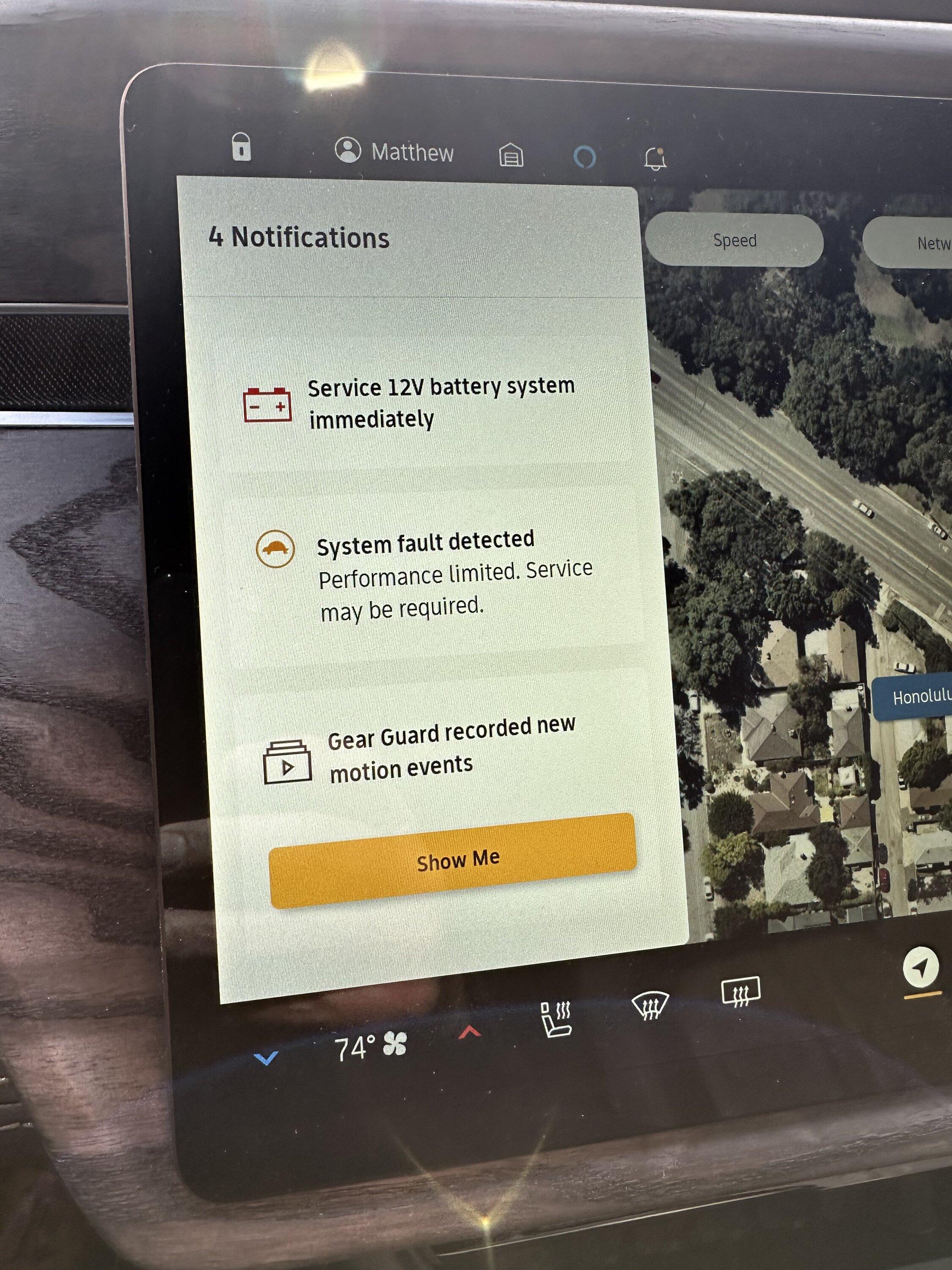

This happened to me today too. About two minutes after leaving my house for meeting.
Put in a service ticket, then called service. They said to reset it. Hold left steering wheel button left and hazards until reboot.
It went away. I drove about 25 miles since and no errors.
This has me concerned for our first family road trip for Thanksgiving. 61 mph on the highway doesn’t sound safe.
Rivian R1T R1S Service 12V System Immediately error message 681D5352-1A9A-43B4-B4FA-B5C5C30C58E5
Rivian R1T R1S Service 12V System Immediately error message 1559DB8B-7B07-46AD-B0F3-D020AD9B2281
