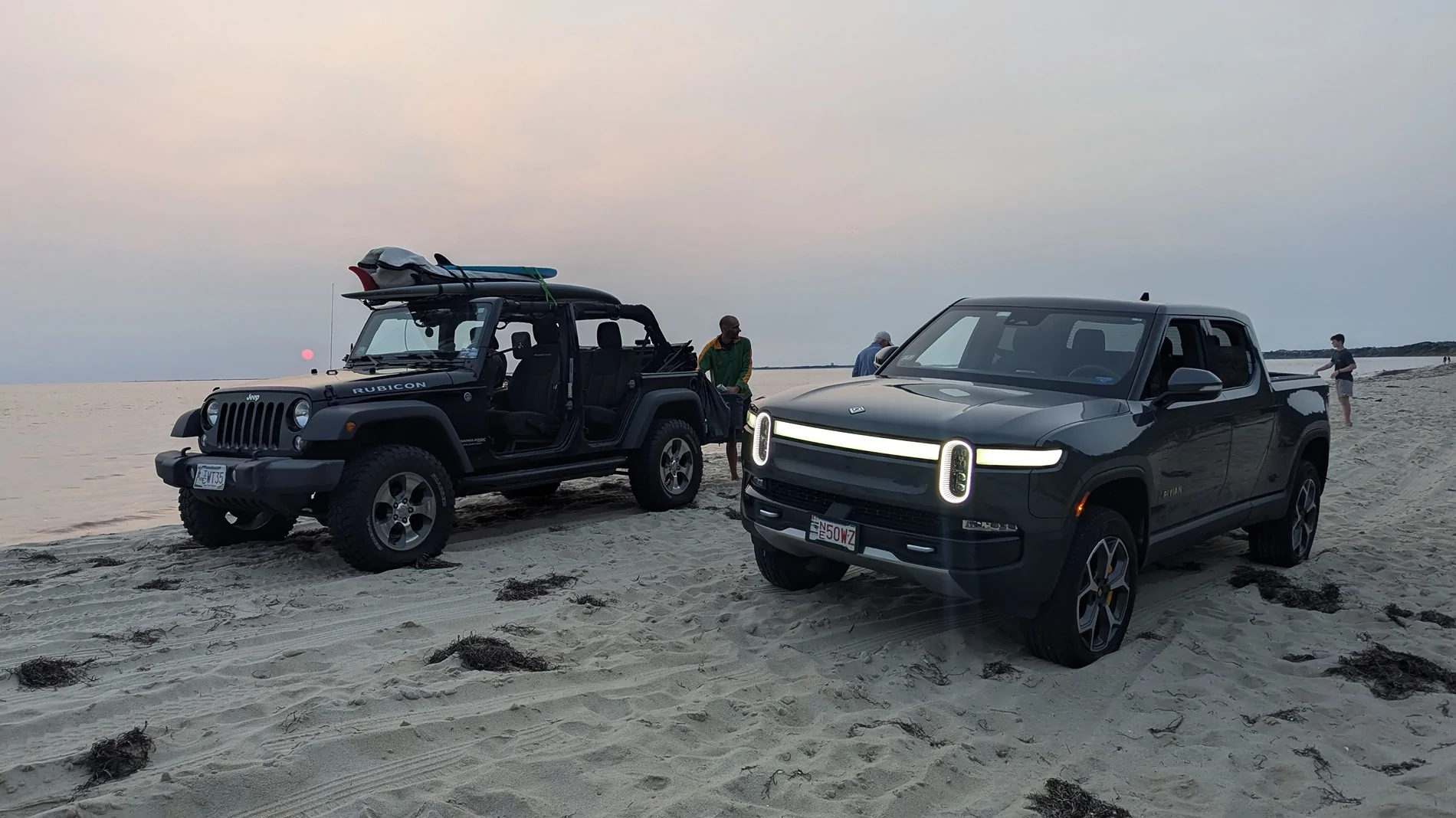

I'm a Beach Ranger on Nantucket with essentially the same sand as Cape Cod (same glacier :)) and we request 12-15. Sadly I drive an F250 all day but when I take my R1T Dual w/21" wheels out I air down to 20. I have pulled 2 R1S's out, one at 30 and one at 40. The Rivian off-road recommendation is not for soft sand.

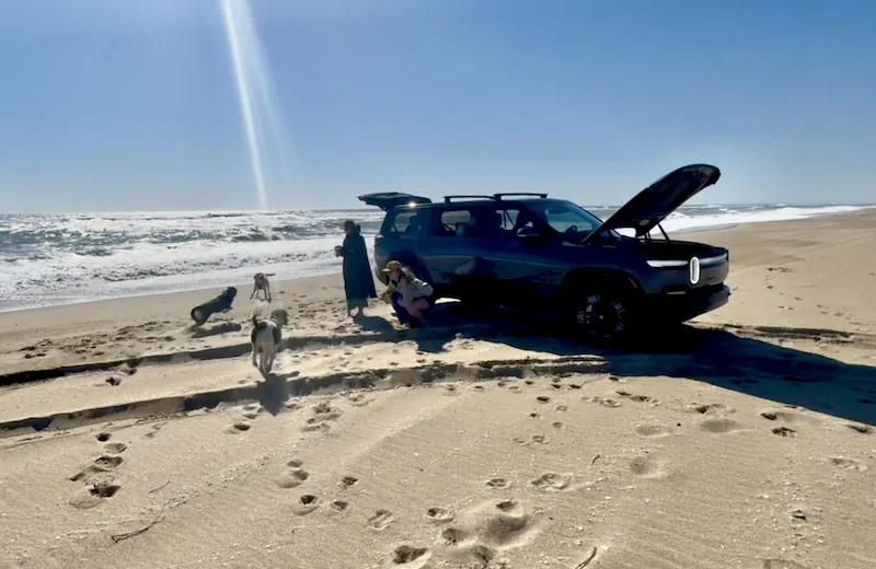

I've driven on the Outer Banks beaches several times aired down to Rivian's recommended ~30psi (on 20" AT tires) without an issue... until yesterday. Got bogged down in soft sand, frame almost sitting on the sand (even at highest air suspension). Aired down further to ~20PSI and with a litle shoveling was able to get free. I'm a bit worried staying below their recommended 30PSI due to the risk of tires "debeading" in such a heavy vehicle, but maybe Rivian is just being ultra-cautious and I'm just paranoid.
