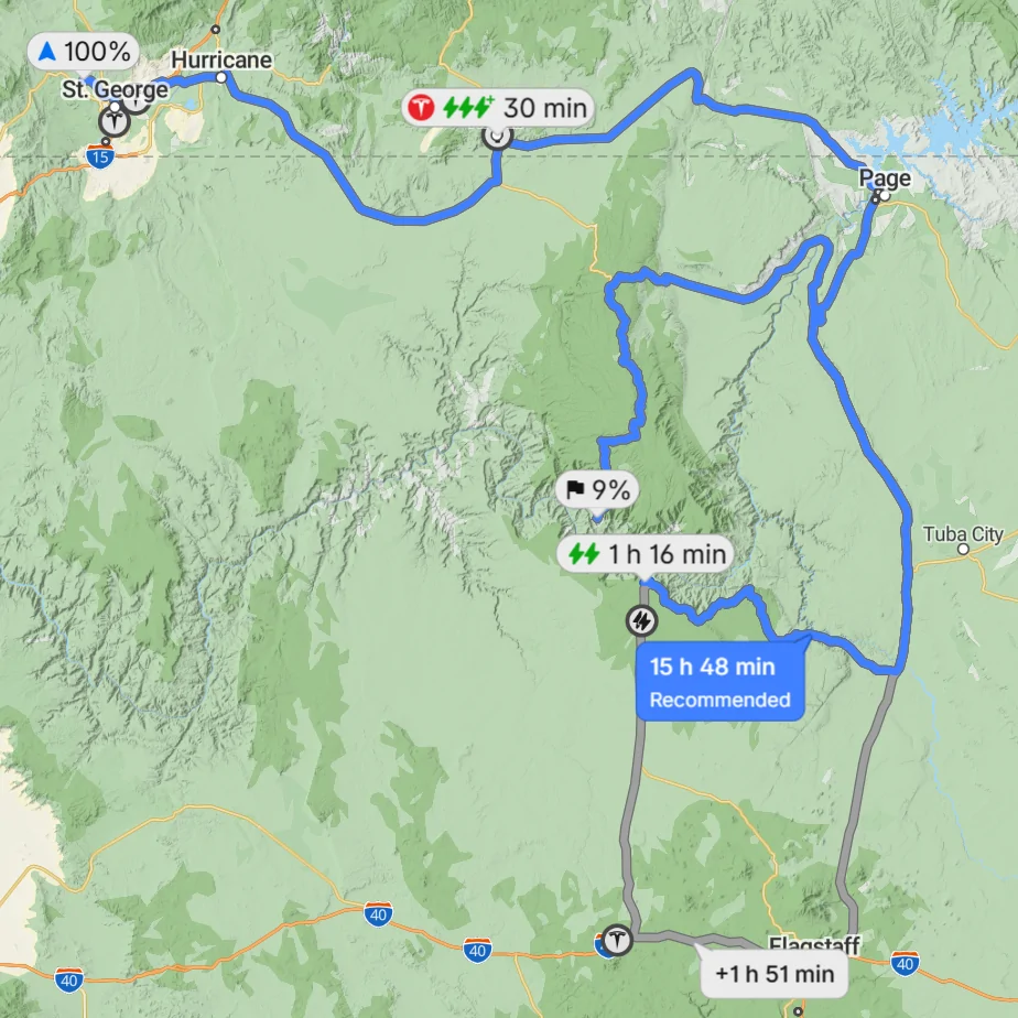

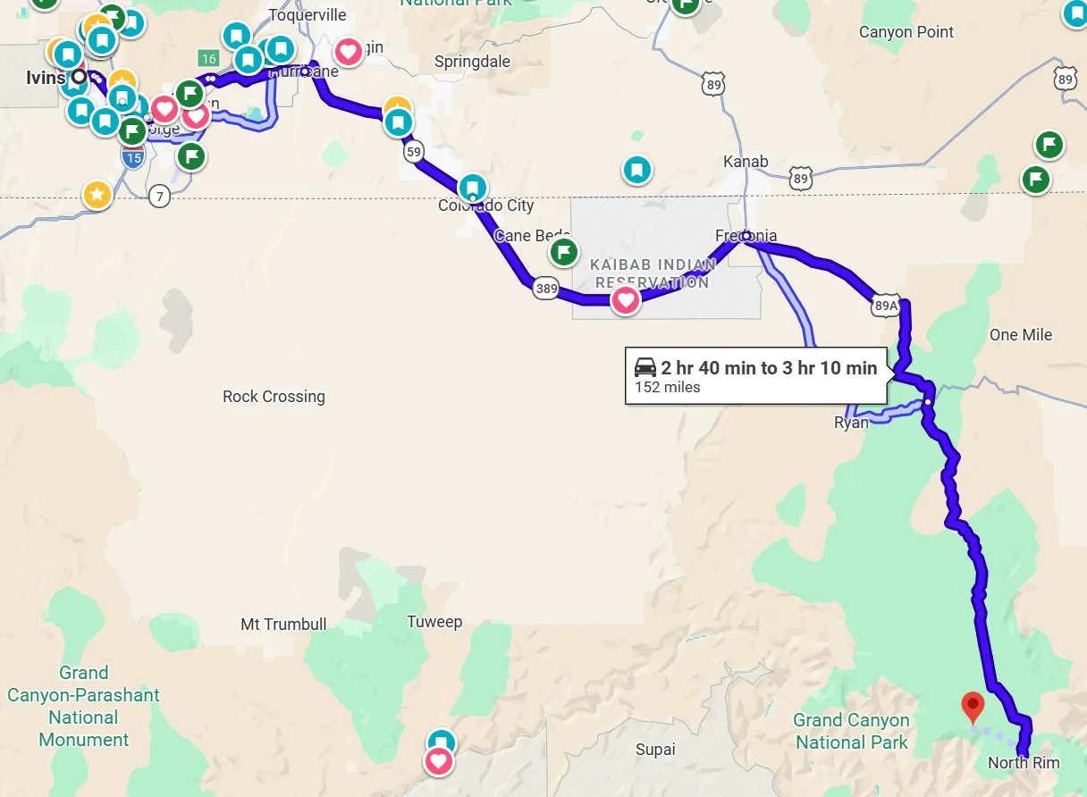

I'm trying to use the Rivian trip planner in the app to figure out whether a trip is feasible with my Gen 2 R1S. Before you dismiss my concerns, note that this trip will include 160 miles off road total (out and back), and between the start and end point there's realistically one charging option. The trip is 152 miles one way, 305 miles total (which is beyond my 290 mile range), and should take ~6 hours according to Google maps (3 hours out and 3 hours back). However, both the Rivian planner and ABRP (with a starting charge of 100%) calculate a trip of about 15 hours that's routed through Arizona to the south rim of the Grand Canyon for some reason.
Here's the Google Maps route, which is reasonable, though doesn't include a charging stop i Kanab of course.

Compare this with the ABRP plan (which is similar to the Rivian plan). I just assumed a 10% arrival charge. There's a supercharger in Kanab - even though that's a bit off my route I'd normally plan to use. it. But ABRP has other ideas...
Rivian R1T R1S Rivian Trip Planner planning problems 1787531448068-o7
The Rivian trip planner makes a similar 'guess'. The point marked at 9% is the intended destination, and even with the slight detour to Kanab (the 30 minute charge) I'm then taken to Page, then the south rim of the Grand Canyon, then, a loop back to the north rim destination. Given the failure of the route planners, I'm instead having to do the math to calculate a stop on in Kanab on the way out and back (Kanab supercharger to Point Sublime is 75 miles each way, so assuming charge to 80%+ (!230 miles) in Kanab I expect to be fine.
I've tried a bunch of different options for arrival state of charge, planning one way and round trip etc., and I can't get the Rivian planner to give me the simple option. Thoughts from my fellow road trippers would be appreciated, as this is the kind of trip I do most often. Is there a trick I'm missing here? My theory is that the planners won't allow me to spend enough time at the supercharger in Kanab to get me the additional range.

Update - I've been able to get ABRP to figure out the optimal route (via the website, but not via the app ;(, but the Rivian app with the same trip setup is still routing me into Arizona via Page and ultimately a 1044 mile trip (a route that looks similar to the ABRP one above).
