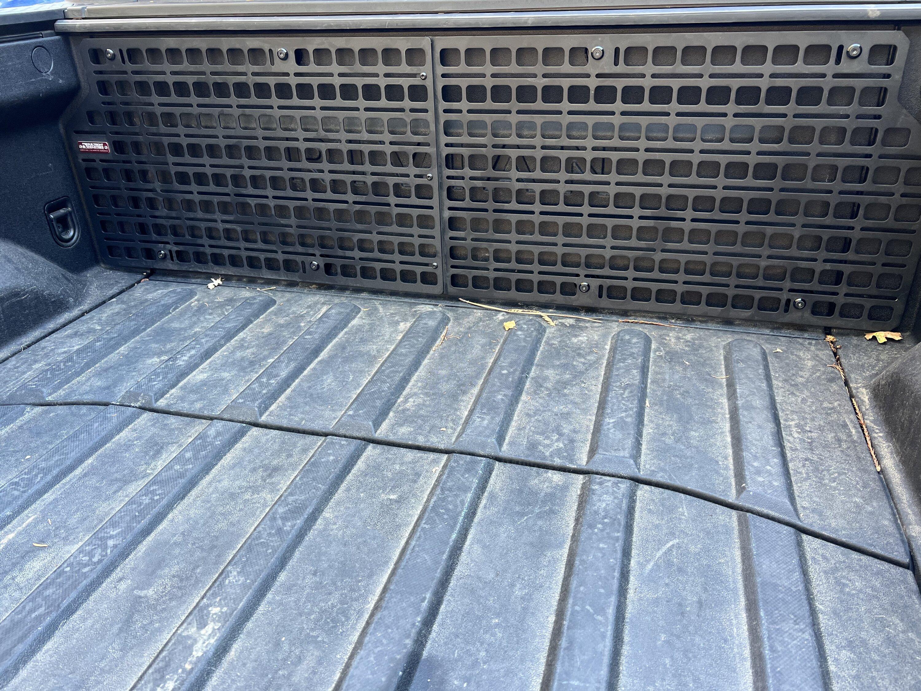

I just installed the Builtright Molly panels. The install instructions were clear and easy to follow. With the tonneau cover open there is a gap at the rear of the bed if you put anything taller than the tonneau. The panel lives nicely in this area. I’ll report back after I see how much I use it.

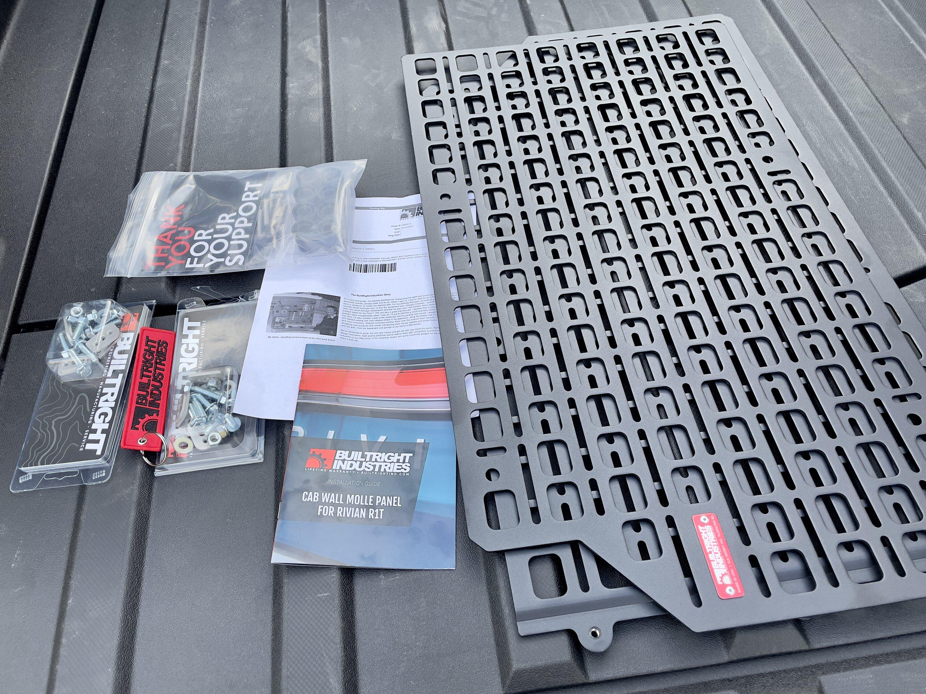

I installed mine over weekend. Very impressed with the quality of everything: parts, docs, shipping, etc. not inexpensive but you definitely get nice kit.
Went in easily (especially with the thoughtful retainer washers to keep all the bolts and spacers in place as you position everything.).
A couple cautions is on removing the plastic bolt covers/caps. One, they are like those cheap takeout food plastic container tops in that they fight you one side to the other. So you have to kind of work your way around carefully. The other is that there is a metal ring under there. It’s very easy to get under that. It’s literally like a mm deep. If you just jam a screwdriver under there you WILL get under the edge of that metal. It’s called out in instructions but we still got under the first one. So as per instructions, use something very small (and only go to right under the edge of the plastic.)
Getting those caps off (without scratching anything or getting under/bending the metal rings) was the only tedious bit. Other than that 10-15 min maybe.
I bought a couple packs of their molle nuts and mounted a couple rings. Also used them to mount a couple wheel chocks. Just be careful with positioning things like that (close to bolts/standoffs) so don’t bend…I will probably add some additional standoffs for that…and be careful with loads. I think docs say rated for 30lbs per panel. (Not really a factor for typical molle uses. If all you want is chocks/rings then the s-rail/aircraft track method is probably better.)
I plan on ordering a couple strap holders and probably a couple rotopax mounts.
Overall very happy and would buy from them again with confidence.

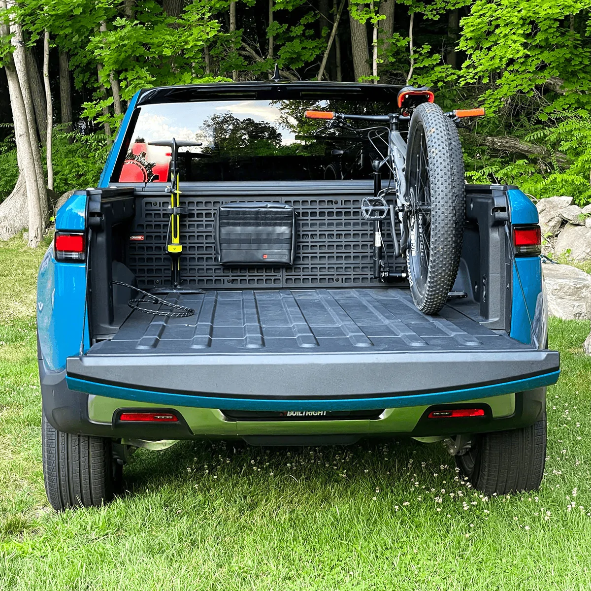

I really like the idea of this. Seems like a good solution for some of those off road essentials. If there was a bike mount that attached to it I would like it even more.
I think someone previously tracked it down online when it was posted about before.

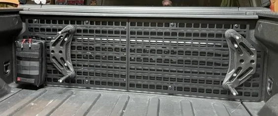

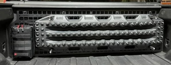

I installed this rack last week and agree with your positive assessment of the manufacturing quality, packaging, and documentation. For me it is the perfect spot to mount a couple of Maxtrax Extreme recovery boards to keep in the vehicle all winter. I even had enough room to add the small Builtright Molle pouch to hold a tow strap, ratchet straps, soft shackle, etc.
