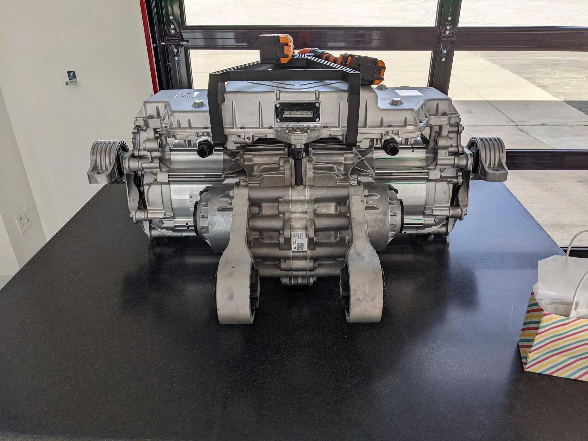

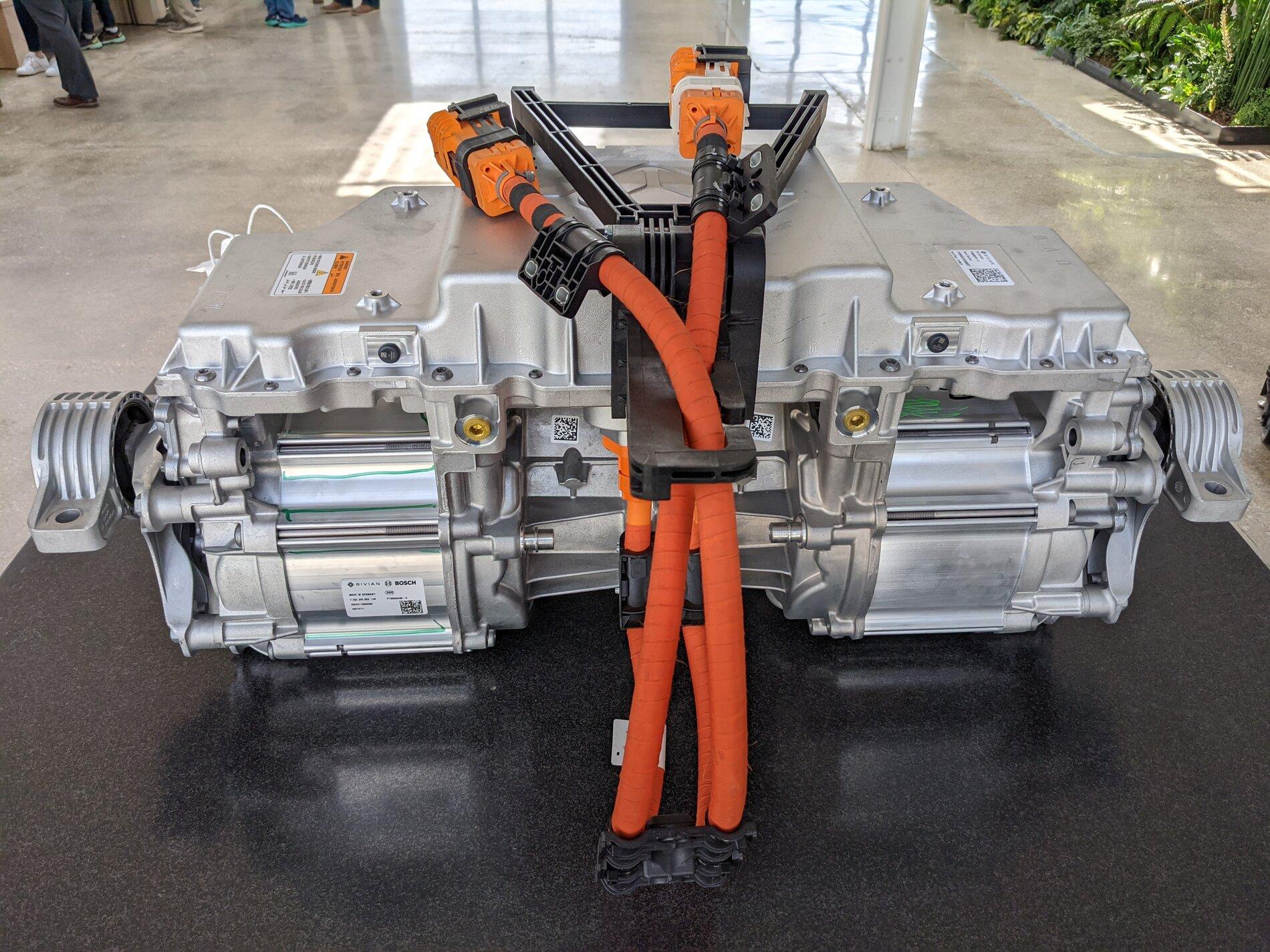

Those look like the motors, you can see the axles on each side.
That is the dual motor gearbox housing. The sealed housing contains the two motors that are made by Bosch, as well as the inverters that power the motors.
Richard Farquhar, VP Propulsion: "On each axle of the vehicle we have symmetrical electric drive unit assemblies. One driving assembly in the front, one at the rear. Each drive unit assembly has two electric motors – four total – independently connected to the driven wheel with a fixed-ratio single-speed gearbox."
So yes those are the motors…lol I’m a mechanic in a former life, I’ve changed my share of cv axles and half shafts…

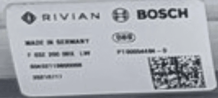

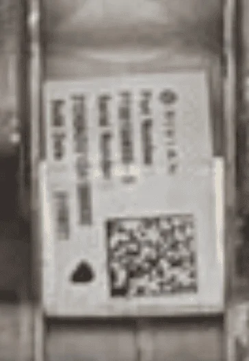

Sticker says "Made in Germany". We knew Bosch was making the electric motors. Not clear if the entire assembly is made in Germany, or the electric motors are bolted on to the housing in Normal. The second sticker on the transaxle says only Rivian, implying they are assembled in Normal?
