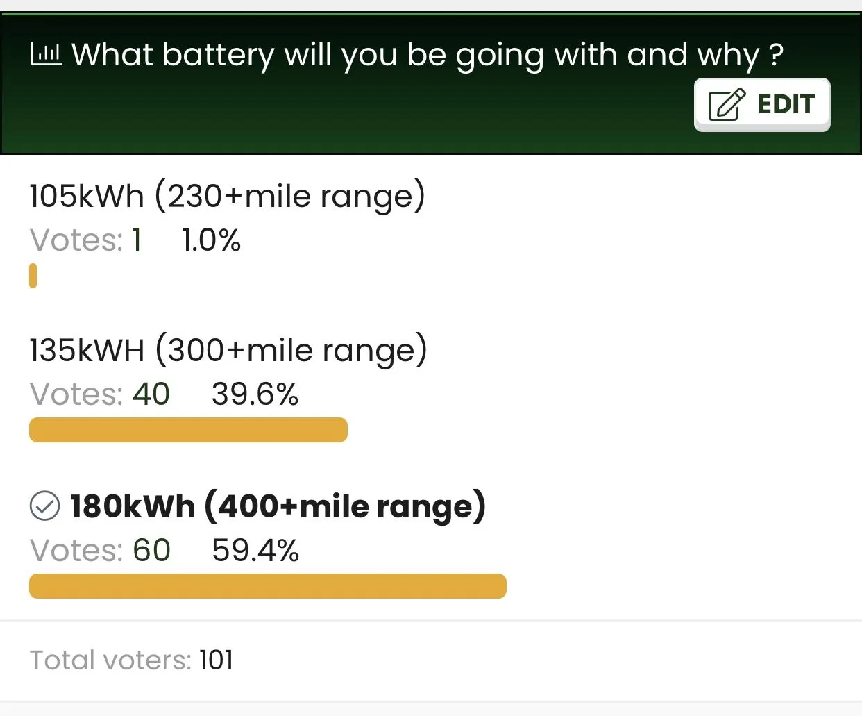

So we are a 40/60 split at the 100 person mark..Interesting I would have thought more ppl would be for the 135kWh pack due to the price ok 69k and assuming the 185kWh pack will likely be 8-12k more ! So after all of the Input I’ve extrapolated the data and used the Equation below :
30k x 1 x 0 =0 +100 -40 =60 and came to the conclusion almost everyone buying one of these is rich !
Oh and someone must have selected the 105kWh battery by accident.... right ?
