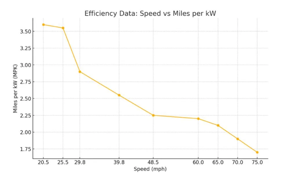

Sounds like you are focusing on the minutiae, you are describing an issue of “noise”. All of the efficiency data (MPK) reported here is subject to being “ballpark”.
From what I’ve seen, people smart enough to calculate basic math are in fact reducing their MPK values by ~0.05 MPK to get a corrected value…but I would argue that’s too far into the weeds given the variations due to elevation, Temperature and pressure (air density), road types, driving styles, unequal elevation (hills), vehicle weight, and so on.
Soon I will have test data for a new tire (Geolander CV 4S), look forward to you picking it apart, in the meantime here is MPK ranges for the OEM 20” Pirelli at @56 degrees Fahrenheit and air density of 100%. Note the data above 50 mph is older. Will get the same range of data for the CV 4S…haven’t seen very much test data for the 21” tires…
Rivian R1T R1S Ride comfort 20 vs 21 IMG_3519
