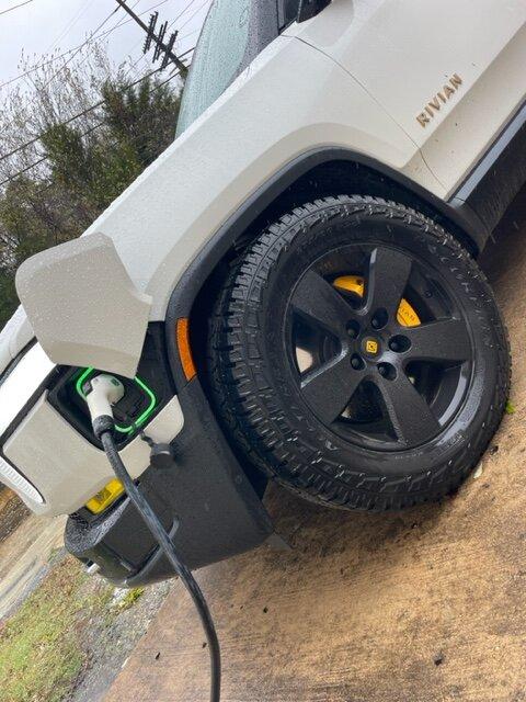

5600 miles on this setup, matched overall OD, just plain works...
