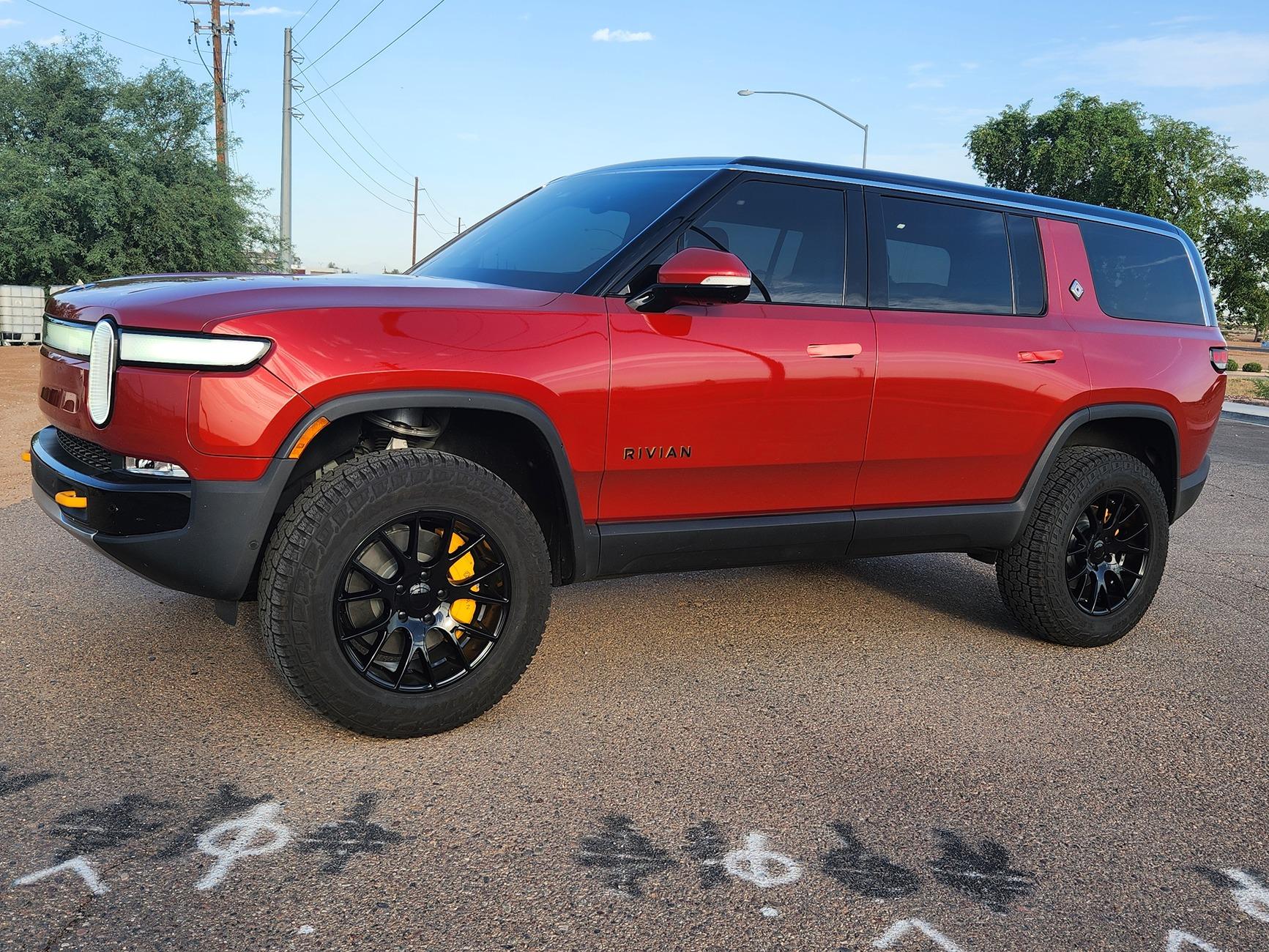

They will definitely rub with 275/65/20 in low. I got rid of them pretty quickly and went to the MSW Type 52 which has stock offset and no rub.
I have the Dodge Hellcat wheels on my wifes R1S at the moment. Swap to 21's for long road trips. They were purchased as a back up set for my R1T a long time ago. If I was buying today, I would absolutely purchase the MSW Type 52 Wheels, as they are Rivian specific. Correct offset, no hubcentric ring required and are very affordable.
Rivian R1T R1S RAM 2363 Wheels - Key Things to Know? 20240715_070244
