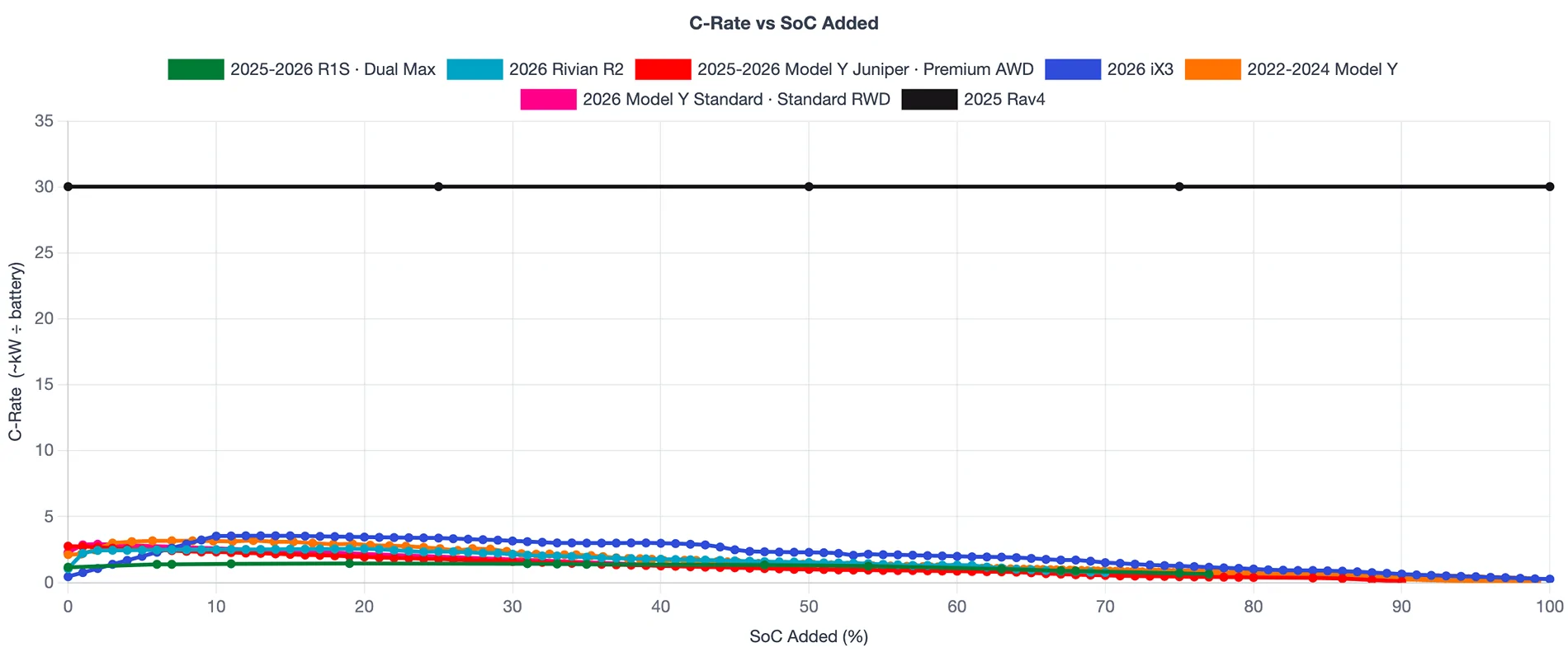

beats out its main competition which is Tesla.
I think it's actually the Toyota Rav4, Jeep Grand Cherokee, Toyota Land Cruiser, Subaru Forester, etc.
As a goof, here's a Rav4 in terms of "C-rate" vs various EVs.

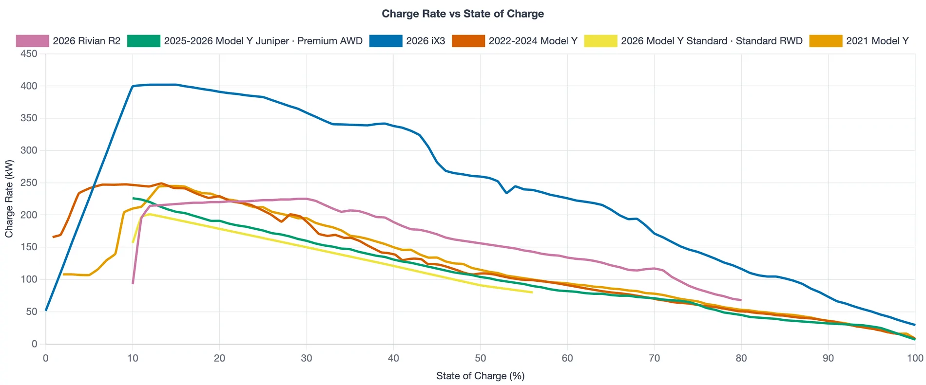

R2 looks like a marginal improvement over 5 year old EVs. IX3 is current gen and actually stands out.
Rivian R1T R1S R2 vs Tesla Charging Curve Comparison 1784586630083-v
https://evbench.pluginpath.com/?tab=chart&r=115,97,36,101,119,73&v=21&x=soc&y=chargeRate

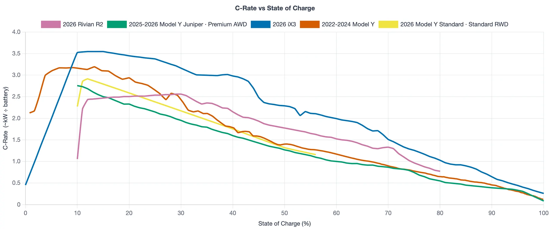

And if we look on a "technological" level (C-rate)...
Rivian R1T R1S R2 vs Tesla Charging Curve Comparison 1784586704559-hg
https://evbench.pluginpath.com/?tab=chart&r=115,97,36,101,119,73&v=21&x=soc&y=cRate

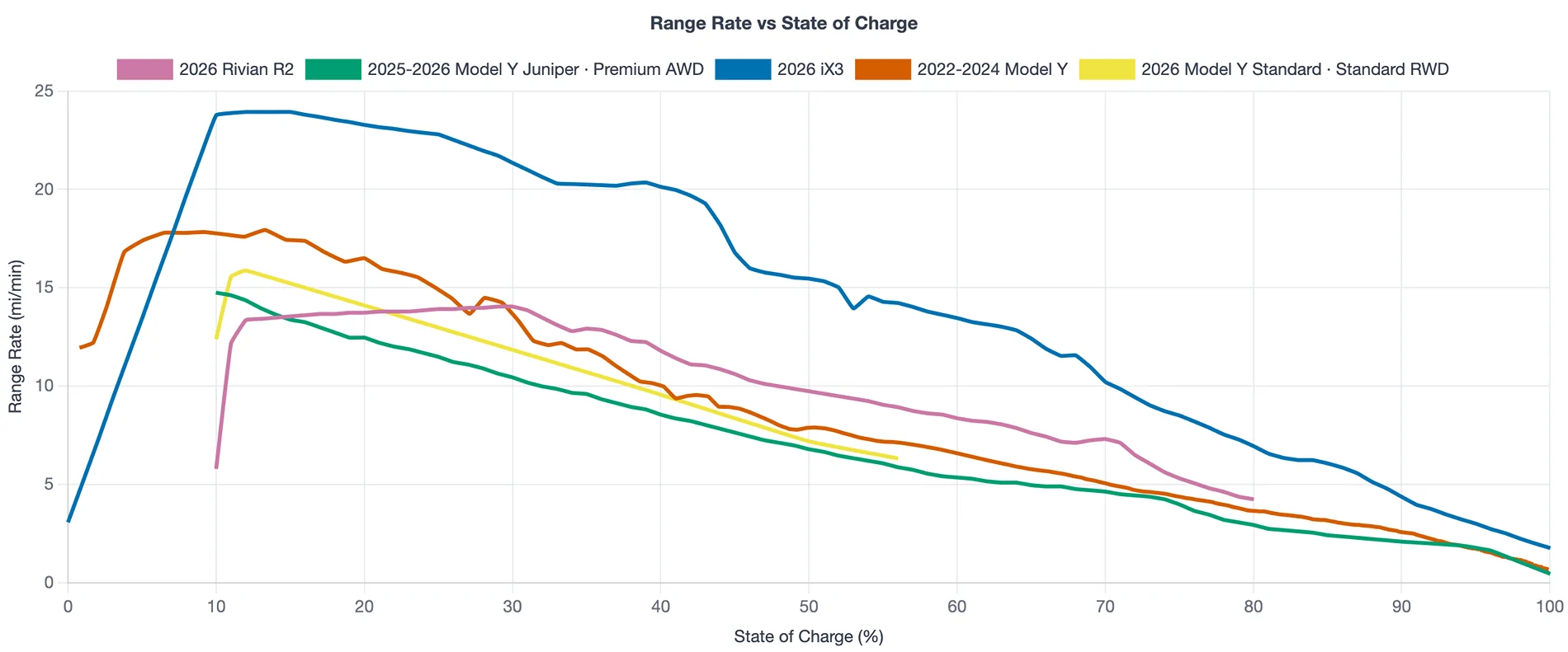

And finally, as a range-rate (miles/min) added, which is what a ddriver actually cares about:
Rivian R1T R1S R2 vs Tesla Charging Curve Comparison 1784586861549-r
https://evbench.pluginpath.com/?tab=chart&r=115,97,36,101,119,73&v=21&x=soc&y=rangeRate

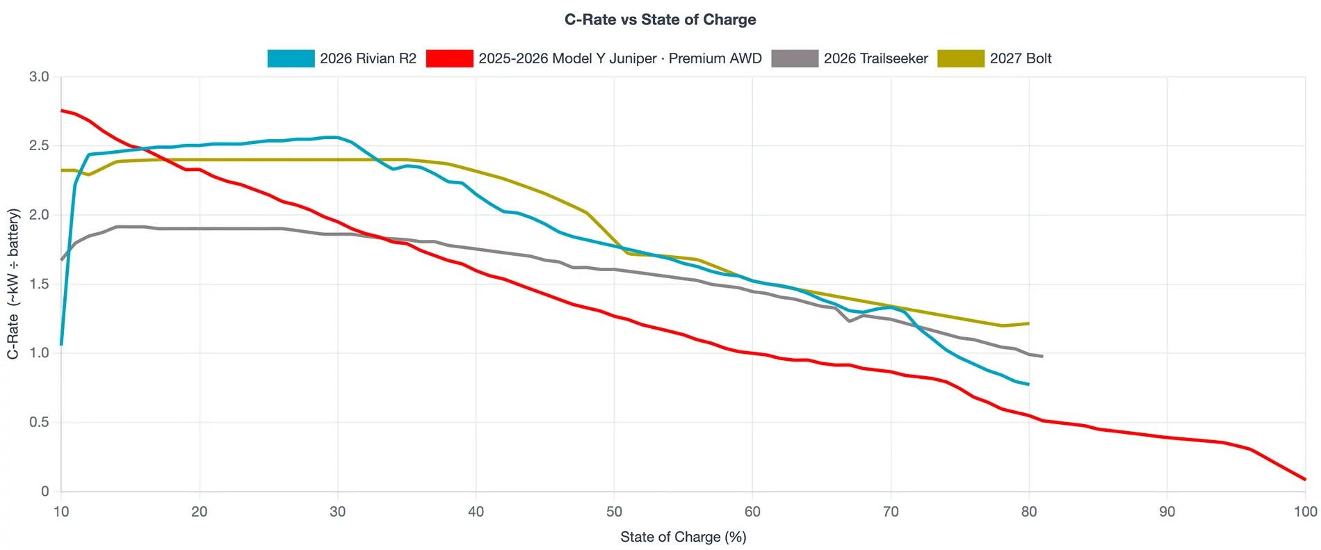

iX3 is $10,000 more once you build a similarly featured model to R2. Not really comparable IMO. R2 is comparable to Model Y or a 4Runner, like you said. I said in the original post no need to rehash 800v arguments either. R2 isn’t 800v so comparing it to 800v is silly. It’s most comparable to Model Y.
I never mentioned 800V. iX3 is MUCH better charging everywhere.
I know it's more expensive.
Here's R2 compared to cheaper competition on the battery technology front (C-rate / cell stress).
Rivian R1T R1S R2 vs Tesla Charging Curve Comparison 1784620345843-j0
The Chevy Bolt is a perfect match. The Trailseeker would probably be competitive if Toyota allowed higher charging currents.

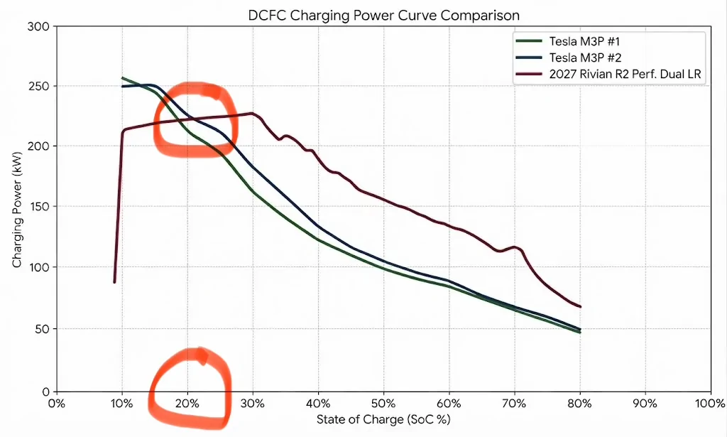

Funny, I don’t remember the R2 being a part of that road trip. Even funnier, R2 can charge at Tesla stations natively on NACS. Even funnier than that, no one is talking about some Hyundai vehicle. We are talking about R2 in an R2 forum. That’s crazy isn’t it?
Tesla holds peak for 20 seconds at 250 kW, it’s lower than the R2 almost immediately after plugging in. No one is splash and dashing to 20%. Your posts kill me man, do you read them before you hit post? It’s literally in the charge curve photo 😂 I’ve been driving Tesla’s for YEARS; I know how they work.
Rivian R1T R1S R2 vs Tesla Charging Curve Comparison IMG_3016
