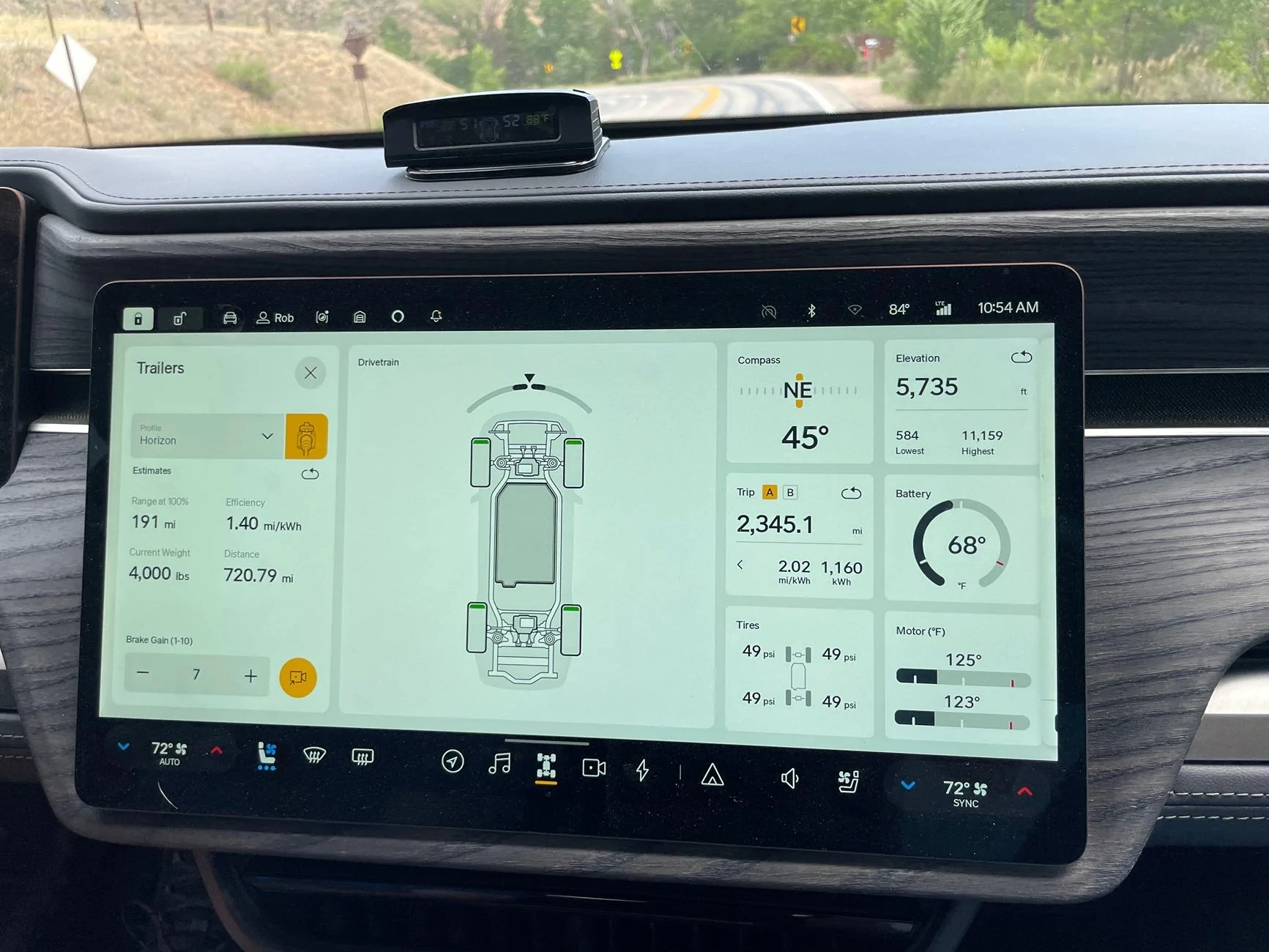

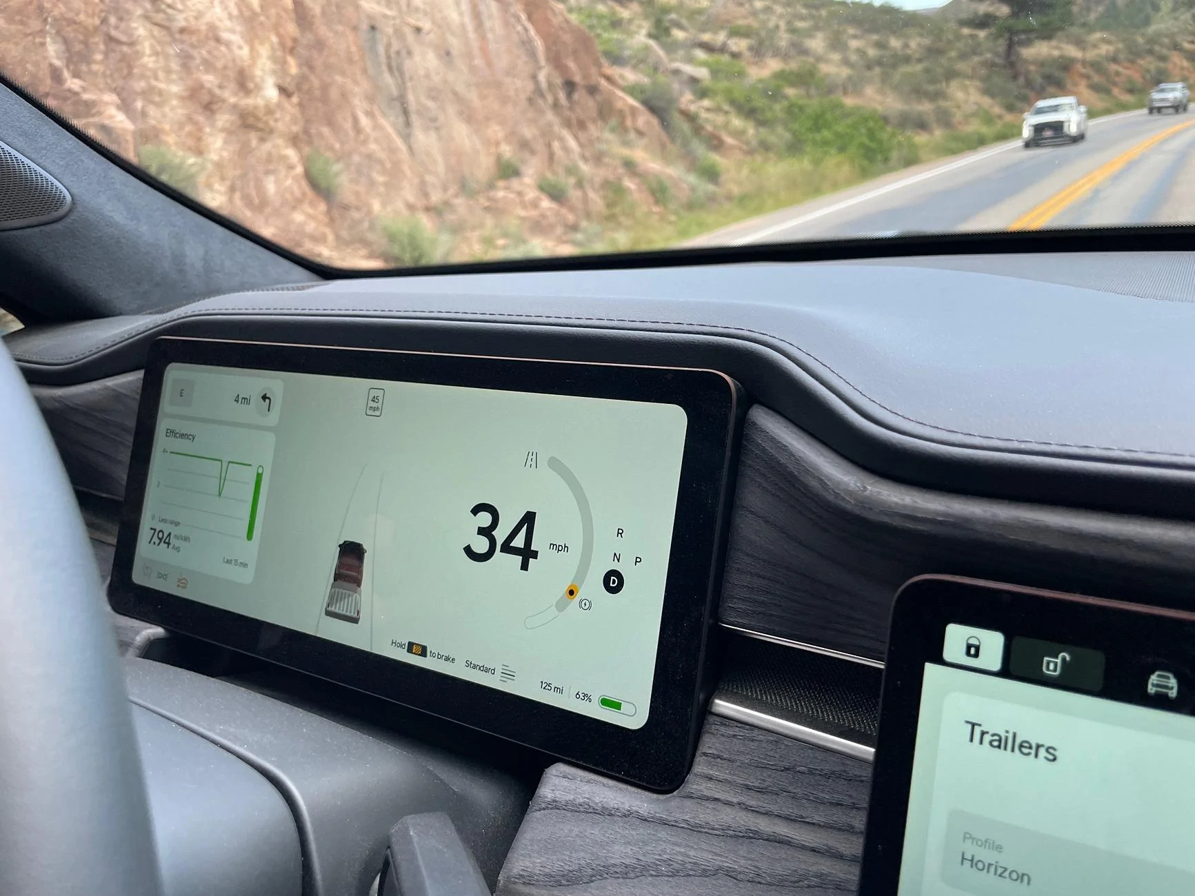

Here a couple of photos from Trip 2:
Rivian R1T R1S R1T Limited Regen Warning: What's normal? IMG_5489
Rivian R1T R1S R1T Limited Regen Warning: What's normal? IMG_5490

What I'm trying to understand is why Trip 1 allowed full regen and Trip 2 only allowed partial regen. I don't have photos from Trip 1. No need since truck worked as I expected. Photos from Trip 2 show limited regen avail on the Power Gauge and what I believe are favorable battery level and motor + battery temps. Any opinions on if those are non-favorable for regen?

Your second trip had an SoC of 63% in your photo, and already that means that your battery is only able to accept maybe half what it can at 30% SoC, so that may be the entire explanation. But we don't know what the Trip 1 SoC was. If your battery pack was cold-soaked on one trip but not the other, or if your battery pack was too hot on one trip but not the other, that could also be a factor.

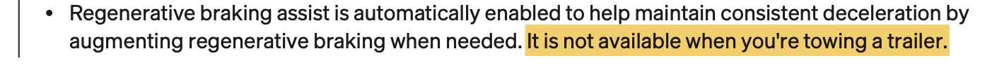

I confirmed Regenerative Brake Assist is disabled when towing.
From June 2025 Owner's Guide:
Rivian R1T R1S R1T Limited Regen Warning: What's normal? 1753561807976-1f
