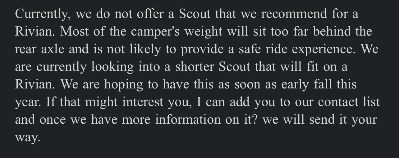

Has anyone installed a bed camper on their R1T? I see some early posts evaluating the idea, but haven’t found any posts on an actual installation. Wondering what it does on efficiency/range. Love the idea of a Kimbo or Loki.

Remember your manual actually states that this vehicle is not designed for a slide-in camper...
https://www.rivianforums.com/forum/threads/campluxe-cabover-for-rivian-r1t.12194/post-274621
Thanks, yes well aware of this. Anyone have specs or insight on what forces the in-bed tie downs are rated for?
At 1120lbs configured, & 300lbs of occupants, I have a 280lbs leeway before I hit payload max. I plan to stay 50lbs less than max, but will also seek higher load index tires, take the efficiency hit, and enjoy the additional peace of mind.
