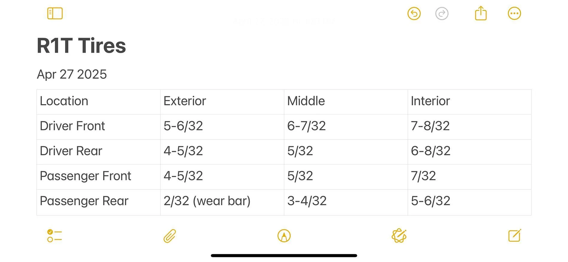

don’t think this is normal, right? Gen 1 QM.
Rotated every 4-5k miles, last one as recently as Feb 2025
3 alignments, last one Feb 2025.
Vehicle pulls to the right at highway speeds…. And the last time service center tech in drive-along said this is by design… to not let the vehicle run into oncoming traffic on the other side…
99% AP, standard ride height, mostly highway miles (130 mile 3x weekly commute to work).
Next appointment last week of May.
Higher wear on Passenger side tire, and worst wear on passenger rear tire.
Took multiple measurements each time just to make sure I’m not over or under reading the gauge and getting a good amount of data points.
This can’t be normal for as frequently as I rotate/balance them and having had 3 alignments done for the same reason.

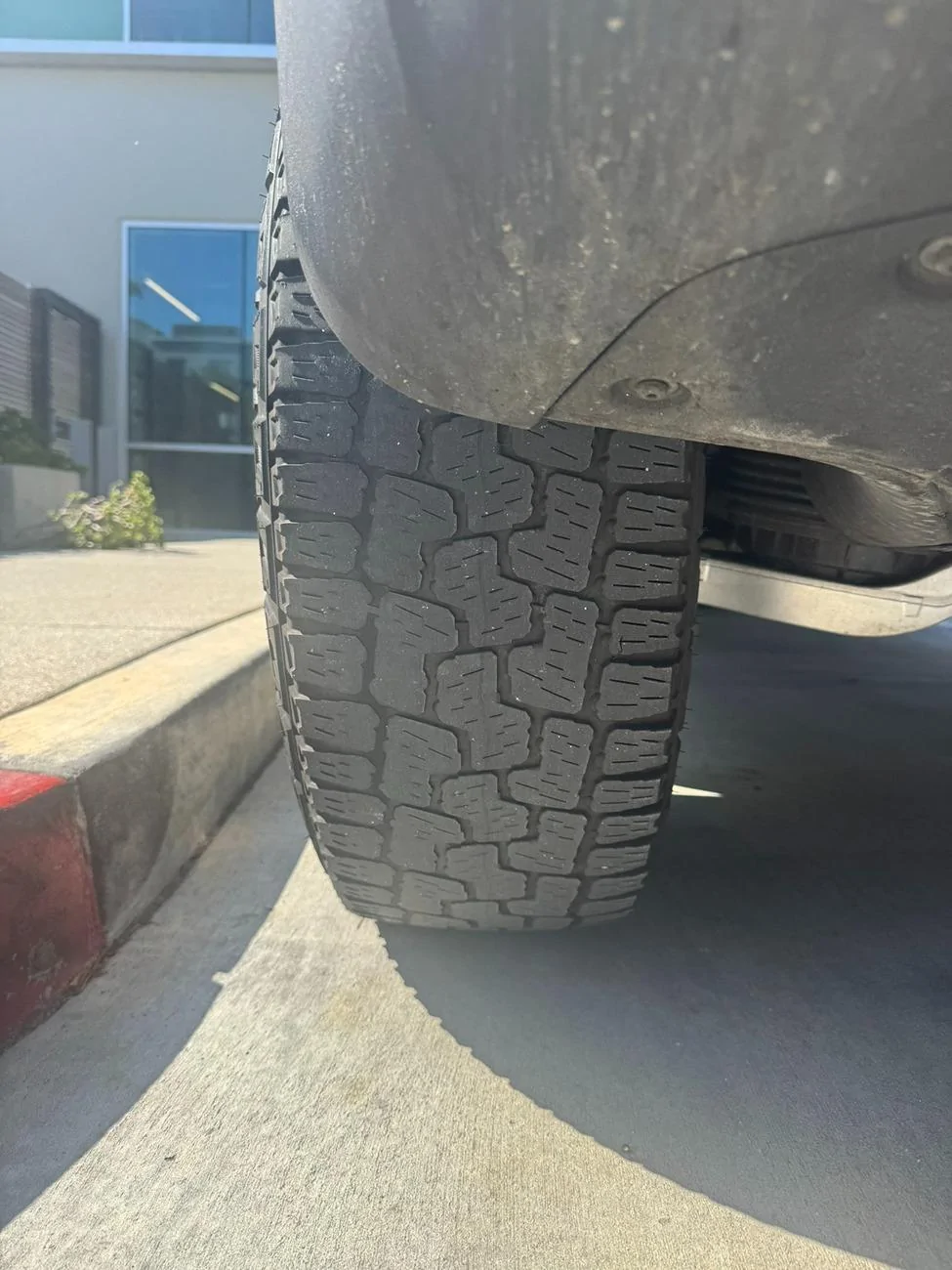

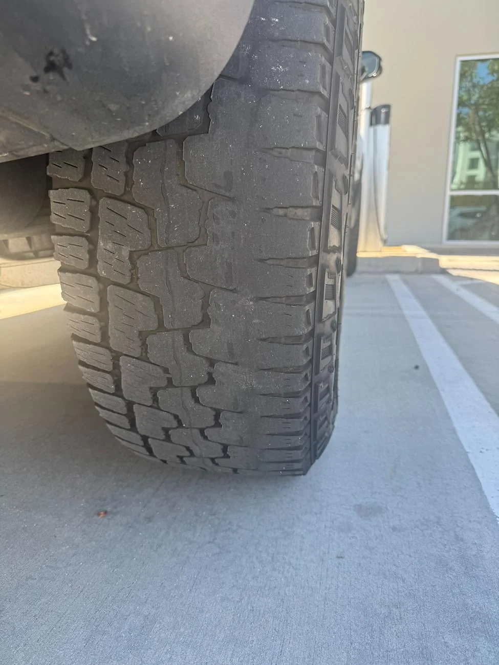

Experiencing similar.
Tires rotated once at 9k miles and expect them to rotate again at 15k mobile service appointment this month.
Alignment tested and adjusted at January service appointment at 12k miles. Clearly wear is MUCH worse on rear passenger side. Interested to see what they have to say about it.

They did another alignment and couldn’t figure out what was causing it. Picked up the truck Friday last week. As of yesterday morning, the truck is pulling to the right again. So that lasted about 3 days lol.
I have a QM. The pull to the right is very pronounced in conserve mode (front 2 motors only). The pull is not as noticeable when in ALL purpose (all 4 motors engaged). This might shed some light on why my passenger rear tire is burnt to the wear bar and all other tires have more tread. Front motors pulling the right. Rear motors driving straight. Putting more stress on the passenger rear tire
… maybe?
