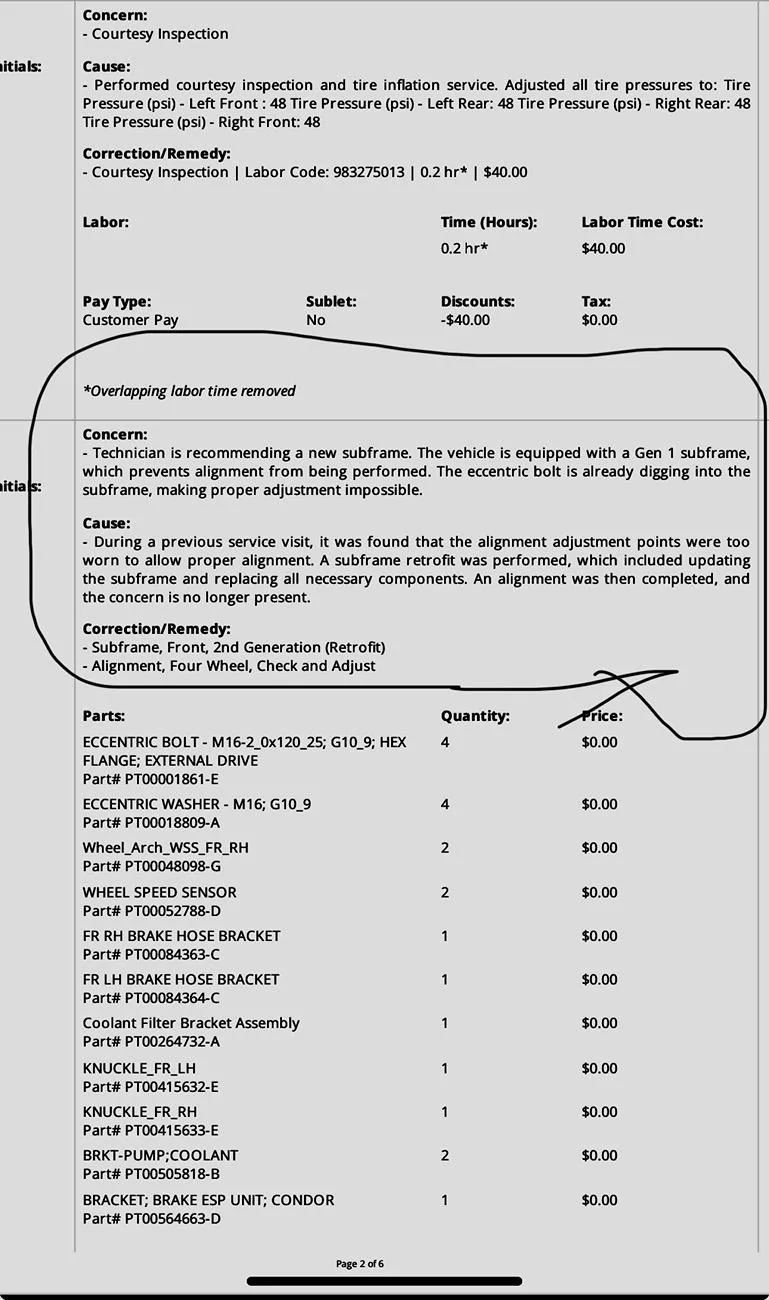

I’m having the same issue. Can you share a snippet of your service center work order please. VIN 24xxx, May 2023 build, QM. I have done 3 alignments in 14 months of ownership and the vehicle still pulls to the right.
Gimme some time to find it and I’ll post it
Ngkgb
Feb 7, 2022
80
816
767
United States
Here’s a picture of the invoice. I’ve circled the part that pertains to the alignment and subframe.
Rivian R1T R1S R1T Alingment IMG_0626
emoore
Nov 29, 2020
3,465
3,754
My gen 1 R1T had the same issue. It was the subframe and when they finally replaced it on the third alignment attempt it fixed it. Tracks almost perfect now.
