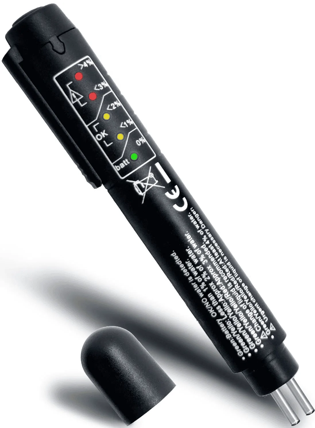

You can check brake fluid for moisture with a $10 "brake fluid tester" available at most auto parts stores and online.

How did you "check" it? Looking at it doesn't tell you the full story. Principal concern would be moisture absorption which would lower the boiling point and could lead to a soft pedal and corrosion inside the braking system.
I used an electronic brake fluid tester. Not sure how great they are though.
Edit: Yup something like shown above.
Those things are junk. I’ve tried them before and had results all over the place. Swapping brake fluid costs $20 and could potentially save you from a fatal accident. Skimping on it is utterly stupid in my opinion.
Even if it was perfectly accurate and reliable the fact is, brake fluid doesn’t mix through the brake system like engine coolant or oil. The brake fluid that sits in the reservoir can absorb water at a different rate to the fluid that’s in the caliper where it deals with heat from the brakes. Another reason why testing really doesn’t mean much. Buy a pressure bleeder for $60 and brake fluid for $20, easy to do and keeps your braking system performing optimally.
I don’t take chances when it comes to safety critical components.
