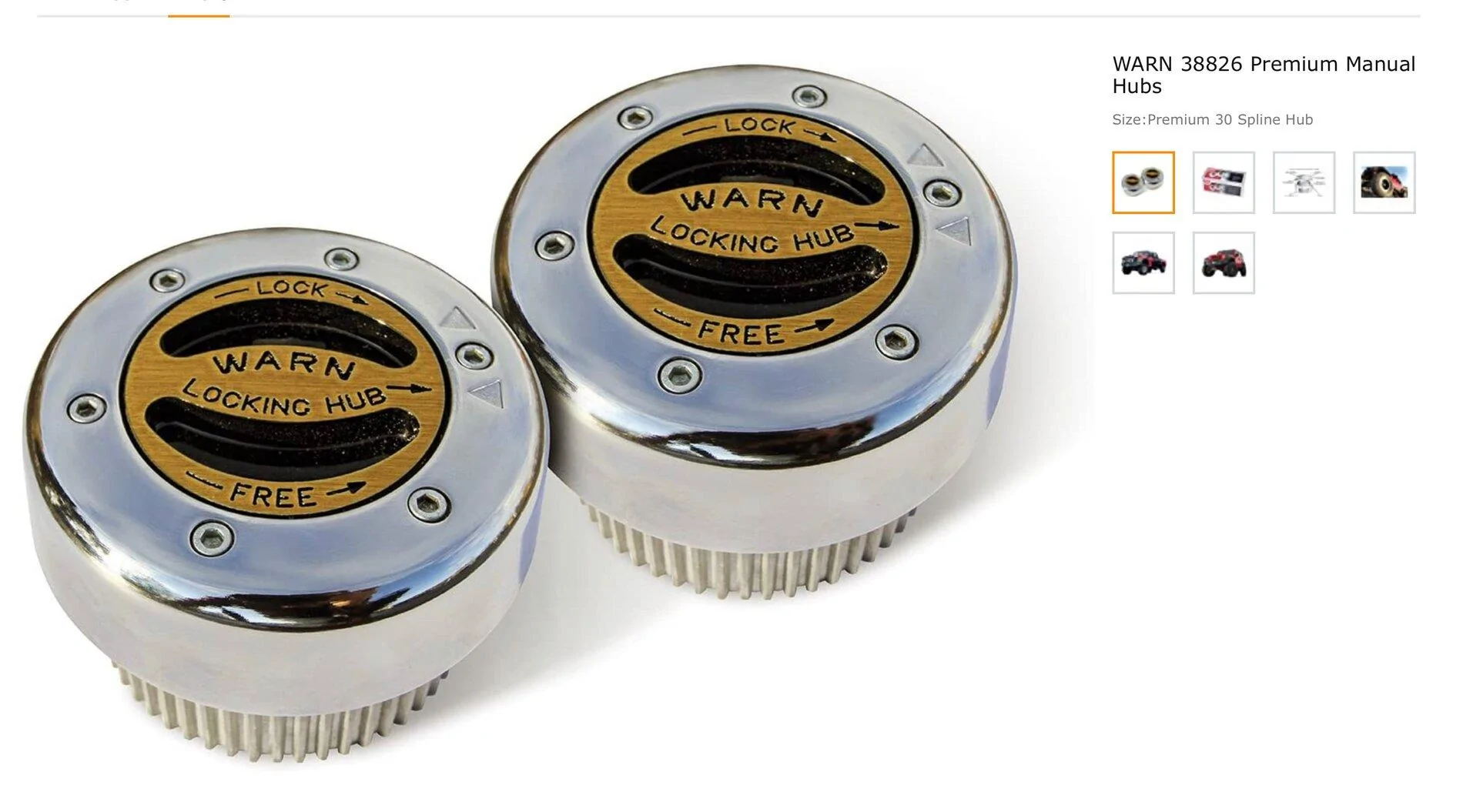

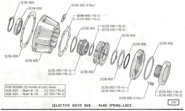

THIS IS A POSSIBLE SOLUTION — NOT THE ONLY SOLUTION — RIVIAN WOULD NEED TO SUPPORT IT IN PARTNERSHIP WITH AFTERMARKET SUPPLIER OR INCORPORATE IT IN ITS MANUFACTURING.
Problem Statement: EV motors and components are susceptible to damage when the EV is flat towed at the speed and distances normally experienced when towed behind an RV.
Proposed Solution: Manual Hub Locks will disconnect the drive wheel(s) from the entire line thereby inhibiting motion transfer to EV drive line components, including the EV motor.
Exemplars:
Manual Hub locks like the one shown operate at the wheel to set the configuration to “free wheel” or drive train “Hub”. Since flat tow already involves outside activities to attach the EV to the RV, the wheel configuration setting can easily be done at the same time.
Rivian R1T R1S R1S flat towing behind an RV? 1618347645627
One internal design that may likely be changed to suit Rivian EVs involves the drive line extending to the wheel hub housing to a termination point that allows its separation from the hub when selected. In the exemplar, the termination point is part #4049. The arrangement allows the wheel to free spin or be connected to the drive axle as the user selects.
Rivian R1T R1S R1S flat towing behind an RV? 1618347645671
The manufacturer currently offers the product in marine grade stainless steel, different appearance options, and different vehicle configurations.
A typical set of parts supporting 4 wheels purchased today on Amazon for the right vehicle costs less than $600 .

I did a chat yesterday with a CS rep Rivian about this subject as I too wanted a Rivian to be my toad. I was told under no circumstances could any Rivian be flat towed , I wish I had copied the response to provide you all their reasons why, direct connection to the motors and inverter damage are two that stuck In my mind. Being quite disappointed with this news I started searching other EV options for flat towing only to be further disappointed, it appears EVs do not lend themselves to flat towing for the same reasons Rivian has eluded to.
I have seen a number of complaints about the Inconsistencies of info coming from Rivian’s CS reps, until I see something in writing that clearly states Rivian vehicles can be flat towed I’m looking for a new Jeep, we’ll keep the R1S as my wife’s vehicle.
It’s disappointing that Rivian seems so focused on the problem and not a solution. When WWII Jeeps were purchased by civilians after the war, 4WD only drive was found to be a problem on paved roads as the engine and drive train were fixed to the wheel motion. (Somewhat similar problem?). Warm came up with a wheel hub disconnect that manually disconnected the drive line. Problem solved.
As you already know, you have to work outside to connect/disconnect the TOAD. How much of a problem would it be to walk around and set four wheels to “free” mode when flat towing and “locked” when disconnecting? Plus, the mechanical solution personally makes me more comfortable when flat towing. If Rivian would provide a few details of the drive line and wheel hub assemblies, perhaps an after market company could build it. That’s been done before.
You're miffed that Rivian isn't finding a solution for a niche issue, and using a WWII Jeep analogy; but in your analogy, Willis didn't develop the solution -- Warn did. The vehicle manufacturer didn't solve the problem, in your analogy -- the aftermarket vendor did.
So... Don't be miffed at Rivian. Go talk with the aftermarket and find someone where the "niche" is big enough for them to go after.
