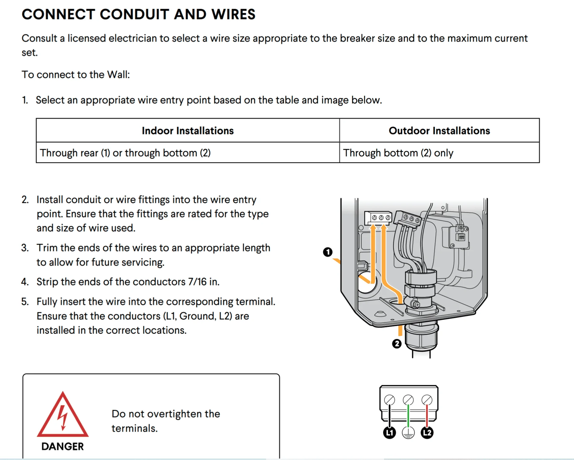

Make sure the electrician leaves some extra 6/3 in a loop when installing the 14-50R. You'll most likely need some to feed into the Rivian Wallbox. Probably want to consider the wire/outlet location as well.
Rivian R1T R1S Qmerit 12% fee??? 1634770600697
If it were me, I'd skip the 14-50 install completely and just have them pull the wire for the EVSE. The added expense of the box for the outlet and then having to decommission/cover/hide it later make it more of an inconvenience than any future benefit would justify. You can then go to 6/2 since the neutral will be unused anyway (you could do that with a 6-50 as well if you really wanted an outlet).
You could run wire in conduit from the outlet box to the EVSE at install time, but that adds complexity, expense and additional potential failure points where the wires are joined.

Great advice! Thanks ?
