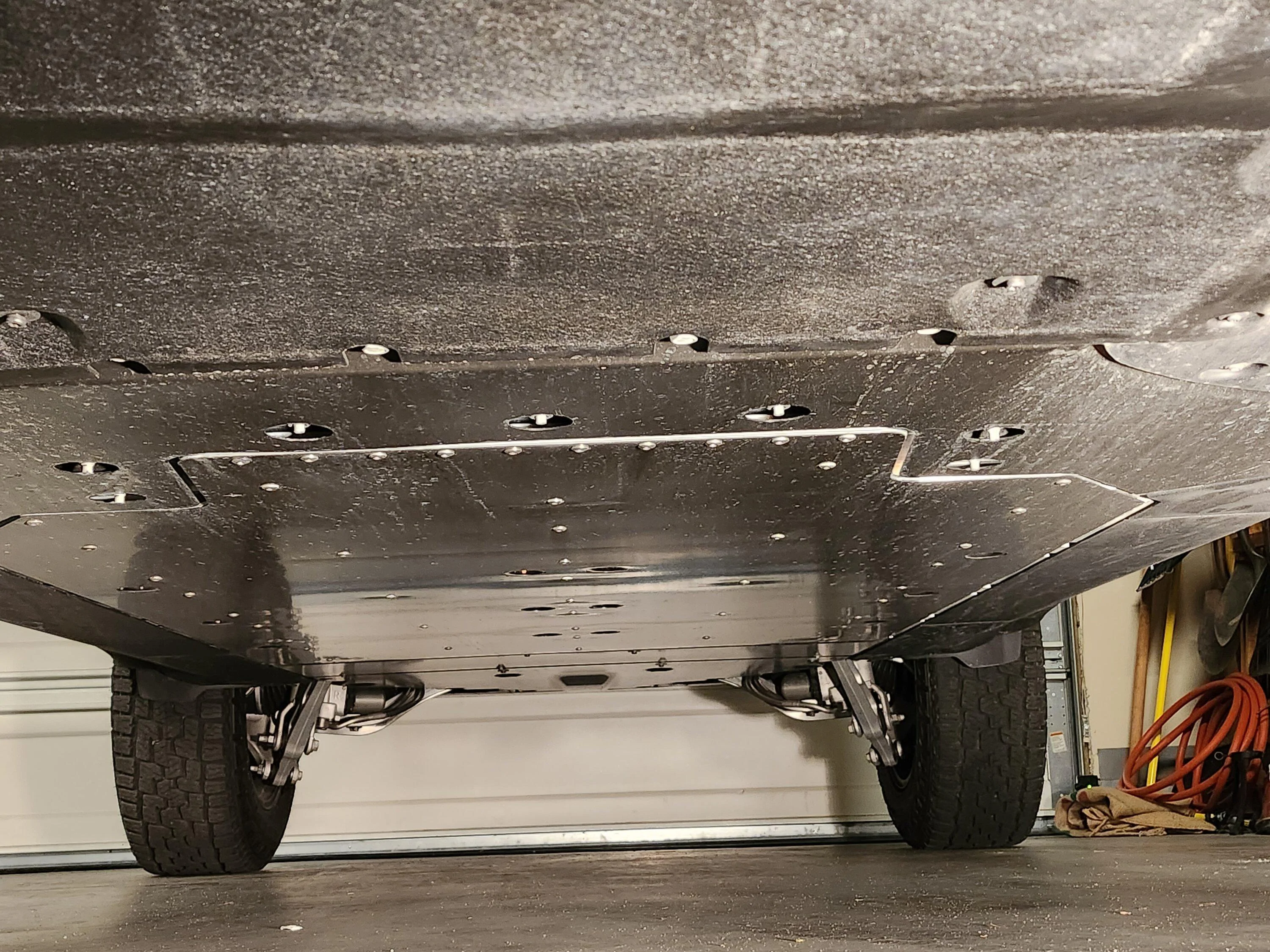

Front looking towards back.
Rivian R1T R1S PSA on Loose Underbody Shield Bolts 20221104_095450

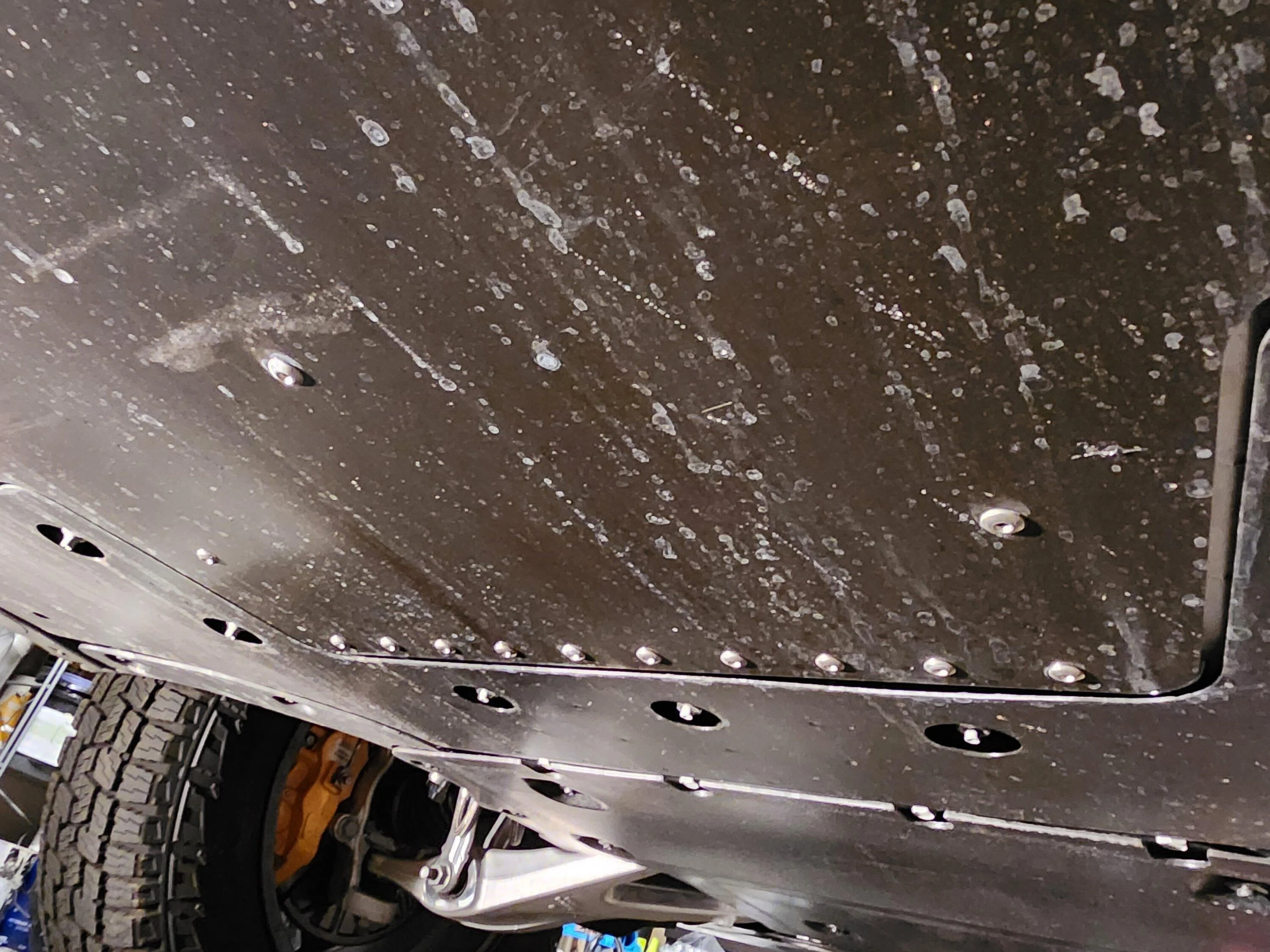

From back looking to front.
Rivian R1T R1S PSA on Loose Underbody Shield Bolts 20221104_095750

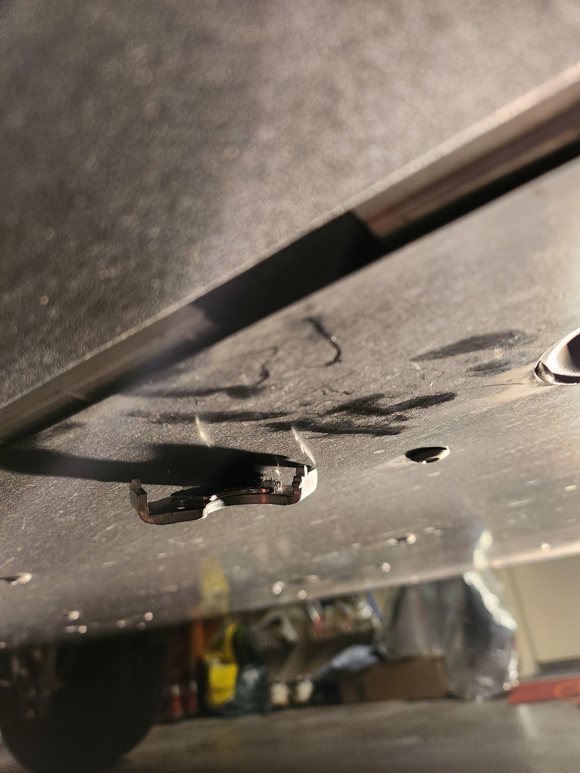

Magnet test.
Rivian R1T R1S PSA on Loose Underbody Shield Bolts 20221104_095714
Steel vs carbon fiber magnetic test.

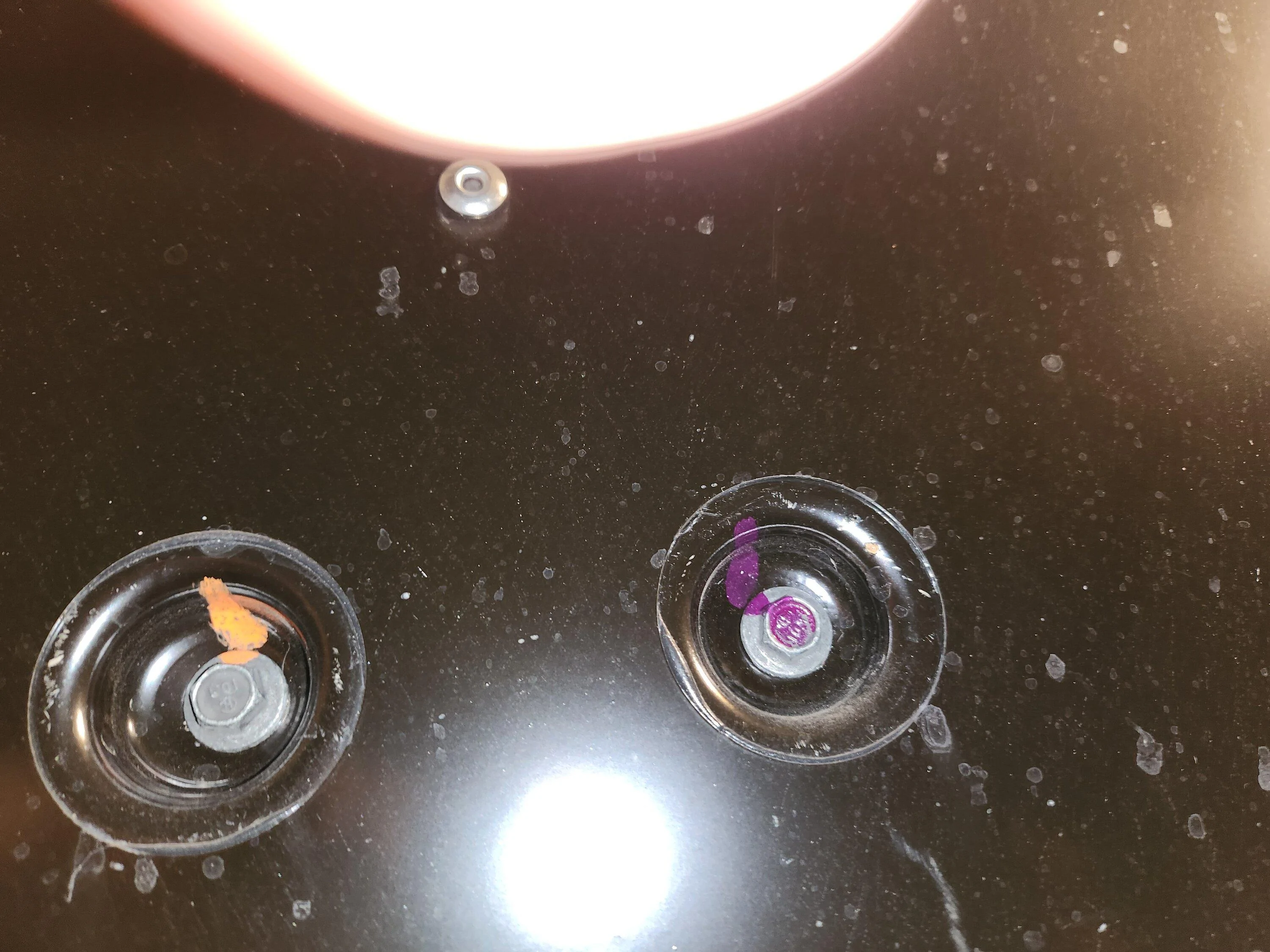

Bolt witness marks.
Rivian R1T R1S PSA on Loose Underbody Shield Bolts 20221104_100039

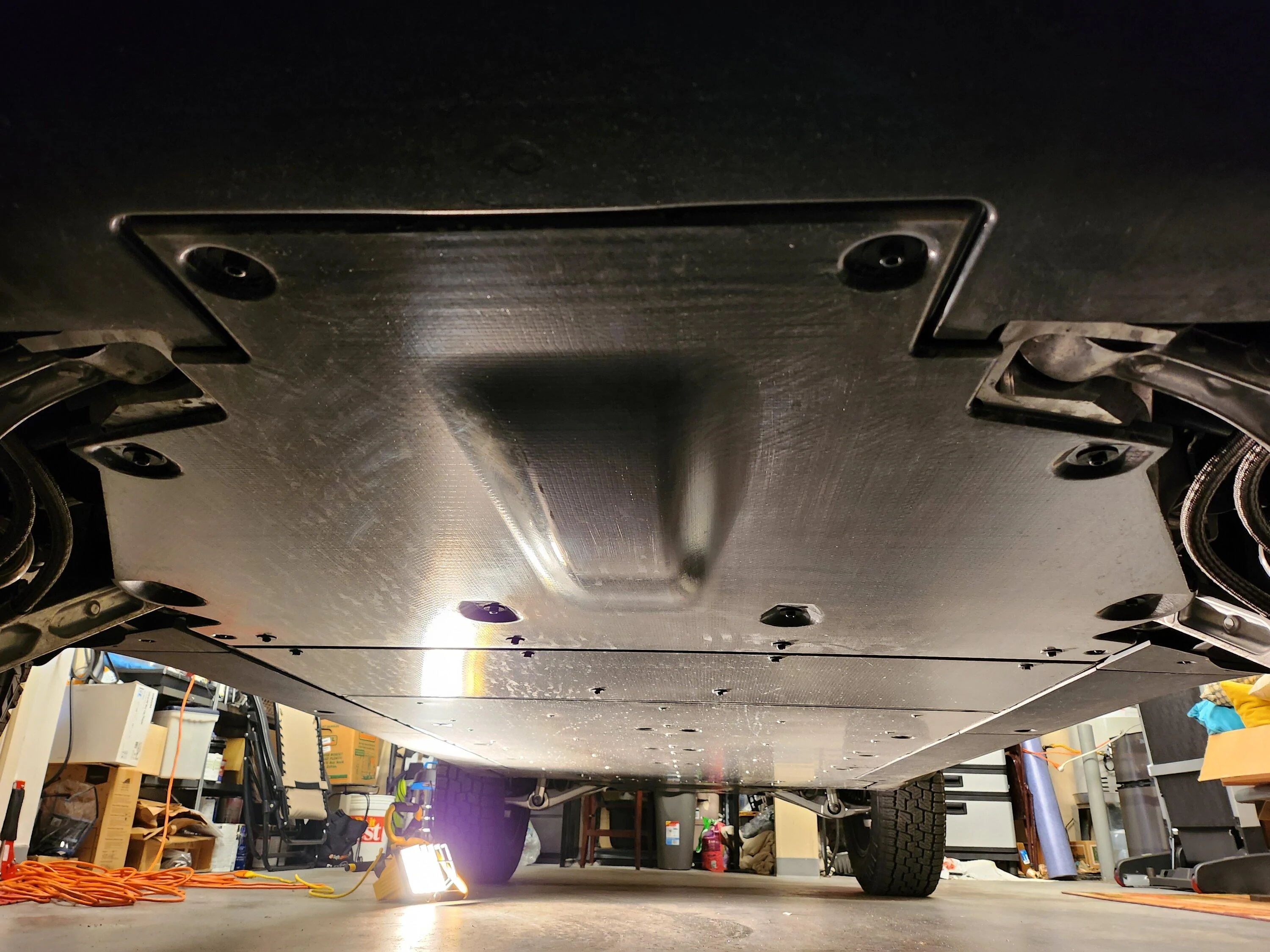

And in case this post is too boring, here's something riveting.
Rivian R1T R1S PSA on Loose Underbody Shield Bolts 20221104_095905

There's probably still some variance. I don't know if QC checks this at the Service Center, but I did find it odd that all of my bolts had the same color witness marks except for one. I actually brought a tarp and got under the truck at the SC before taking delivery specifically to check for loose or missing bolts.
All are still tight after 1 week / ~300 miles.

Magnet test.
Bolt witness marks.
Ok so the reinforced is steel and the non is carbon fiber?
