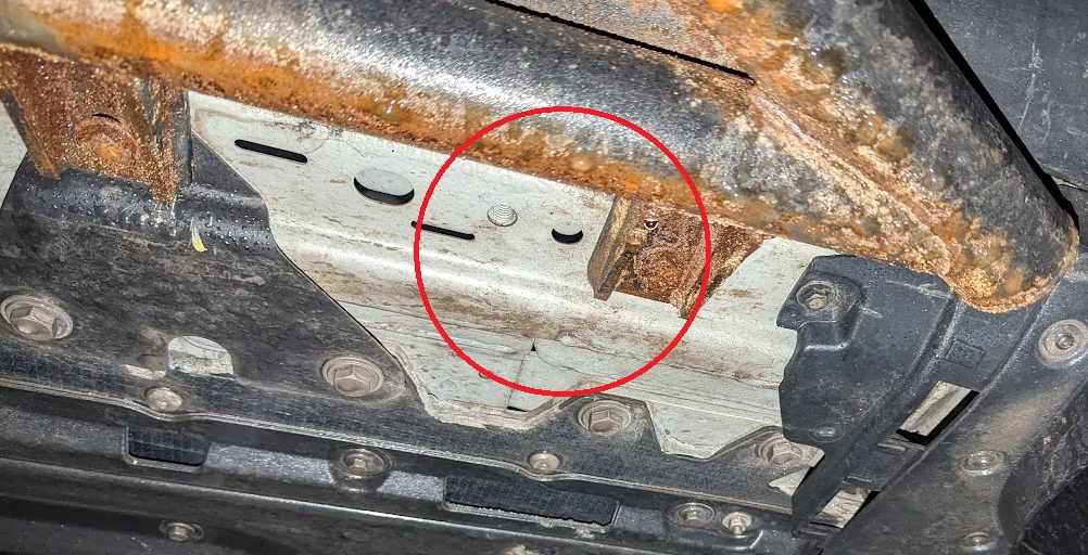

There was a very small first batch of R1S sliders that partially blocked one of the lifting pads, but everything since that has left plenty of room, and I've verified with all the designs since that they will work with the pucks Rivian uses since they are huge.
How do you know if you have one of the first batch? I ordered my R1S GOAT sliders 4/25/2024. Currently at service center and they need to inspect/replace air suspension. Called me to get permission to remove only my sliders for $250. Perhaps they just automatically called without checking first if they will fit with the lift, or maybe I have an early version?
150
13,750
27,921
Engineering, Dog Petting
The rear-most mounting brackets interferes with where the puck goes. Later ones were trimmed back, and anything in the last while omits that bracket entirely. Just got overlooked when the changeover from the R1T to R1S happened since they differ in spacing back there.
Edit:
I don't think I have a photo of the modified ones, but this is the problem area from the original prototype version (It's rusty because it was only rattle can painted for photos, and we left it on for some usability testing afterwards) That bracket will be scalloped out if you weren't in the original batch.
I am still running these ones with the modified bracket on our '23 R1S and my SC has never said anything about it.
Edit:
Thanks, I don't think I have this version. I remember when I installed mine, the instructions/video didn't match up with the sliders I had, so I must have gotten the updated ones. However this Seattle Rivian service center technician is requiring the sliders to be removed to be used on the lift because their puck touches something and they don't sit completely flush (1/2" give). I'll have to re-install them myself in the parking lot at Rivian when I pick up.
