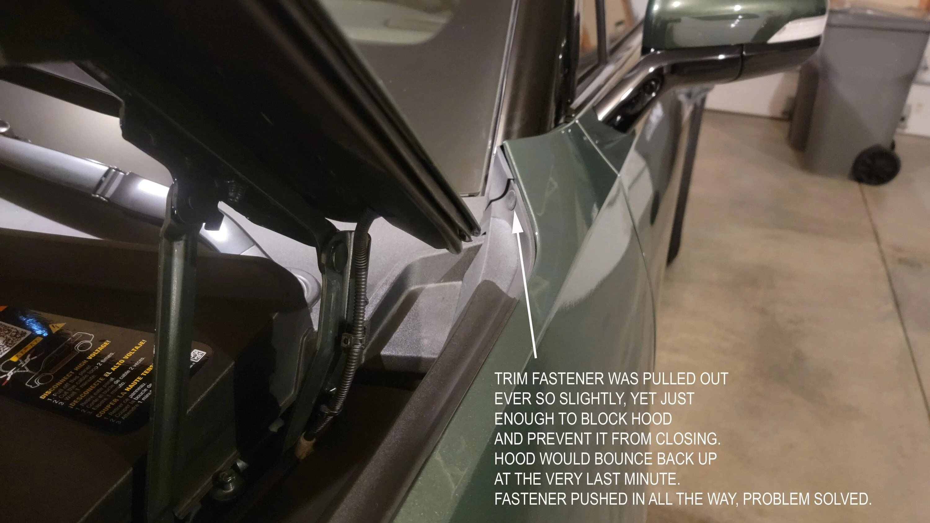

My R1S delivered in early January, 300 miles. Had some relatively minor issues that were addressed. Rear door was binding with driver side door. PPF installer adjusted the rear door brackets and door fit. Problem solved.
Then the hood suddenly will not close; got almost to the bottom and would bounce back up. I will post the absurd and unbelievable issue of that and how it was fixed by Rivian in 1 minute!

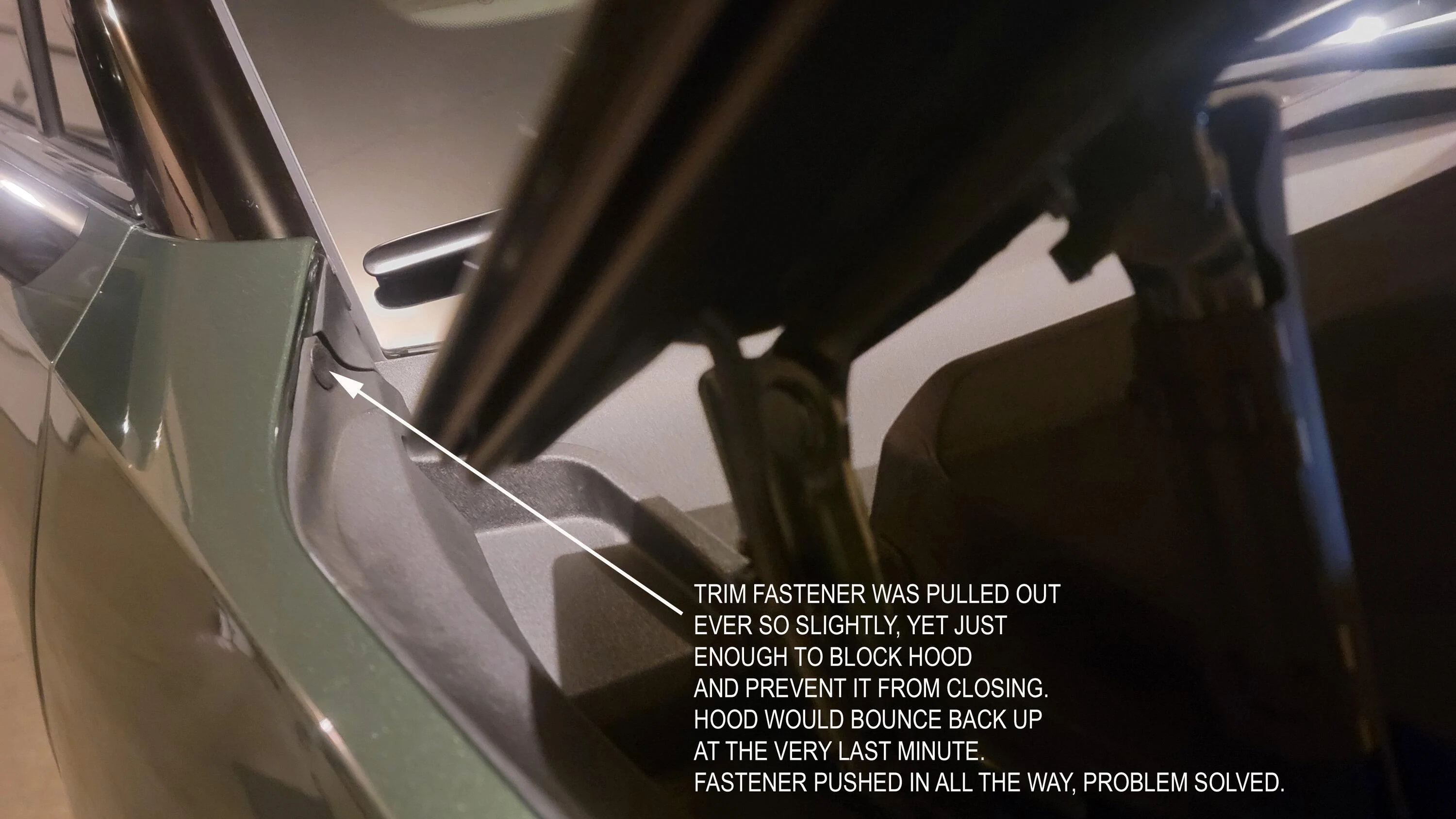

My R1S frunk worked well for the first few days (delivered in January). Suddenly, hood would not close; got very close to the bottom just to bounce right back up with the object-detected warning on the display.
Rivian Mobile Service came yesterday, and fixed it in one minute. The issue: the two rear fasteners, one on either end at the very back holding trim around frunk had popped up ever so slightly, unnoticeable, yet enough to block frunk. Pushed back in. Hood works just fine.
