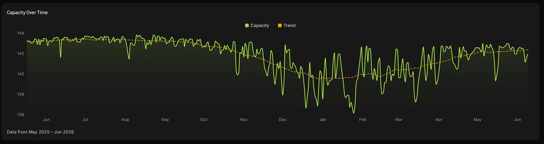

Battery capacity measurement is fickle.
Both of the measurements are probably off as they are often just estimates. On top of that, Rivian doesn't expose gross capacity but instead, net. There is some funny things Rivian does with capacity.
Here's my R1T.
Rivian R1T R1S Probably overreacting but... Losing capacity fast? Screenshot 2026-06-09 at 6.02.53 PM
Here's my R1T.
Well that makes me feel better. I wasn't sure how much to read into those values. Made me worried I was gonna trash my battery in a few trips.
I know the Large pack NCA chemistry doesn't need large charges to calibrate like LFP but wonder if the earlier was more incorrect since I've never gone outside of about 30-70% SOC for nearly 6 months of ownership.

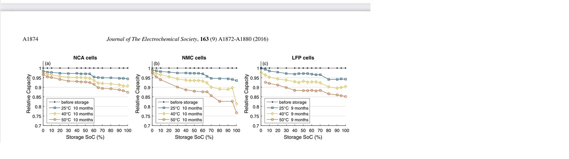

I've generally tried to follow the advice of Jeff Dahn, he's a battery researcher that works with Tesla. He has a whole video on maximizing the lifespan of EV batteries.
Jeff Dahm Video
He recommends:
1.) if you are going to store the car for a long time, store it at around 30%
2.) Charge more frequently - lower depth of discharge is better for battery longevity. Rather than charging to 80% and then driving for several days to reach 20%, charge each day to maintain a low DOD.
3.) Charge to no more than 75% regularly. Occasional 100% is fine.
The Tesla Motor Club forums have taken that to extremes. The advice one well received member gives is to keep it to 50-55% unless you need more. They cite the below graphic where range starts to drop off at 60% SOC. The reason they use 50-55% is because of the internal buffer the car has. So when the car says you have 50% you have more - how much is unknown. This is a bit extreme, although I do keep my R1S at 50% in the summer and 55% in the winter because I generally don't need more than around 10% a day in range. My Model Y, which is driven more gets charged to 65% daily.
Rivian R1T R1S Probably overreacting but... Losing capacity fast? cell aging
For most people though, its not really something to worry about - just use the car and keep it below 75%
Jeff Dahm Video
He recommends:
