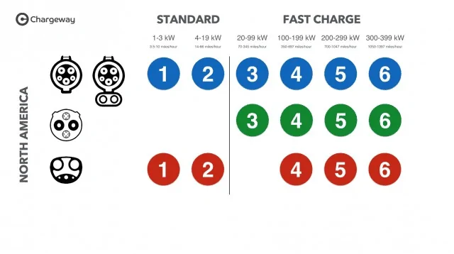

These appear to be Level 6 (Chargeway) which is what it Rivian is building out. Should be 200 mi in about 20 min.
Vermont on the other hand, excepting Tesla, really only seems to have the Level 4 (50kw) charging.
Level 6? Level 4? Whose system is this? The only one I know
Level I: 120V AC charging
Level 2: 240V AC charging
Level 3: DC "fast" charging
CharIn names their standards with names that suggest the maximum power e.g. HPC350 for 350 kW.
Tesla chargers aren't exactly thick as sprats in Vermont either. But nothing shown or planned for CCS above 50 kW in the whole state.
I know the founder(s). They did a poll at the auto show to confirm their position that people did not know what a kW or kWh was. They got utility company money and other grants to develop a new labeling system and app that had a different color for the different connectors and a number associated with it to show relative charge speed.
Your Model X would be a "Red 4", Model 3's are "Red 5", A Nissan LEAF would be a "Green 3" and "Blue 2". Rivians will likely be classed as a "Green Blue 6". Teslas come with adapters to let them use "Blue 2" stations, and you can buy one to use some "Green 3".
The theory is that the average driver won't be able to understand CCS vs Tesla vs CHAdeMO and kw and kWh's are totally beyond their comprehension.
They have an app that allows you to put your vehicle in and it will show you only charging stations that are compatible with your vehicle. The have "Beacons" they place in auto dealers that are 6 foot tall cell phones running a demo version of their app with the idea that it will help clueless car salespeople explain how to fuel your EV.

Many utilities have some mandates requiring "Education" or other means of promoting EV adoption and there was money on the table. They grabbed some. I think they were getting $10K+ per dealership to place the beacons in the first test cycle (from the utilities, not the dealer).
They have been able to get most charging companies on board, and coordinated with EA on their handle colors for CCS vs CHAdeMO.
Not sure how much traction he will get long term with CA requiring public charging to be labeled with the kW rating, price per kWh, and a gas pump like meter displaying kWh dispensed and the cost.

That color and number system makes a lot more sense for the average person who won’t fully understand the technology. It also seems like a quick visual that folks can latch onto to know speed and compatibility. I’m a fan. I’m of course still going to be curious about details, but most folks won’t as EVs become more common heh.
