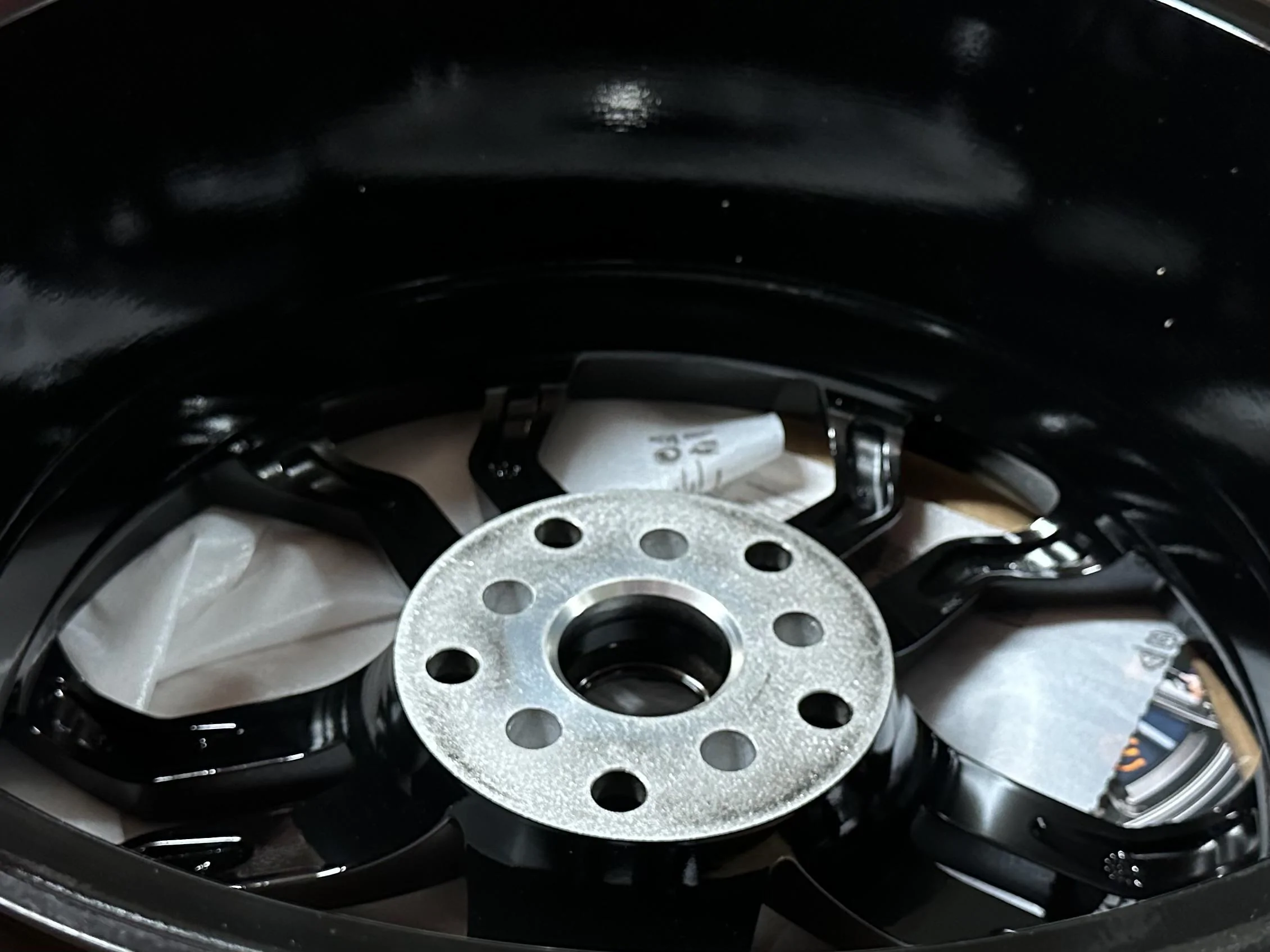

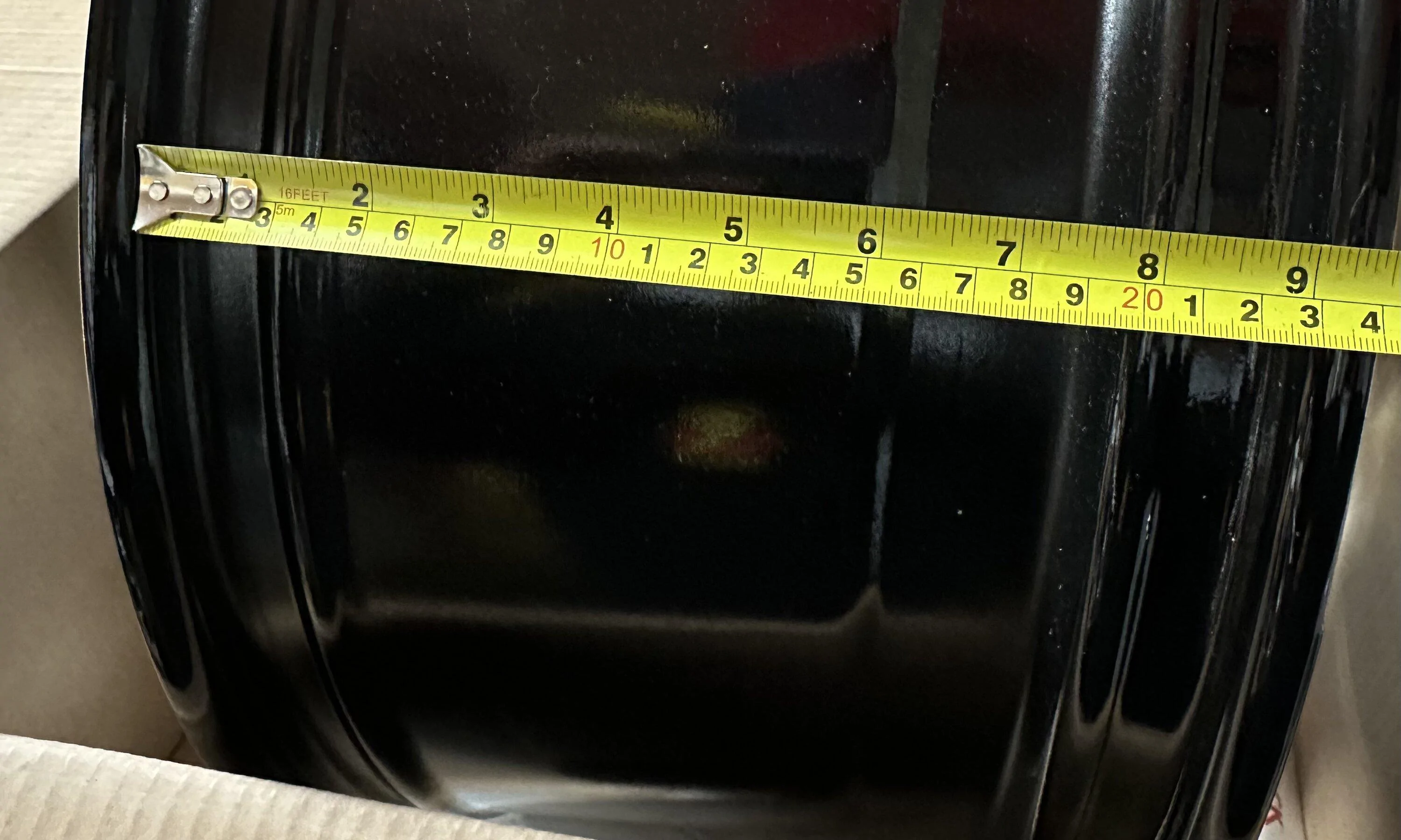

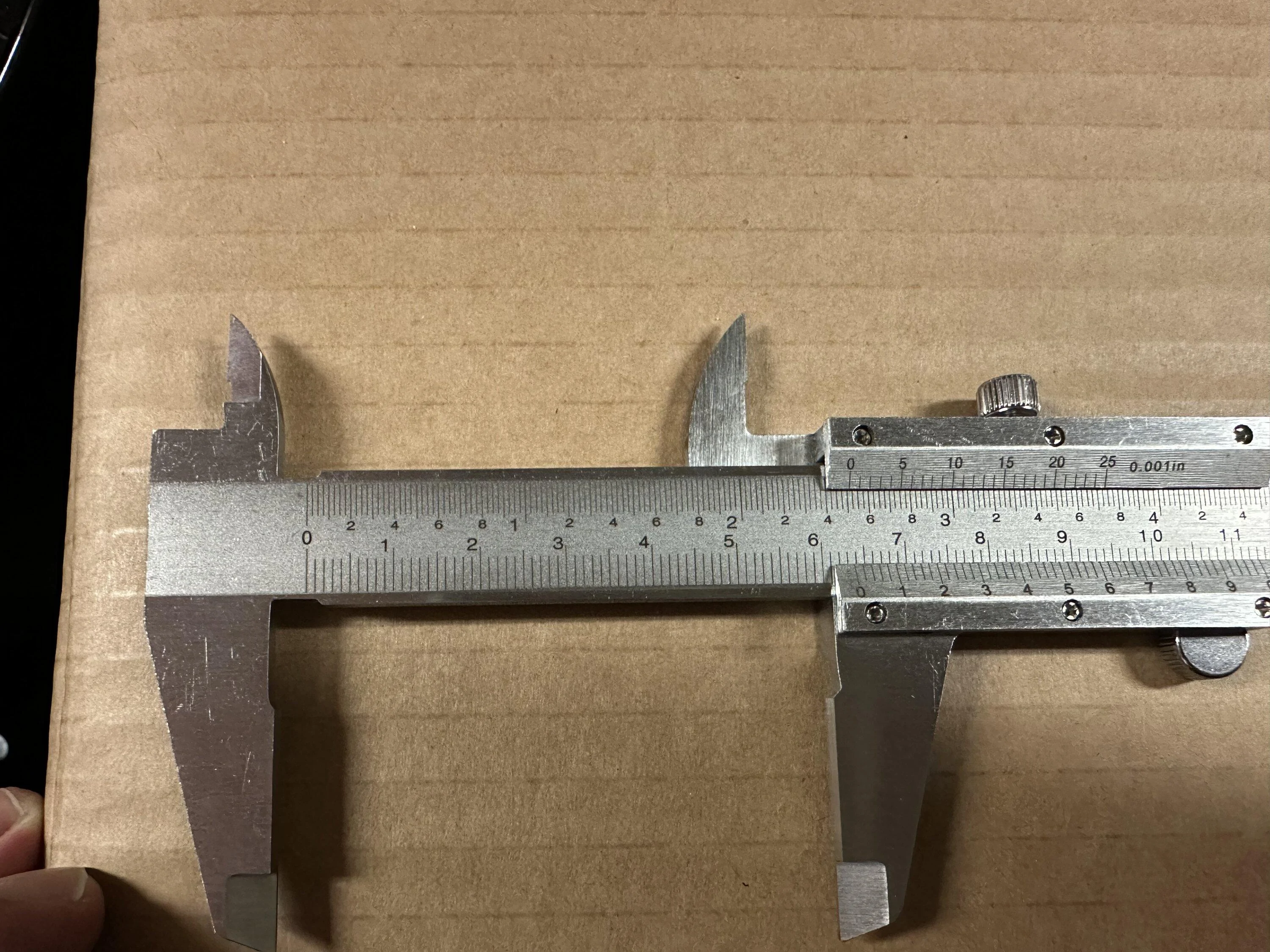

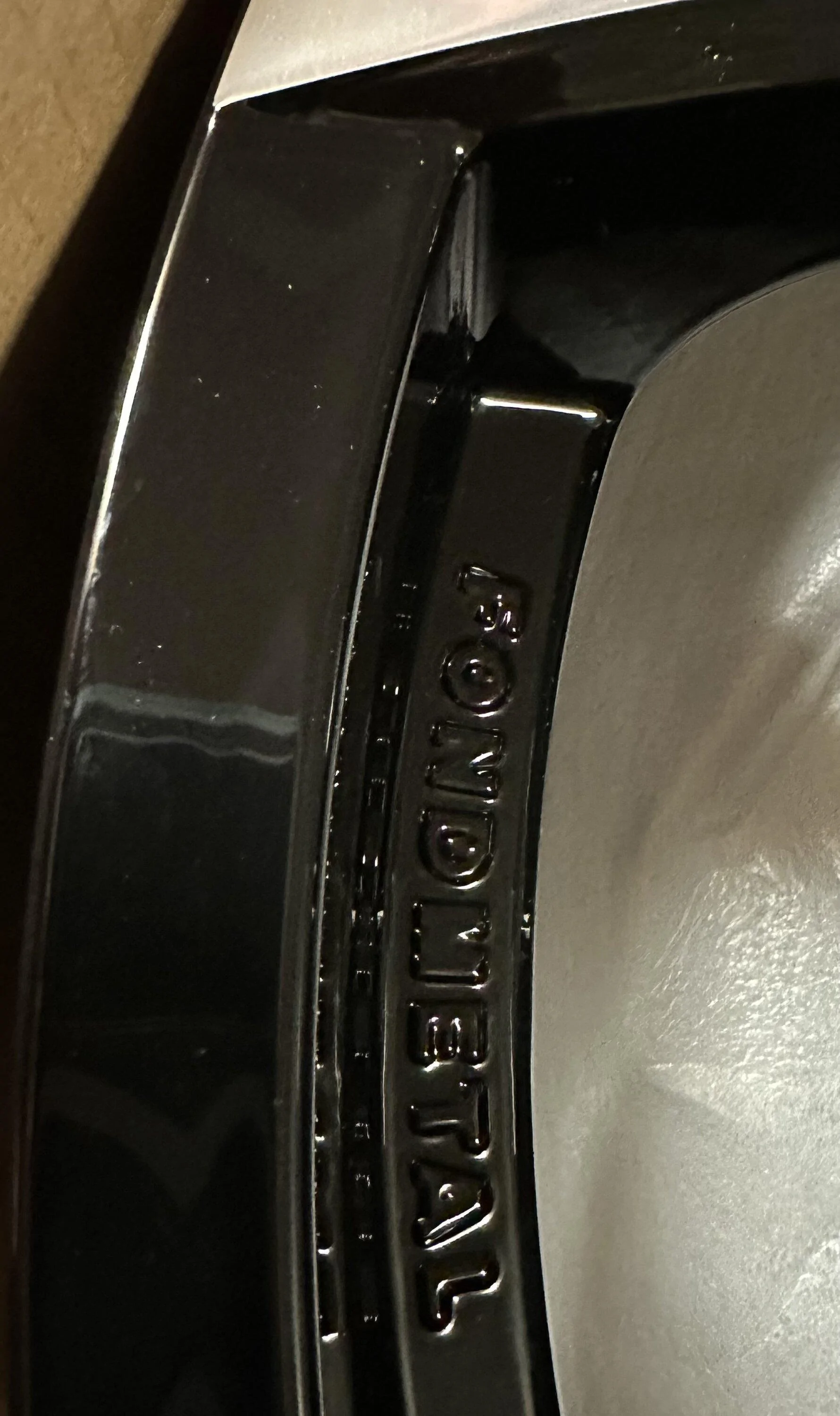

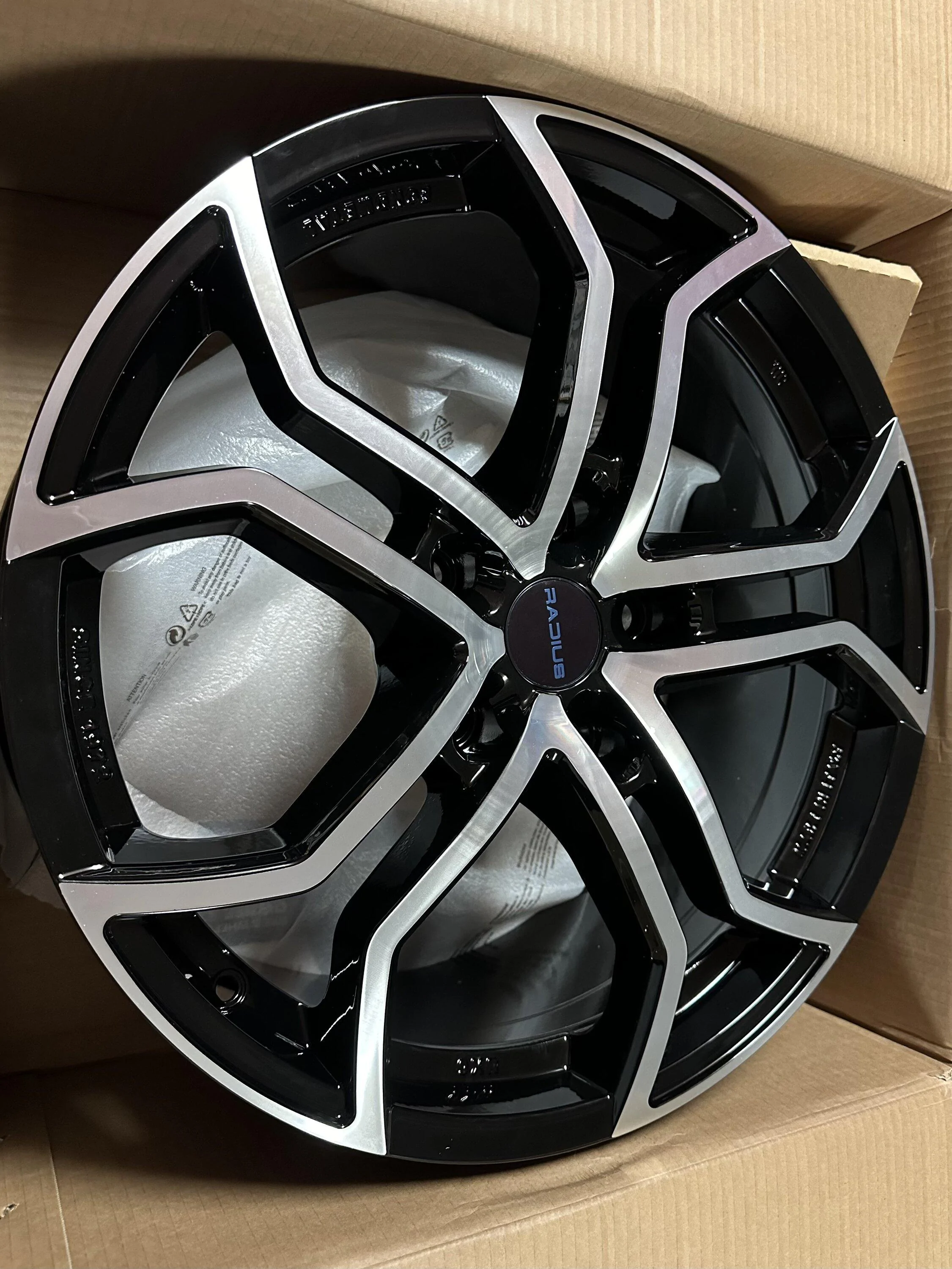

Measured the center bore with my cheapo calipers. Does appear to be roughly 64mm so great news there. Took a few photos of some of the markings, and also the backside of the wheel. You can see from the backside the clearance to the calipers looks like it will be fine.
Also tried the Rivian center caps that fit the oem 21” wheel, and they are too small so those won’t work, unfortunately.
Rivian R1T R1S Ordered new 20” wheel with +48mm offset from Tirerack IMG_1010
Center bore measurement.
Rivian R1T R1S Ordered new 20” wheel with +48mm offset from Tirerack IMG_1008

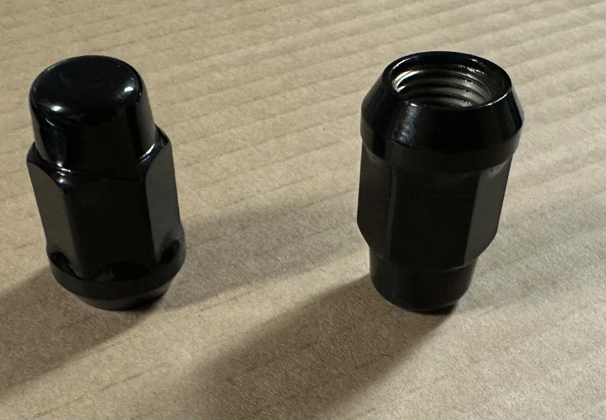

Supplied Lug nuts.
Rivian R1T R1S Ordered new 20” wheel with +48mm offset from Tirerack IMG_1007
Fondmetal marked on front

View from rear looks promising for clearing the calipers. Spokes could not really be any more out of the way.
Rivian R1T R1S Ordered new 20” wheel with +48mm offset from Tirerack IMG_0999

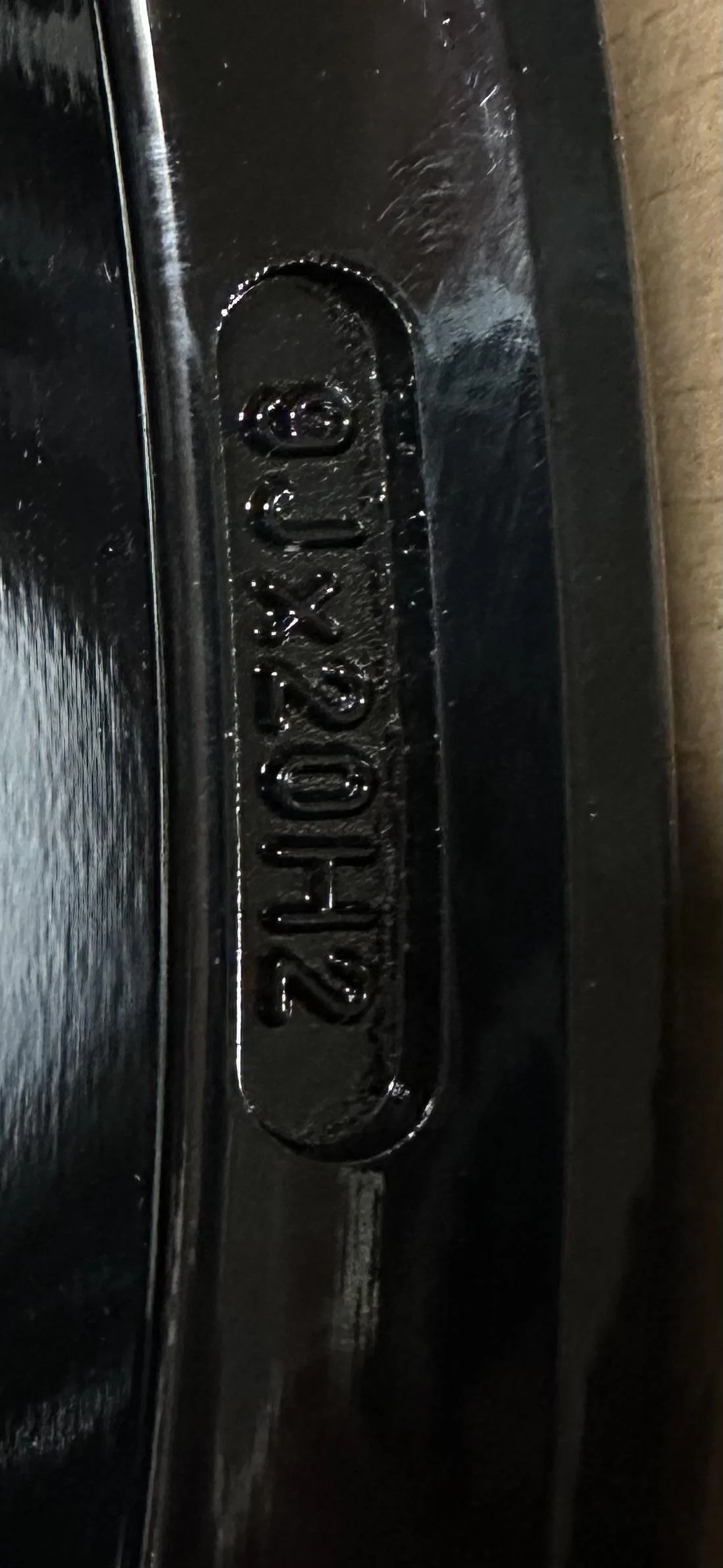

Rear marking - 9Jx20H2

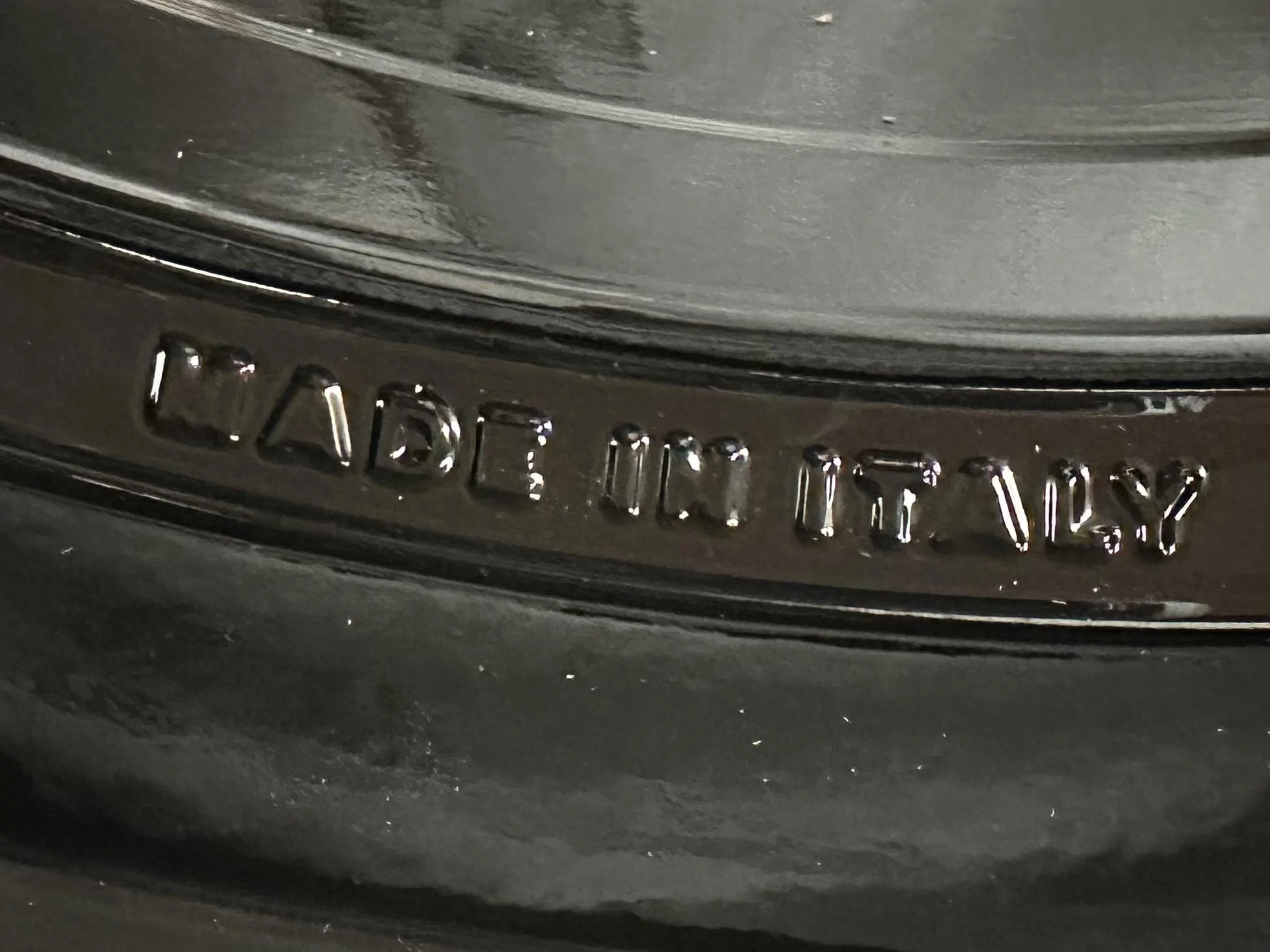

Front marking "made in Italy"
Rivian R1T R1S Ordered new 20” wheel with +48mm offset from Tirerack IMG_1006

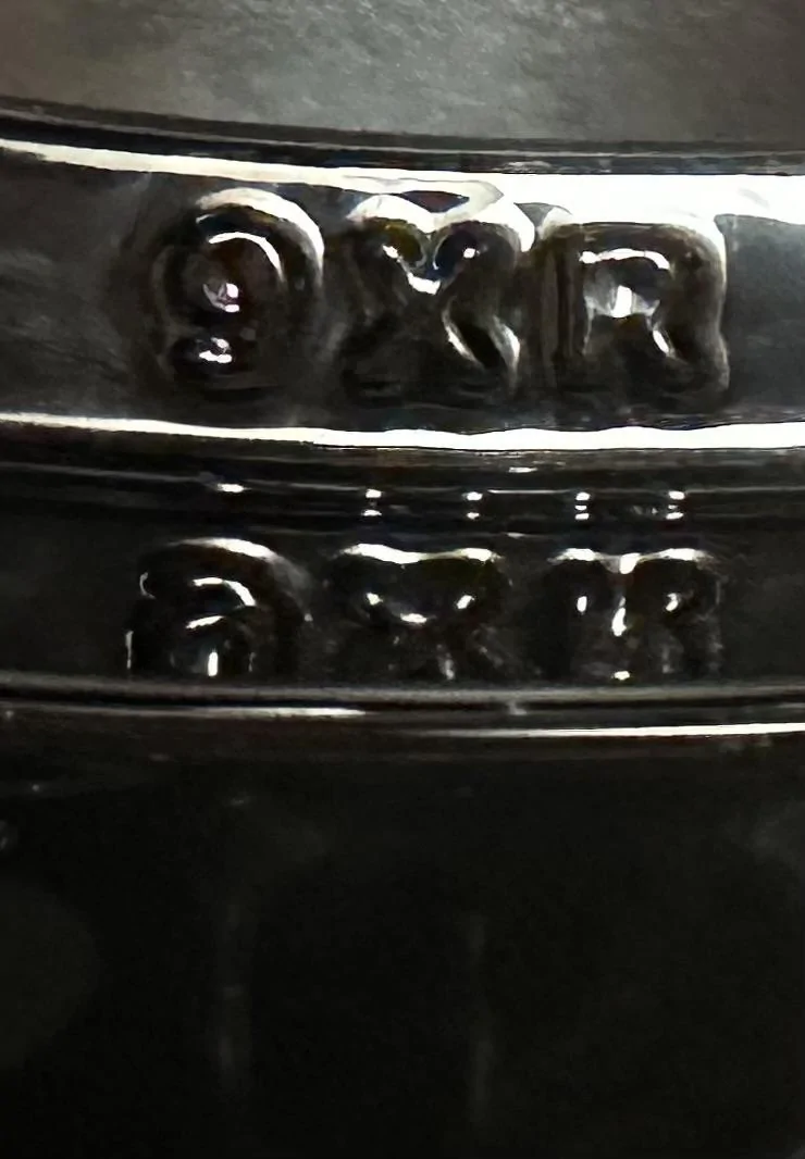

Front marking 9XR
Rivian R1T R1S Ordered new 20” wheel with +48mm offset from Tirerack IMG_0998

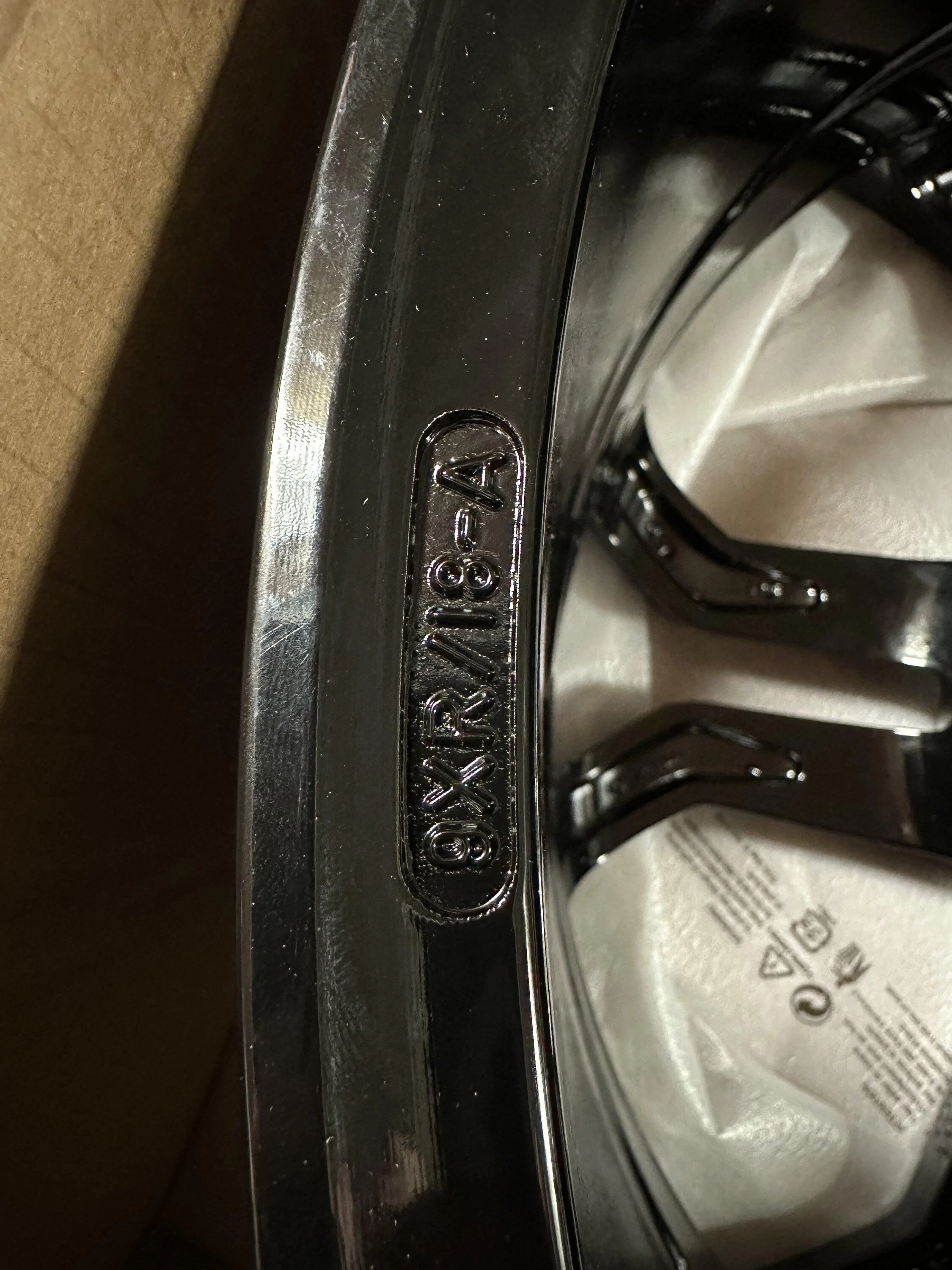

rear marking 9xr/18-A. Presumably 18-A is the sub-model.
