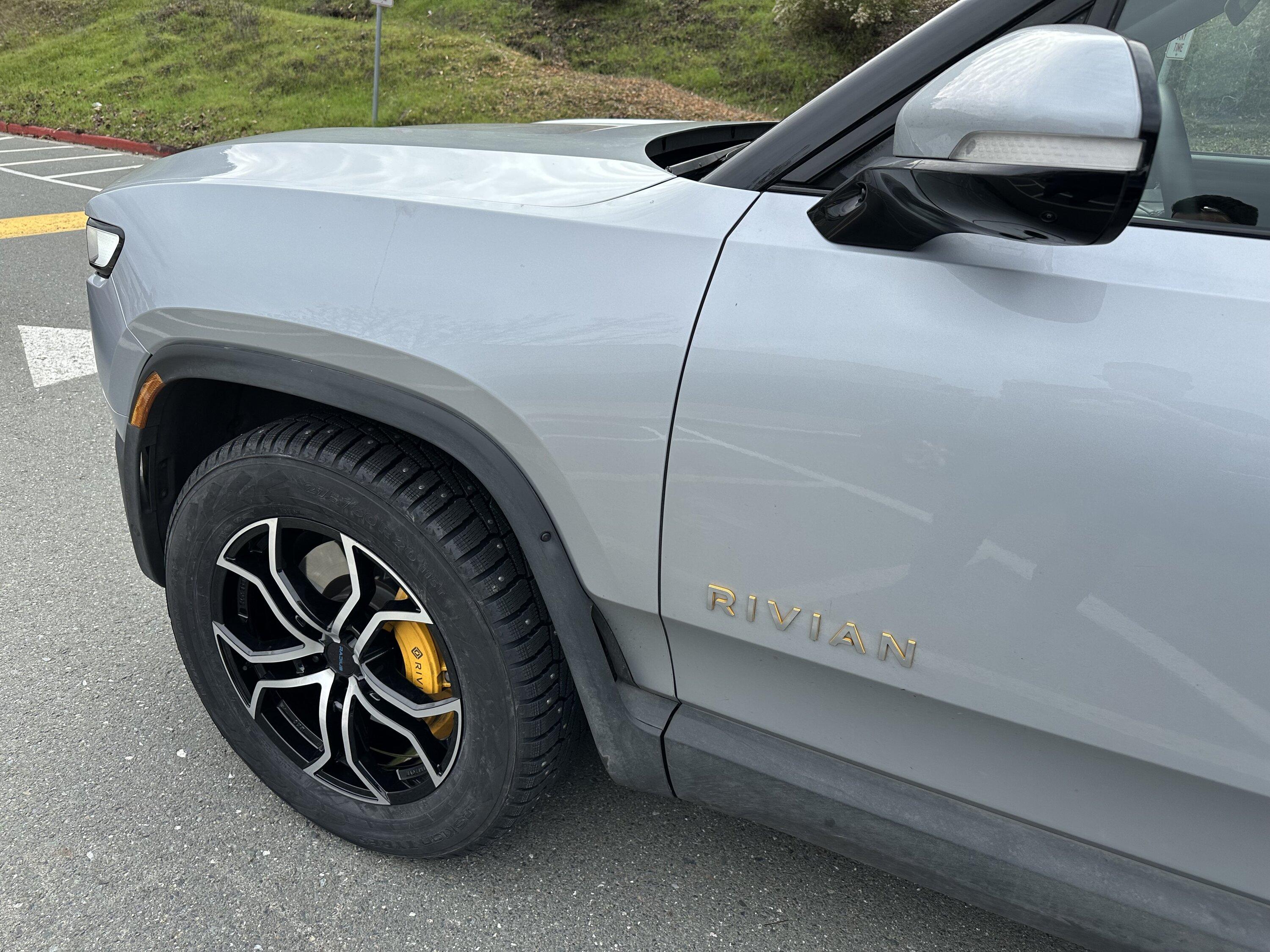

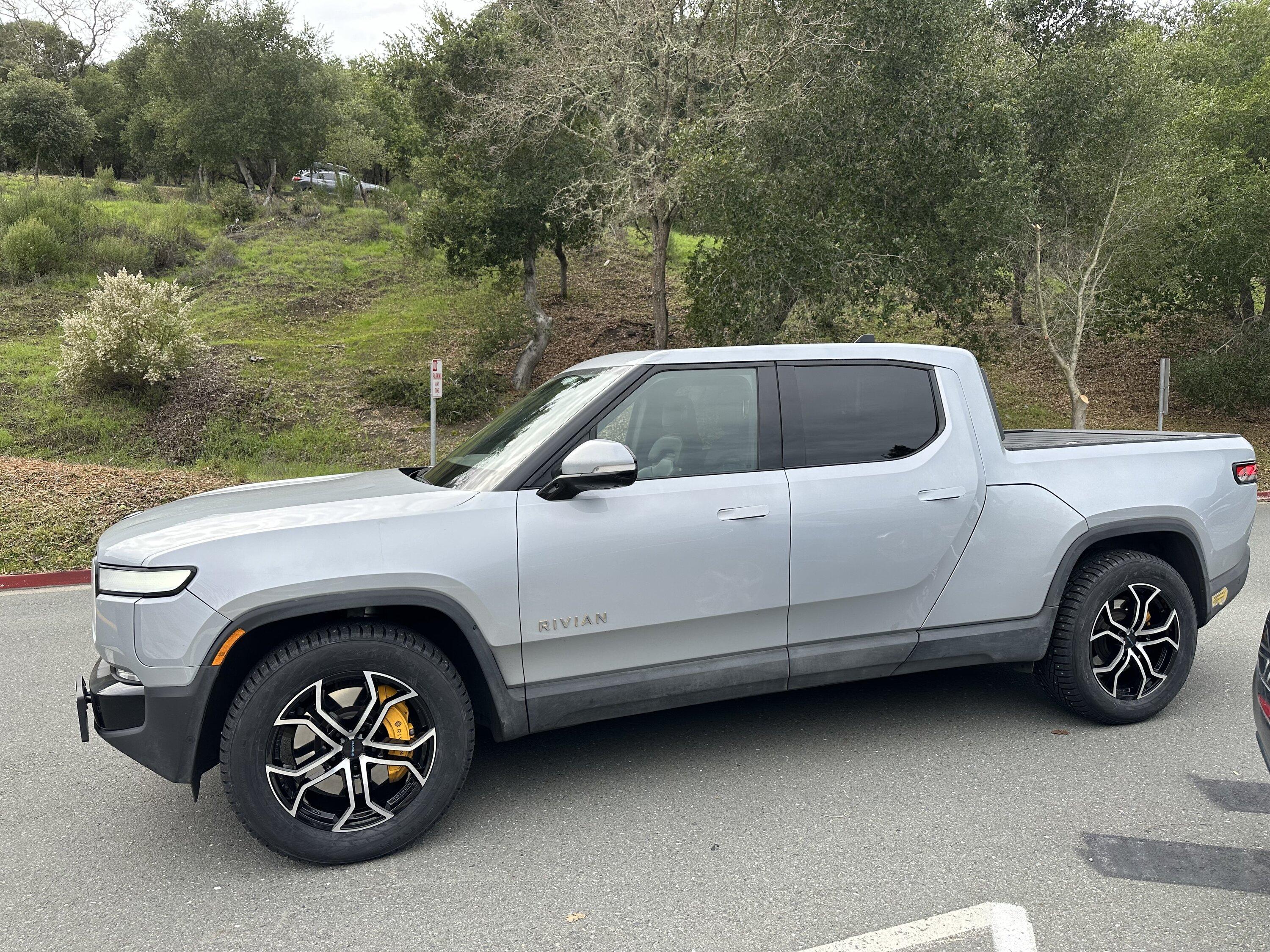

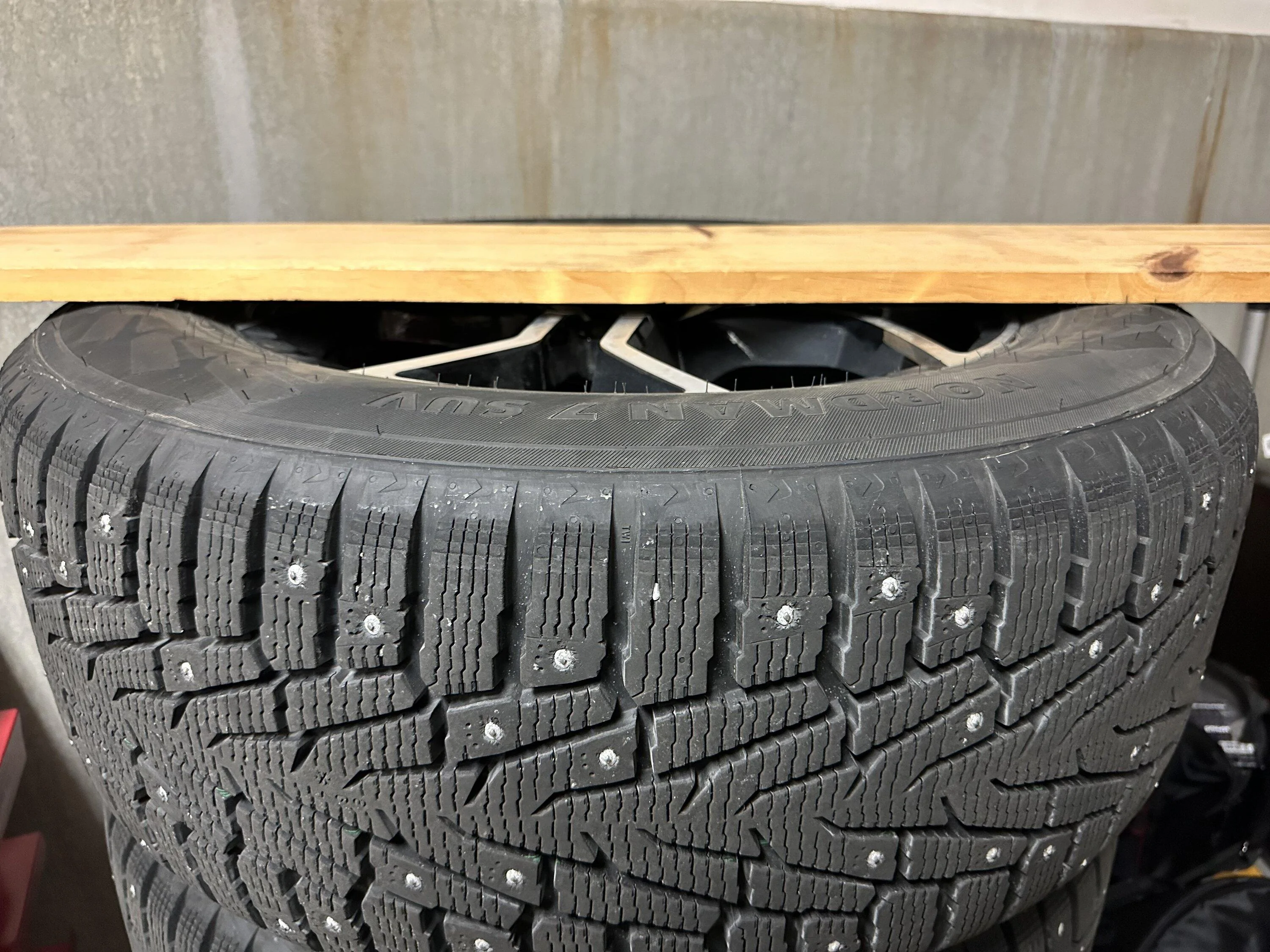

Finally fitted mine too.
Swap was easy with JackPucks.com XL puck and Red bottle jack from Amazon. Had to use a 2x6 under the jack on the rear to get enough lift.
Truck handles great, and very happy with the Nokian Nordsman 7 SUV studded tires. Rivian has done a great job with sound dampening from road noise.
Only minor disappointment is the Amazon TPS units are not being recognized by my truck. Will probably have to buy the cloning tool after all.

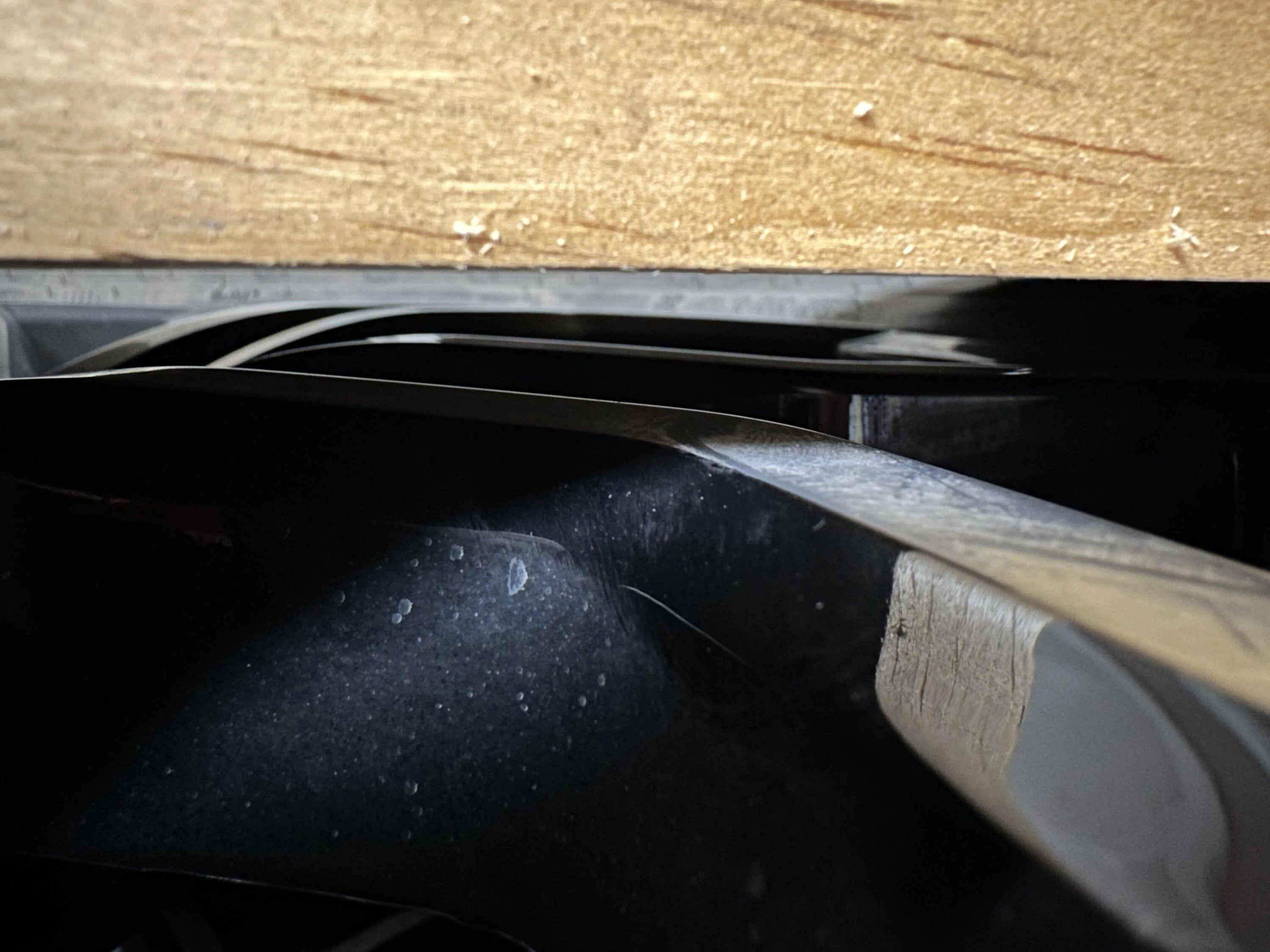

Do the wheels protrude out passed the tires? They seems to.
i.e. If hit something it will now be easier to scratch the wheels, vs the tires?
My gut said no, but I also measured and no. Not with a 275/60R20 tire, at least.
I will protrude a tiny bit since it is a tad wider than the OEM. 8.5" ro 9".
