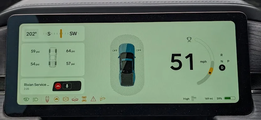

How not full are we talkin? This was with my foot on the ground today:
Rivian R1T R1S Not getting full acceleration gen1 quad 1734720632748-bt

Looks almost like conserve mode from the power level. Did you try a reboot?

I will try and get pictures but hitting the gas and taking a pic might be a challenge, I will find a friend. But I was in both Sport and normal already around 30mph. The temp is in the 50’s and battery was between 60 - 70%. The power bar probably was at 90% full green

Sport mode doesn’t apparently go all the way to the top. AP does based on recent testing on the highway.

Try to do a DCFC session to warm up the battery. 50 deg F is too low. Also I heard having suspension in the lowest position unlocks full power
