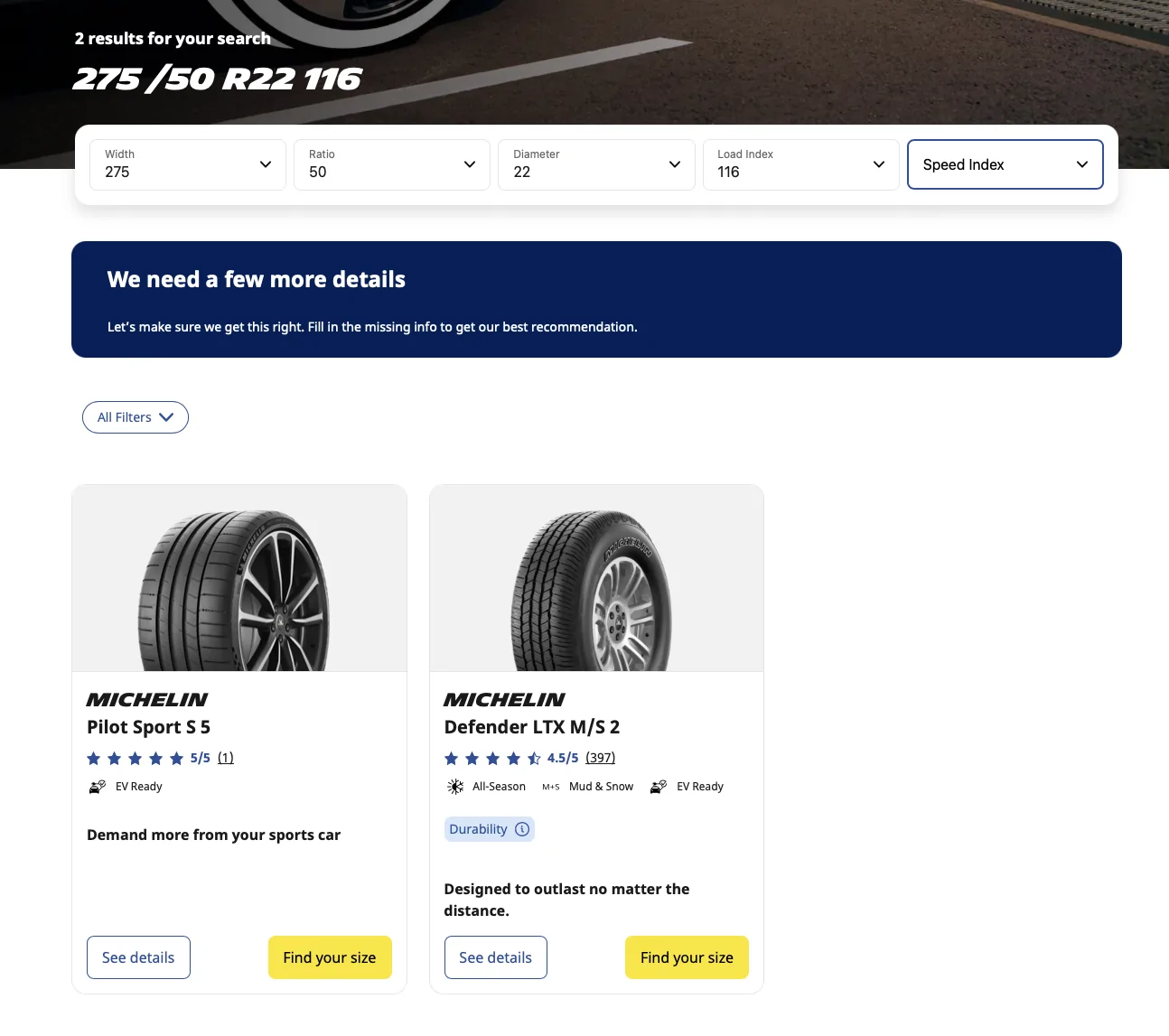

Two things.
1) Micheline LTX M/S2 275/50/22 does come in 116 load index
https://www.michelinman.com/auto/browse-tires/by-dimension/275/50/22/116
Rivian R1T R1S Need 22" inch AS tire recommendations 1765925959261-3h
2) I have the original LTX M/S2 at 115 installed by Costco on my R1S. Now 15K miles on them without any issues.
The PS S5 is a summer UHP tire and not AS.
