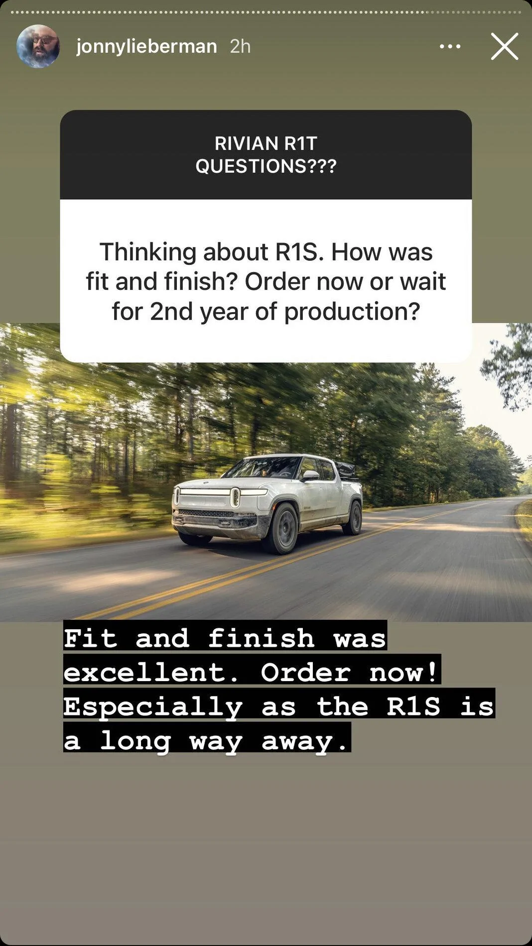

Anyone see where he says the R1S is way off? What did he know that I don't...
Yea just saw that - I wonder what exactly he means. Clearly they are not going out in September, but I'd be surprised if we did not see at least a handful of R1S deliveries by the end of the year. And in that sense, Nov/Dec is a long way away from September :D.
I just saw that! Gonna have to follow up. ????
