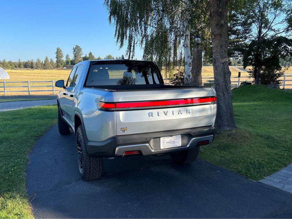

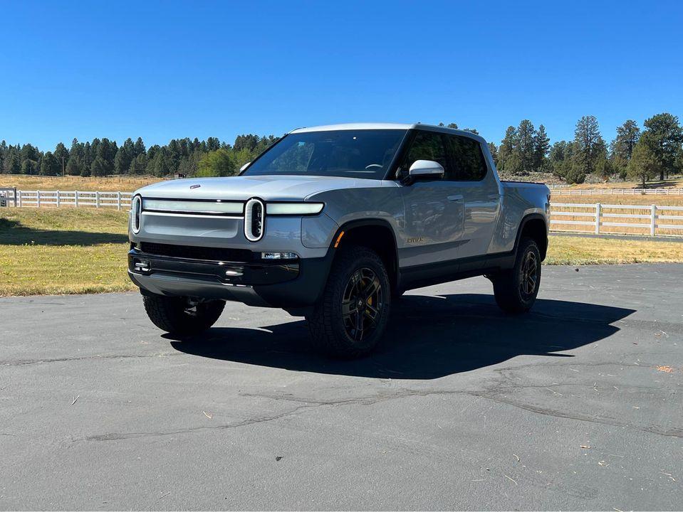

Hello brother (from another mother)! Yeah, I pick my optioned up R1T Adventure on Monday. Recall work already performed. At least here, the Rivian doesn’t vibrate like my MoFo Plaid! Selling the MYP, only because I need an empty bay in the theee bay garage for the R1T.
I’ve read that the recall retorquing has eliminated the “tocking” and pulling to the right for some members. I will be driving mine six hours home so I’ll get a good feel for it as it compares to the Tesla.
When did you get yours? SPECS, S/N, color? Mine is S/N 99xx - so it was pre Sandy Munro suggested cheapening actions (12v in frunk, magnetic trim clips, etc), but far enough along in the production cycle to avoid some of the early run issues. 238 miles on her, and the spec owner I know pretty well - who is as OCD as me. Supposedly this one is perfect, and even the Tonneau works (for now)! ?
