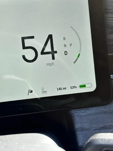

I just took a trip to Solvang, Ca. I decided to take the 154 home which is a winding downhill mountain road. With a 53% state of charge, temps in the 50s my regen was limited to about 20%. I’m not sure if I should call in a support ticket or if this is normal behavior. I’m still on software 2022.47.0. Has anyone received a fix for this?
Rivian R1T R1S Limited regen after new s/w update? D87B5BEC-39AF-4B0C-AF09-E1EC864712A1
