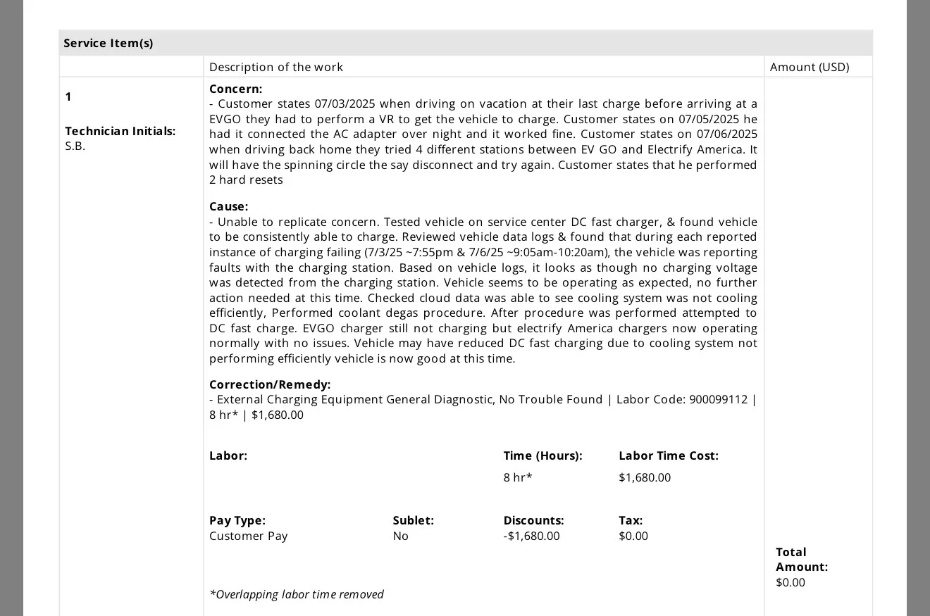

Hi, I had this issue, and my gen 1 quad randomly stopped DC charging during a road trip as well. Would not charge at Tesla, EVGO, or Electrify America. Level 1 and 2 worked fine.
I’m from Denver but was closest to Salt lake at the time. It was a headache to get addressed.
I had to fight the service advisor because they initially tried to give me the truck back without fixing anything and said nothing was wrong. This is because they plugged into the DC fast chargers at the salt lake center and it worked, however those chargers aren’t similar to any charger you’d encounter on the road so, I refused pickup as I was back in Denver during repairs, until they took it to a public charger.
When they did that, it did not work at either EVGO or EA, and then they actually dug into the logs. Apparently there are data logs on the truck, and logs that can be accessed via the cloud and that is where they saw some issues.
The fix for my truck was doing a degassing procedure on the battery coolant and topping it off. The tech’s theory is the coolant was low enough it triggered a safety mechanism to keep the battery from overheating which caused the issue with the DC charging. To be clear I saw no warnings in the truck, and no specific code was thrown from what I was told. That being said everything has worked great since then.
That being said, when I had my issues I saw a number of threads that referenced the gcm module needing to be replaced. Unfortunately there doesn’t seem to be a well laid out testing procedure for this so you may have to fight for it.
I’ll post my service ticket. Good luck I hope you get it resolved, push the rivian support people to comp you a hotel stay and some charging/gas money. Senior leadership with phone support should be able to if you ask.
Rivian R1T R1S Level 3 Charging (only) Not Working IMG_0096
