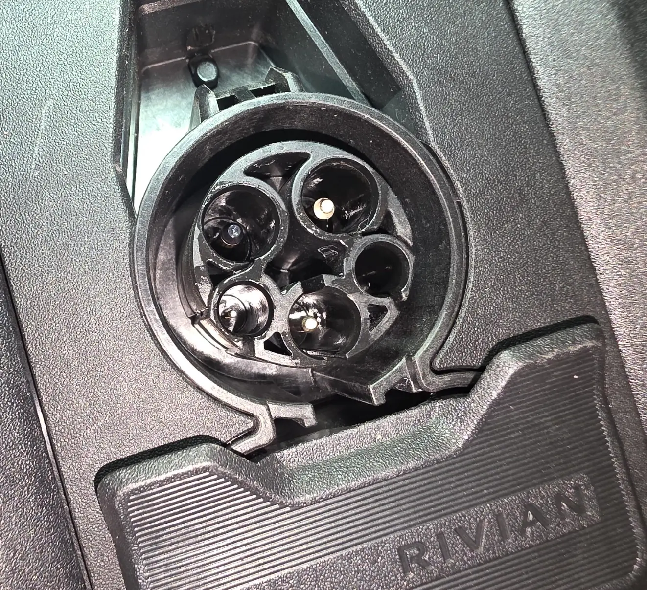

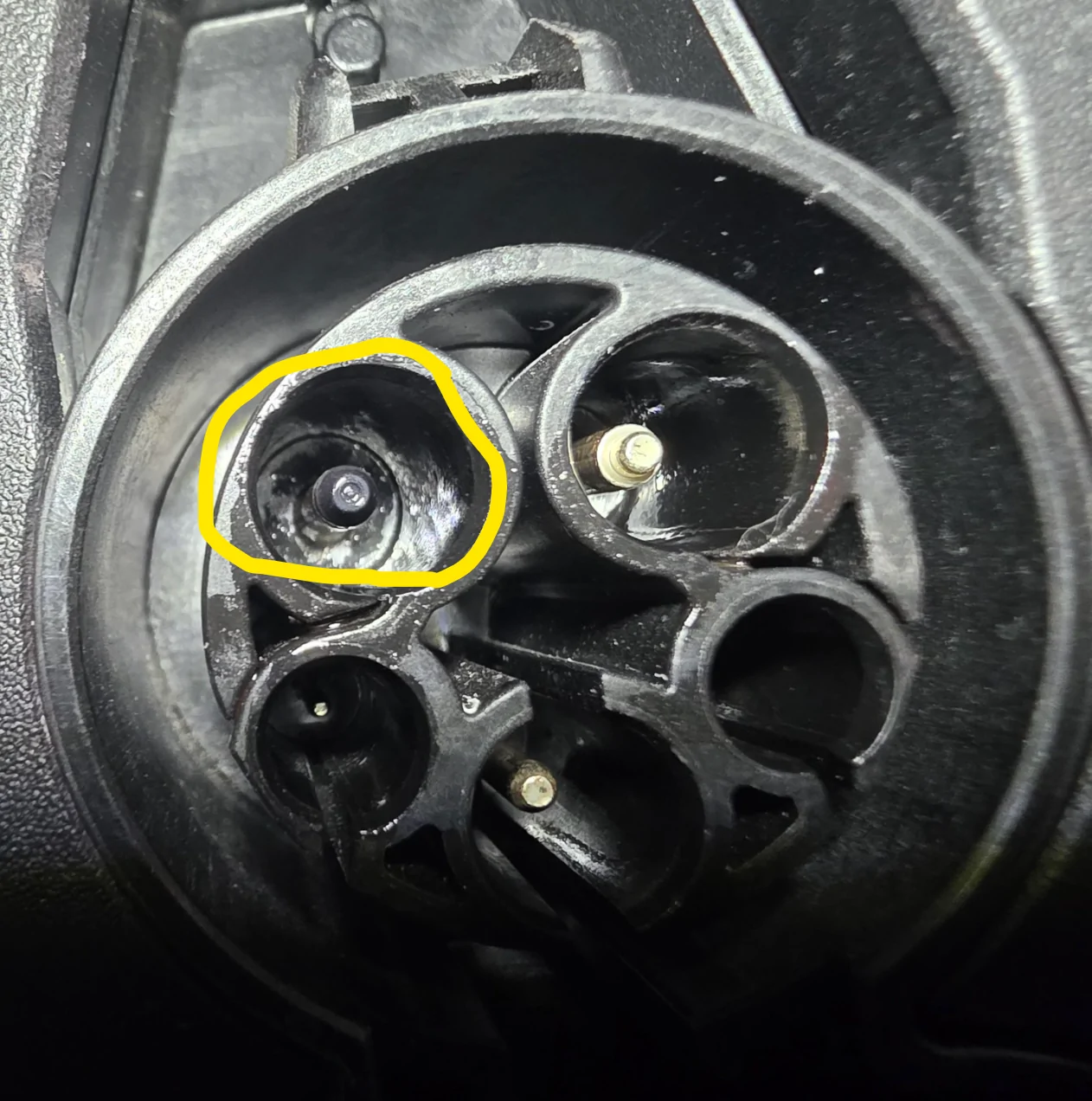

It can say whatever. But physics is physics. Heat generation (power) = Resistance * electrical current ^2. Adding an extension cable is adding resistance. Now, you can just back off the current to bring the temps down. But to run it at max current with the extra resistance is asking for trouble. And from the looks of it, you've already damaged your charge port inlet.
