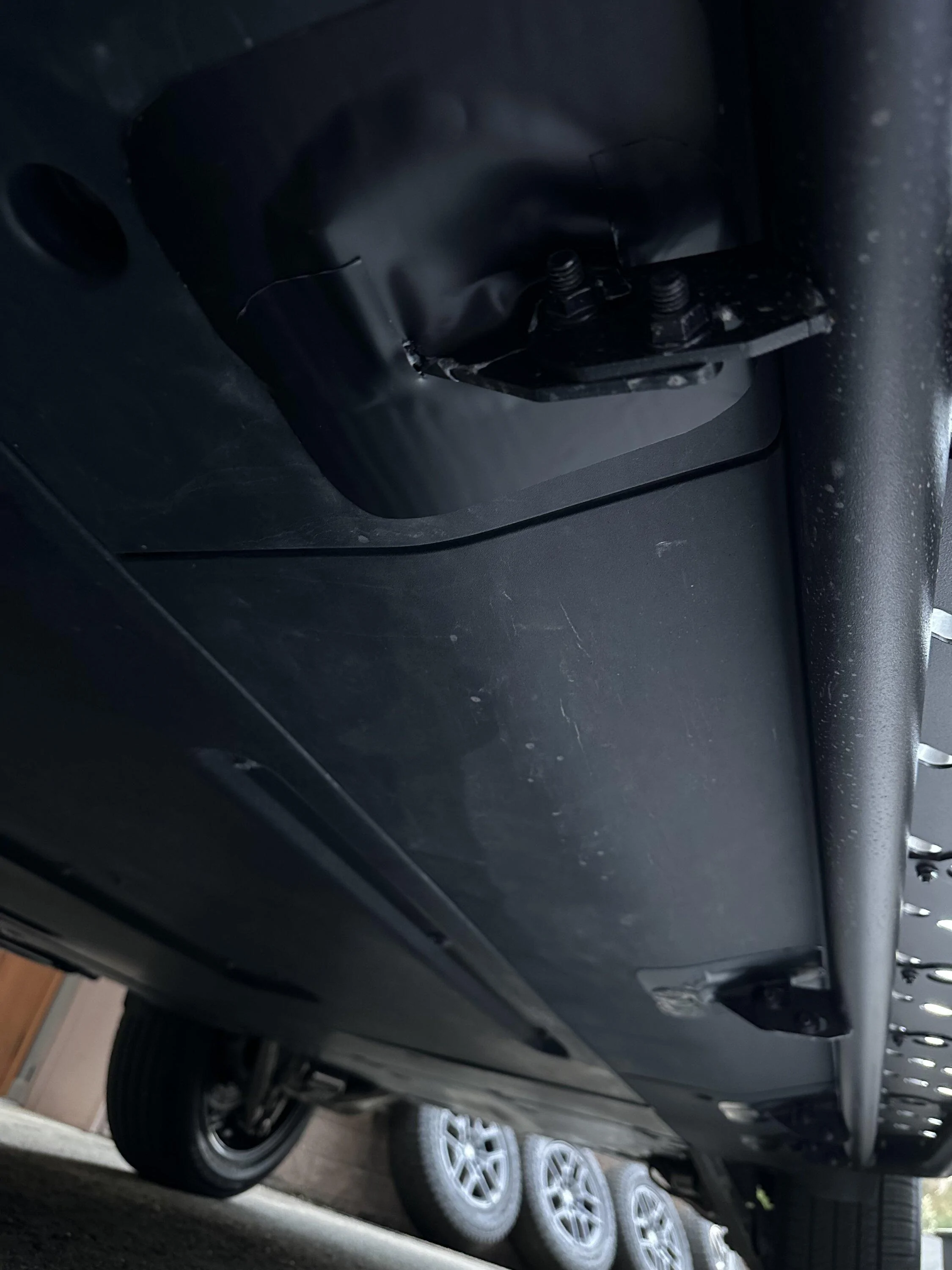

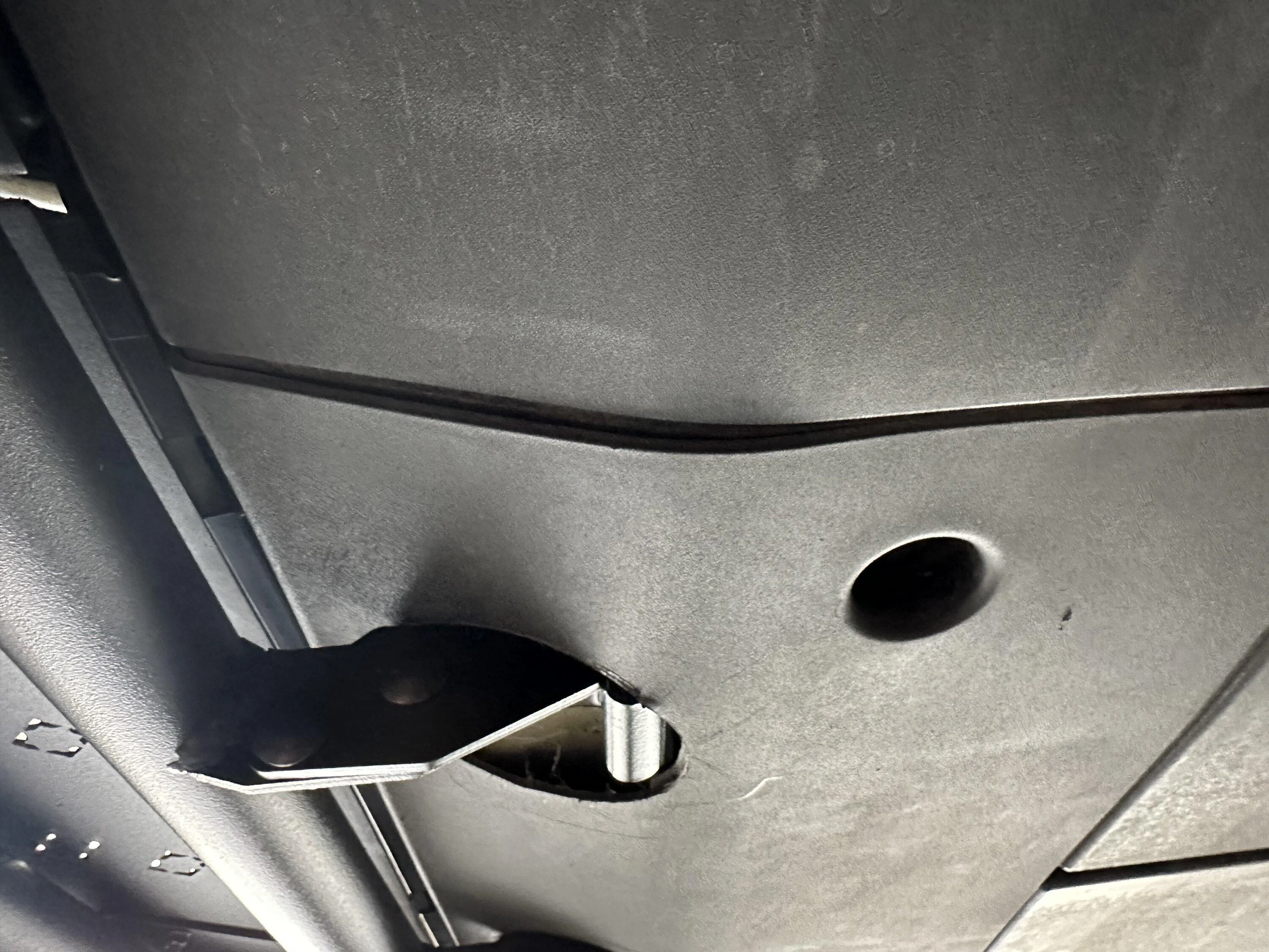

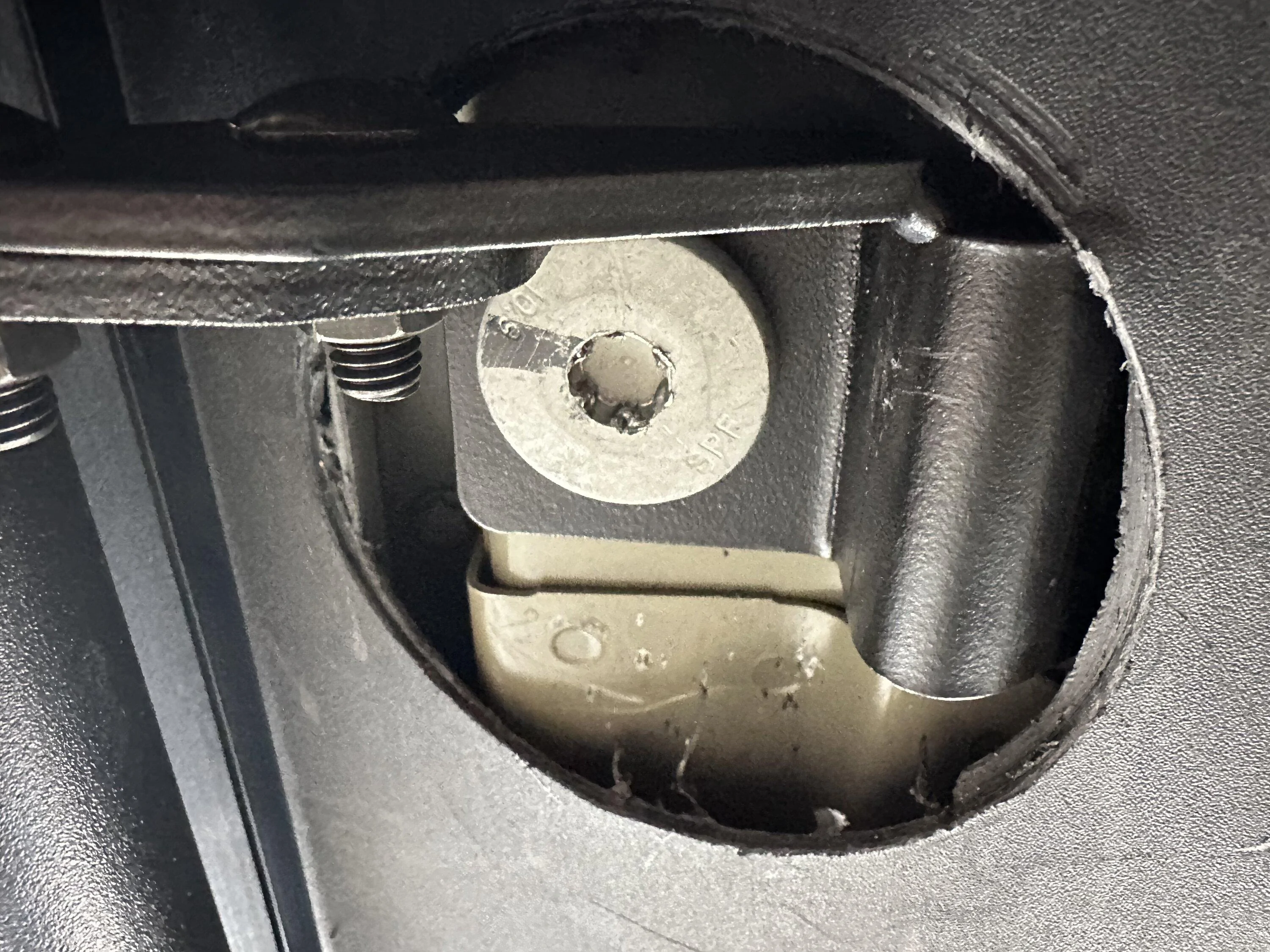

Progress. Guess measurement off one hole. Made putting in bolt back in difficult. Don’t want to play it more

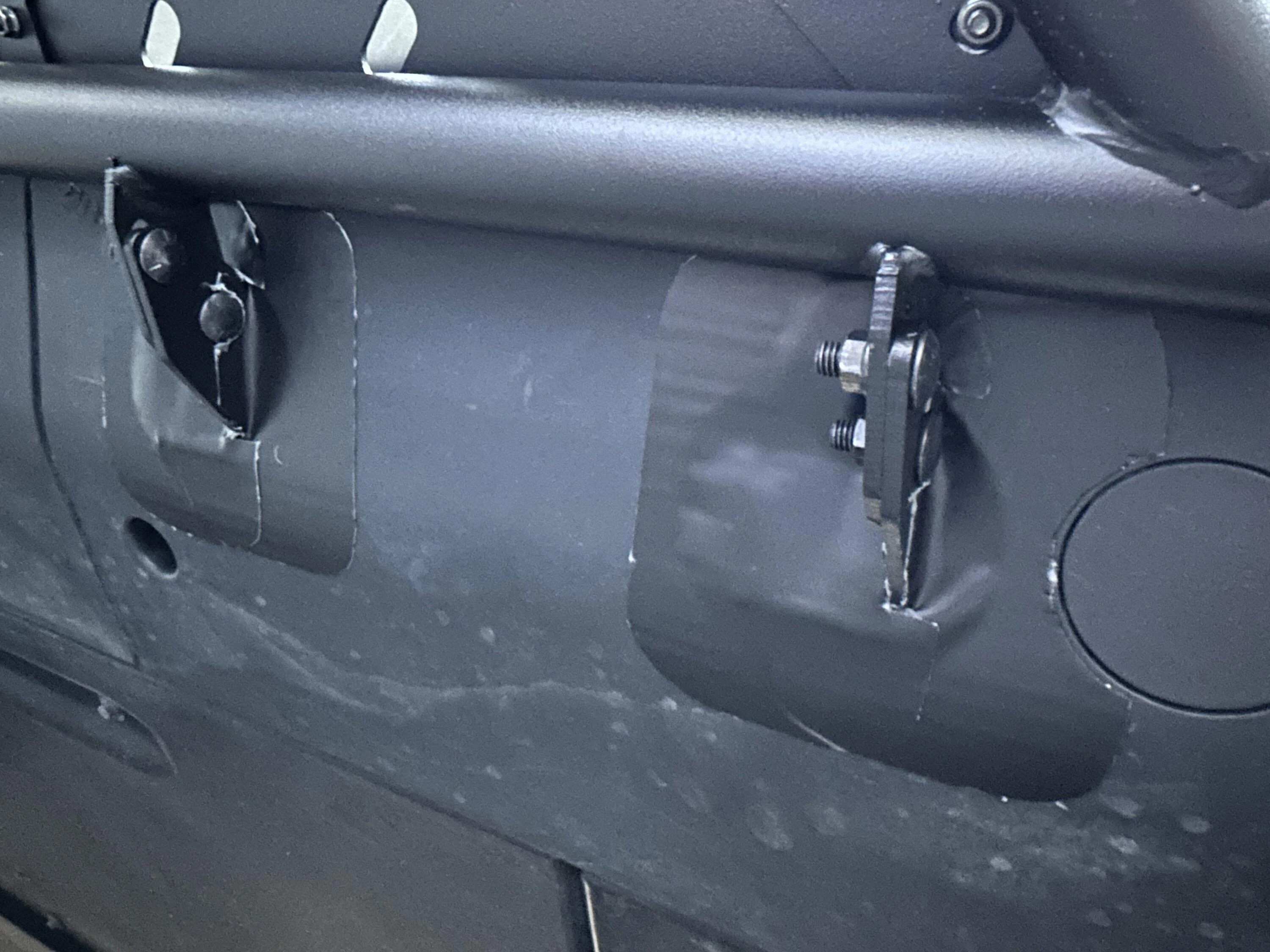

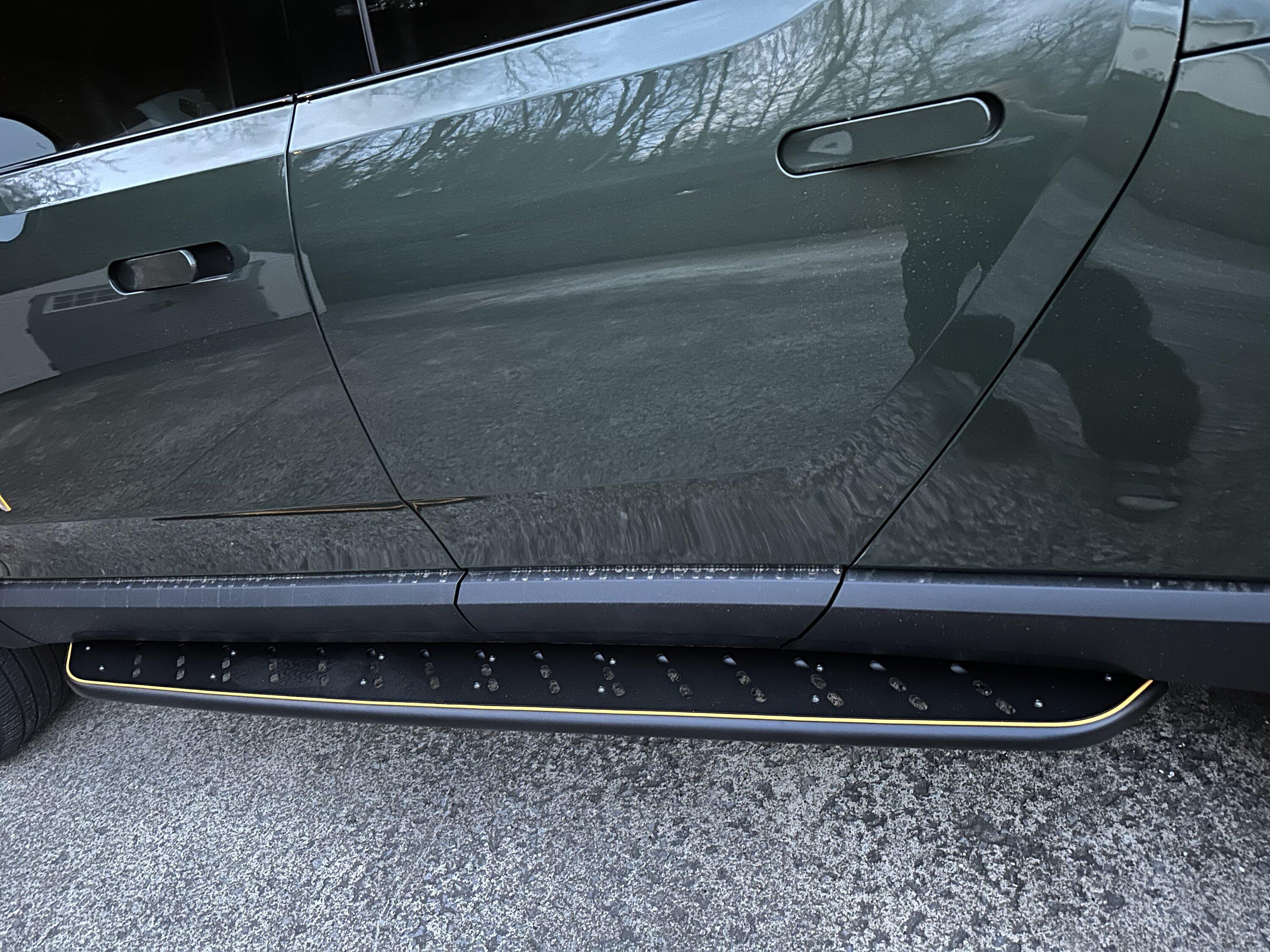

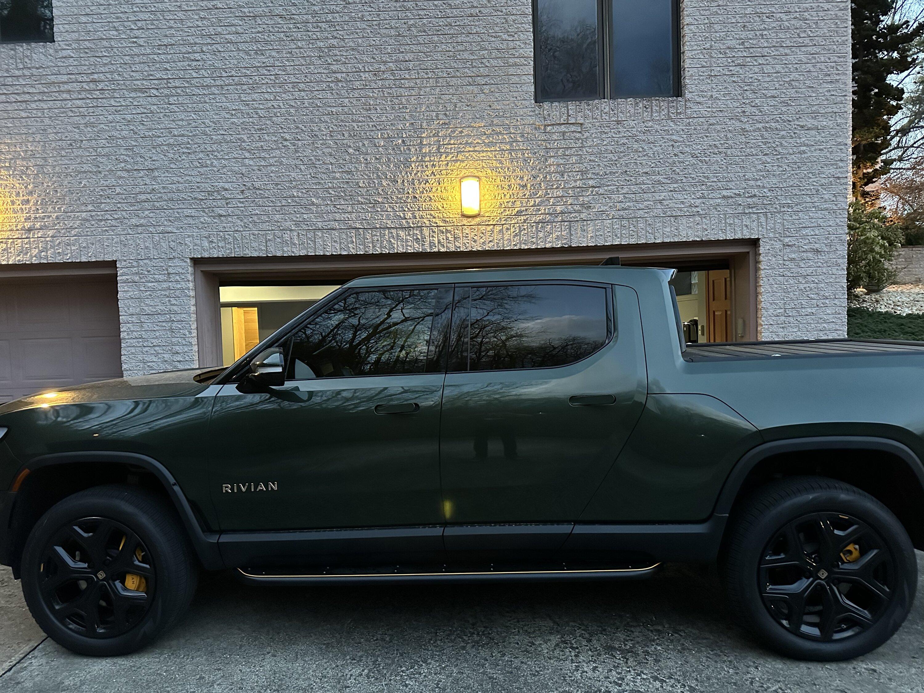

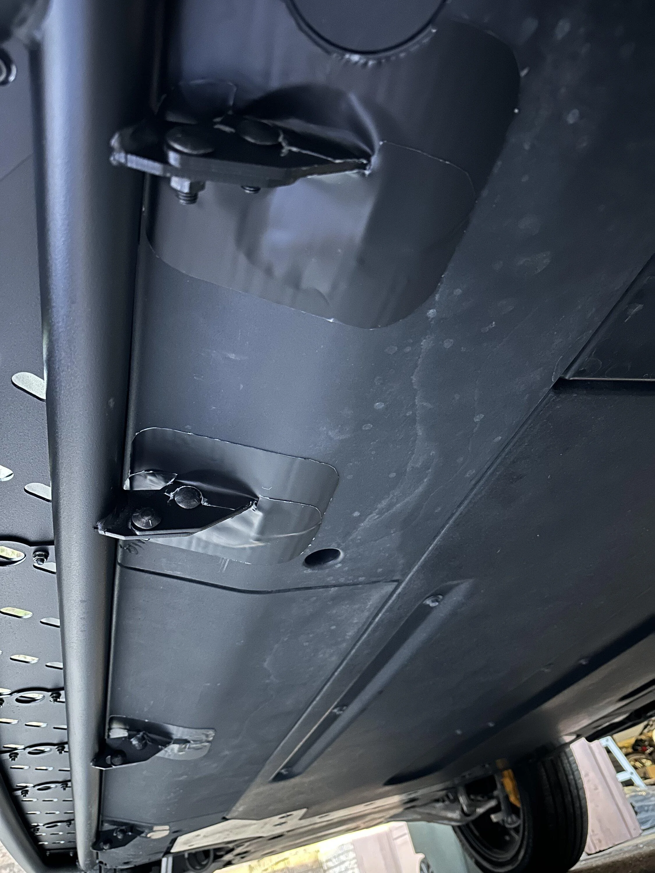

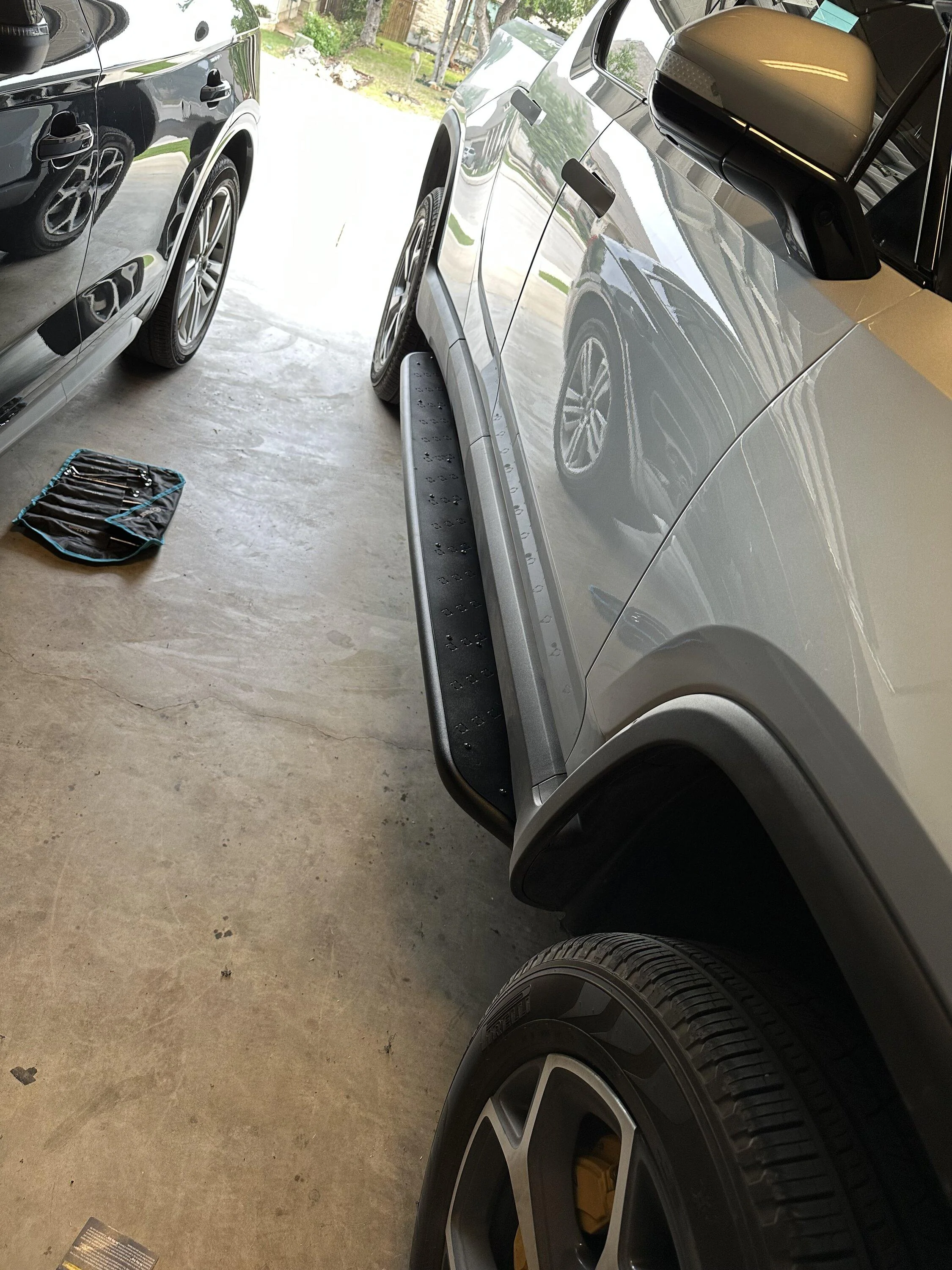

So I didn’t get the TP55 in my hardware kit. The bit hasn’t shipped as of today, exactly one week since I got the running boards. Glad I went ahead and ordered the bit from Amazon on Monday. It arrived today, and running boards went on the truck without issues. I partially opened the plastic panels to drill the 4” holes so as not to cut into the frame, installed the brackets, and closed the panels back up. I weighed the running boards before bolting them on the brackets, exactly 35 lbs each. The final step was using @jebinc method of sealing the holes with the Gorilla patch. Everything came out looking good! Pictures taken as the sun was going down so lighting was not great.

Looks great. Need to do that tape as well. Was too tired the other night
