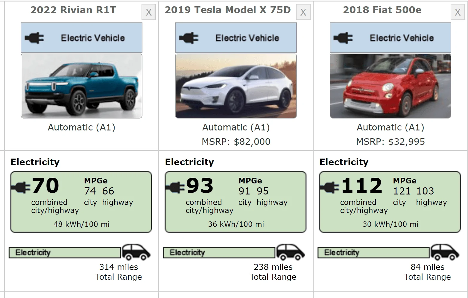

EVs don't all get the same range per kWh
Rivian R1T R1S Home Charging Speed 1633016636793
Look at the MPGe and kWh/100 miles numbers.

You are comparing the wh/mi numbers. Adding "152.35 miles" in a Tesla X will take less energy than adding "152.35 miles" in a Rivian R1T because it takes more wh per mile to travel that same 152.35 miles in a Rivian.

48A @ 240V is 11,520W or 11.5kW. EPA says it takes 480W of from-the-wall power to go 1 mile (accounts for charging inefficiencies) so that 11.5kWh would get you 11,520W / 480W = 24 miles of range gained, per hour.
Your Fiat 500E has an EPA rating of 300W per mile. So the same charger (assuming Fiat can take 48A -- I haven't checked that) would get you 11,520W / 300W = 38.4 miles of range gained, per hour.
At 32A, Rivian would be 7,680W / 480W = 16 miles per hour.
At 32A, Fiat 500E would be 7,680W / 300W = 25.6 miles per hour.
