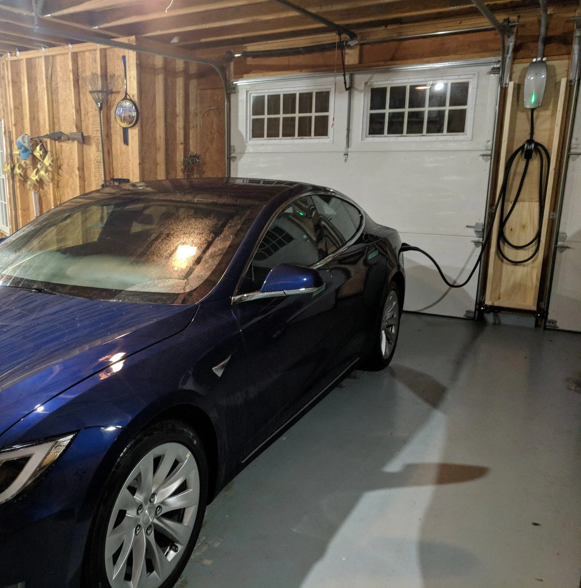

Reaching out for input to those with more experience in this regard. We have a 2018 Tesla in the house with a Tesla charger set up in the garage. I'm a 2019 R1T res holder and a 2021 R1S res on the books. The Tesla will eventually go when the R1S is delivered. I'm trying to map out the best home charging setup options during the transition. Any thoughts?

Clearly the simplest option is to do nothing - just charge the Rivian with the Tesla HPWC, Yes you will have to unwrap the cable to reach the Rivian front charging port location and re-wrap it when finished if you want to keep it neat and whether you decide to change or not will be motivated by how troublesome you find that cable fumbling relative to how painful you find having to spring for different EVSE and the costs of locating or relocating EVSE elsewhere.
Certainly the most convenient location for EVSE is where minimum cable handling is necessary and that means putting it about where you stood when you took the picture. I don't know what the garage structure is like at that point but it looks as if conduit could be run across the ceiling from the HPWC location to such a point fairly easily.

OP has a lot of unfinished garage space from his picture. Probably would be easy to flip that HPWC to some 14-50s as well.

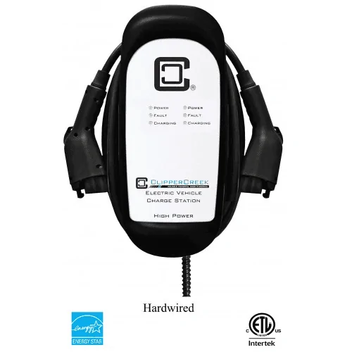

Rivian R1T R1S Home charging scenario with a Tesla and Rivian 1629930598407
Could swap your Tesla HPWC for a Clipper Creek Dual Charging station, there are a couple dual charging stations on the market. then use the adaptor for your tesla.
Hilbe
Jul 22, 2021
88
125
Fishers, IN
Tesla MS P100D, Tesla MX 90D Unicorn, Rivian R1S
Wow. That thing is expensive. Would love one that took advantage of the 100A circuit I have run.

Wattzilla makes chargers that will deliver 80 A from a 100A circuit. Problem is your cars/trucks won't take that much (I think the F-150 might) and if you think Clipper Creek is expensive....
