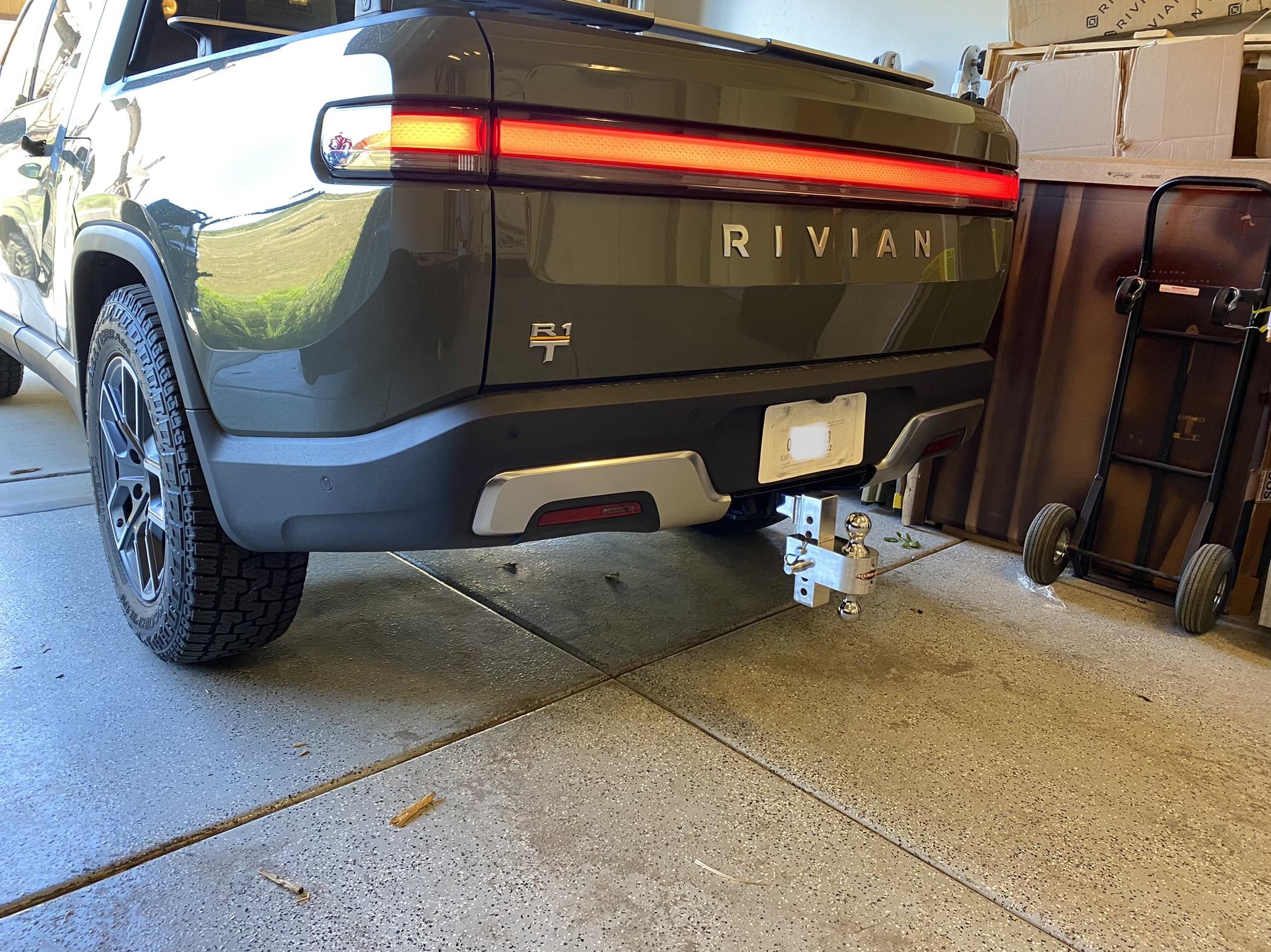

I ordered this today on sale from Costco. Hopefully it fits and the pins are long enough. I liked that it’s aluminum, adjustable and comes with 3 different sized balls. Seemed like a decent deal.
https://www.costco.com/uriah-aluma-tow-12,000-lbs-capacity-adjustable-aluminum-drop-hitch,-6"-drop,-6-34"-rise.product.100989282.html
Replying to my own post with an update. Hitch arrived yesterday from Costco. Installed it this morning and the locking pin is plenty long enough to get through the Rivian receiver with about 1/2” to spare.
Seems to be plenty of clearance around the bumper as well; however, it will NOT work in the inverse position where the vertical shaft is providing rise vs drop. It does not extend out far enough for that.

I tried several different pins and I am confirming that using a pin for a 2.5” receiver is required due to the extra length. I also tried several anti-rattle clamps. This did not reauire a clamp for a 2.5” hitch-the 2” hitch model fit.
So what do you think? Better to go with something that has a bit more length to it instead?
I guess it really depends on what you’re planning to tow and the “level” tongue height for the trailer. I primarily tow a flatbed utility trailer that has a pretty low level tongue height, so not being able to invert the hitch isn’t really an issue for me.
