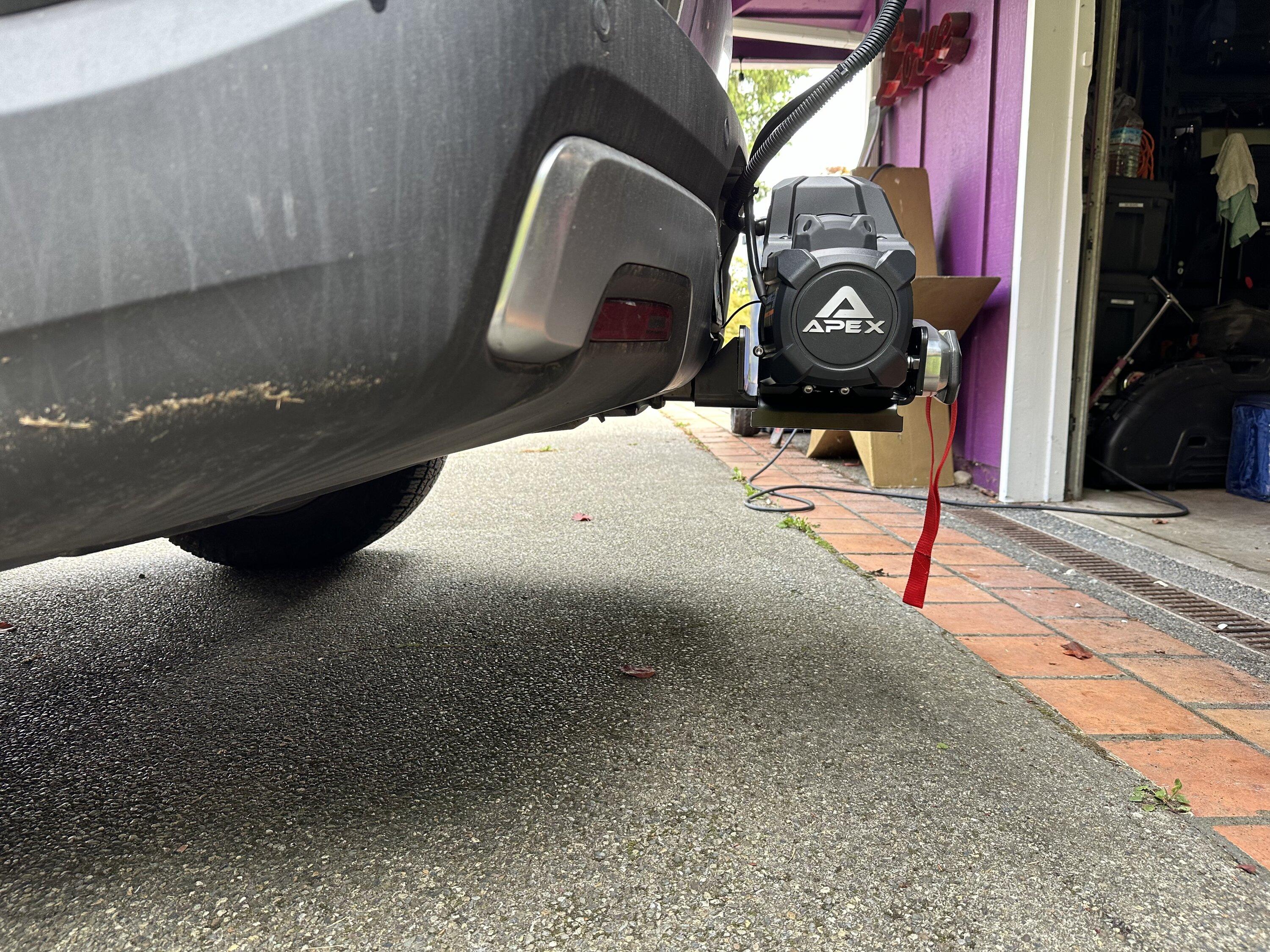

Got it. I think this could be a really simple and smart way for Rivian owners to mount a winch. Look forward to seeing how it works out.

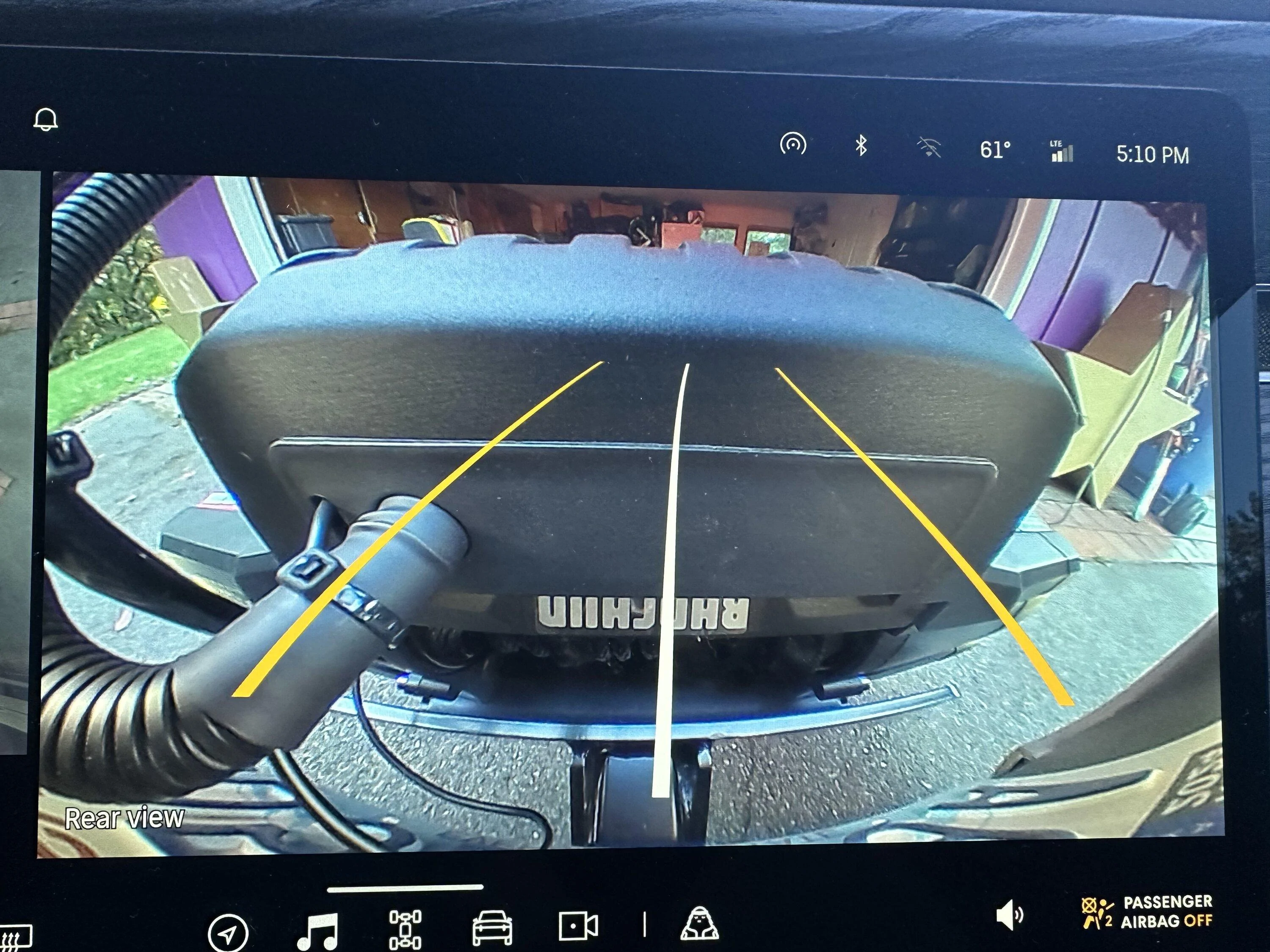

Two shortcomings from playing around with it today:
1) it covers a large portion of the rear camera (annoying as it would be nice to look at it while winching yourself back).
2) can’t lower the tailgate with that on (maybe some of those tiltable hitch extenders though I haven’t seen one sturdy enough to trust)
Have you tried mounting it upside down? Assuming it just slides in the receiver. Should give you a better camera view, at least of the tension on your line, and may be able to put the tailgate down.
