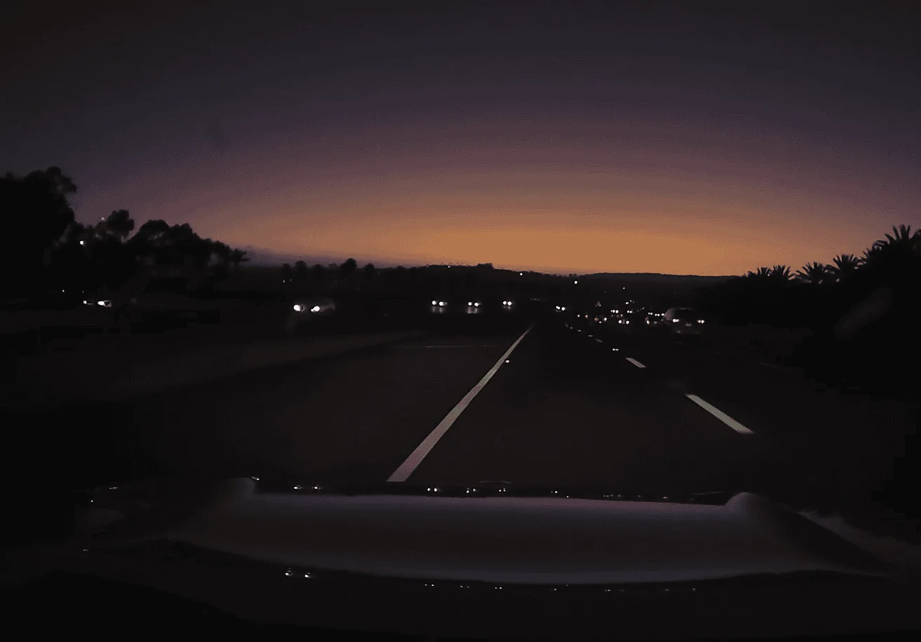

Also read before you watch and comment: At about 0:06 into the video, the car pulls hard left out of the lane towards the center divider. I pulled immediately hard on the steering wheel to the right to counteract which cancelled the lane keeping Highway Assist . It's hard to say if it was going to run us directly into the wall or not but it sure felt like it. The video really doesn't show the intensity of the movement obviously but I can tell you that it wasn't subtle and at 80mph it could have been disastrous. It was enough to bash my son around the back seat and smash his head into the door pretty hard. I'm confident if the divider was closer like many LA freeways are we would have had a really rough night.

It was about simultaneous, in fact I didn't even have time to look down at the dash I can't tell you what it was going to say. It beeped and went off the road within about 1 second. It might have actually been the reason I reacted quickly now that I think about it. Without that noise I might have been 1 second too late. That specific area of the road has a slight dip to it and I think it just overreacted to elevation change. But it hadn't stopped control of the vehicle yet because when I pulled on the wheel I could easily feel the hold it still had on the wheel, which cancelled right away as I pulled.

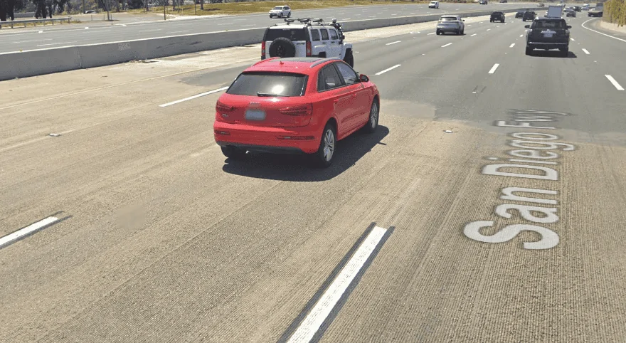

I wonder if it became confused when the pavement changed? I know when i was driving a tesla, I was surprised by its ability to utilize groves in the road to more or less approximate where the vehicle should be, despite the painted lines not being visible at all. I'm curious if a similar redundancy overrode the vehicles standard practice to follow the painted lines in your instance.

It could be it thought there was an object in the road. My adaptive cruise has been fooled by the shadow of an overpass once. Hard to see it in the video but upon watching a few times, it looks like the truck might be trying to avoid the darker section of pavement that doesn't quite take up the whole lane.
You might be right. That section of the road does have several different textures but the lane markers were pretty clearly marked along the way. I can't be sure. All I know is that I've had about 400 miles of self-driving so far and it was otherwise pretty smooth. I find it especially useful in stop and go traffic conditions.

Hopefully not sounding insensitive to OP, but this is a fairly "normal" event with autosteer systems. They are not self driving, and it would probably behoove everyone for us all to stop referring to them as such. That being said, this would be business as usual for any other automaker, but can certainly be twisted into a negative story about a new one like Rivian.
These things also happen more frequently in a) low light situations, particularly at transition from day to night like in the video, and b) when cresting a hill because as you near the apex the cameras lose sight of any road markings, so to the system it thinks the road vanished. Keeping these things in mind can help others be able to anticipate when the system will be at it's weakest and to increase alertness. That last point can't be overstated enough, it's critical to learn your systems strengths, but way more importantly, it's weaknesses.
