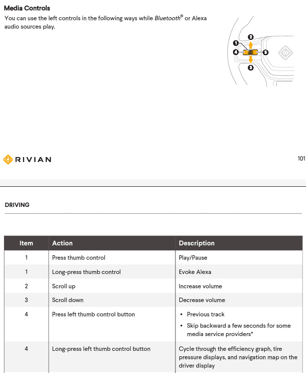

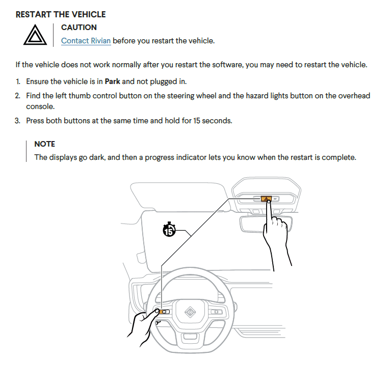

Is there a repository of 'hidden' commands - like 'Hold Left Steering wheel button for tire pressure' or 'Hold Left Steering wheel button and hazard flasher to reboot vehicle'? I can't seem to find either of these in the owner's manual and keep stumbling across these in various threads

I did see the restart section, but there doesn't seem to be a direction to display tire pressures in the TPMS section and onwards. I wondered if there might be other types of commands not listed.

I know you are saying this to yourself but for future searches like you from reddit or google:
Longpress the left handed buttons on the wheel (not the scroll wheel the buttons on either side) to switch between Tire Pressure/ Efficiency/ Mini Map on the left side of the steering wheel screen

you can use longpress, left blinker, and hazard simultaneously to have your R1x say "read the manual"

They should put a reference in the manual to the tire pressure display in the section about TPMS, so I would agree it's kind of hidden somewhat.
