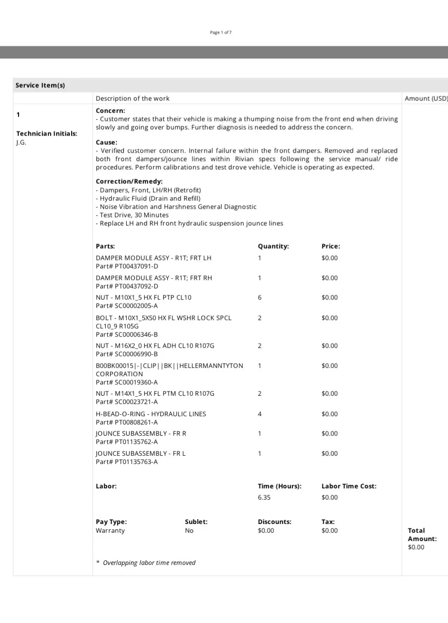

I just had my front dampers and jounce lines replaced under warranty
It was making a similar noise but more pronounced at slow speeds, going around corners, where there are bumps. But when I brought it in for the noise to the SC the advisor who drove with me in the truck heard it and said he thinks he knows just what it is. They diagnosed it the next day.
if you have this noise and it is annoying you I would try a different SC and see what they say.
good luck
Care to share the repair order details?
