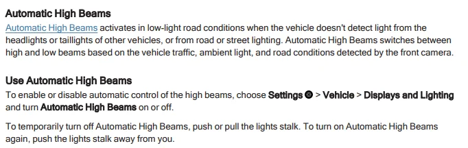

This behavior is definitely documented. Of course Rivian has multiple sections on the Automatic High Beams in the manual, so it's not immediately easy to find, since the table of contents leads you to the other section.
Damn, I intentionally looked at the manual just before I made the post and did not see this section.... ?
