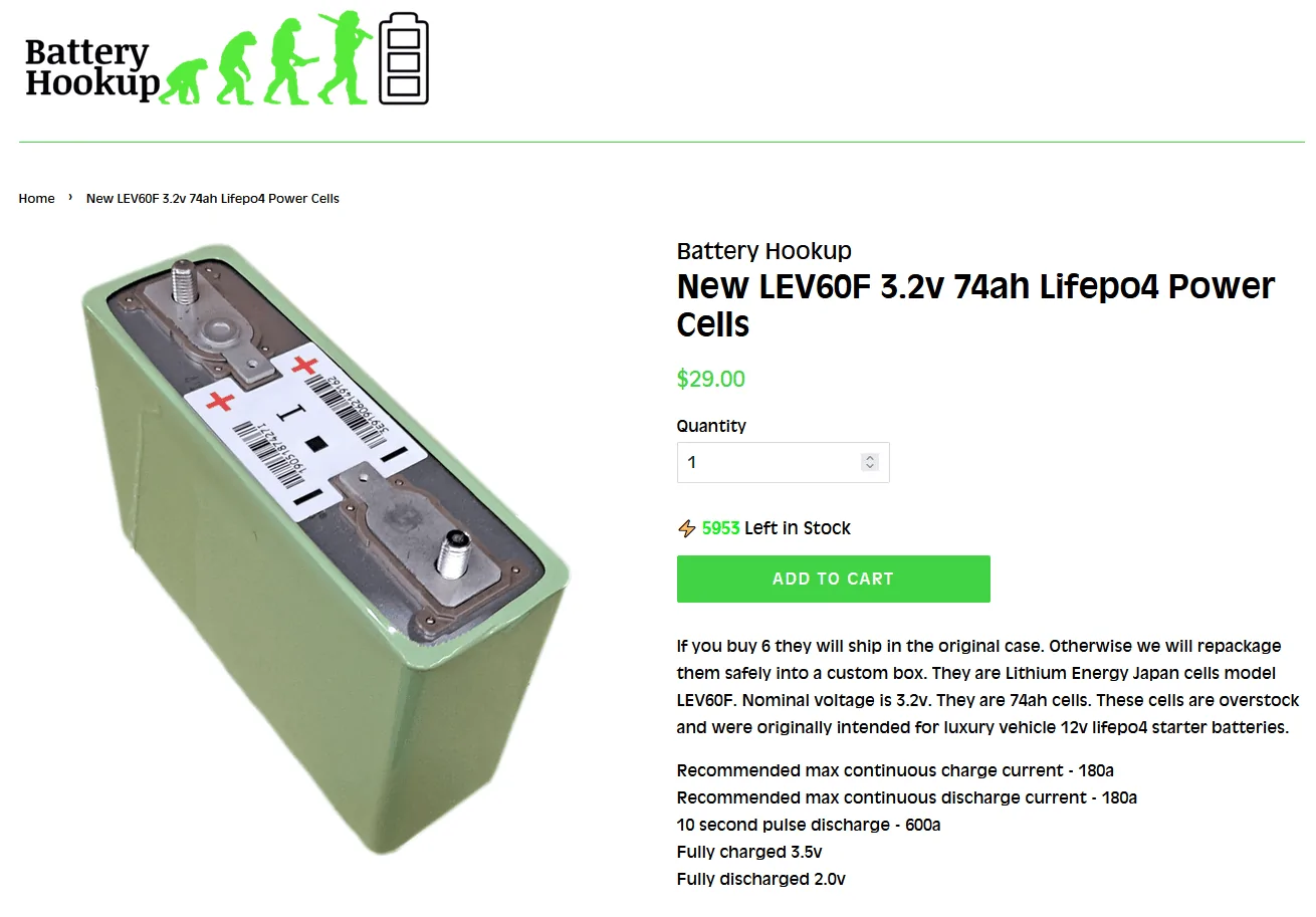

For charging I've been thinking to use a 4S 10000mAh 25C lipo. Keep it at storage charge (say 3.8-3.85 volts). That will provide 15.5-ish volts to charge the truck battery. Being a 25C pack, it will be happy to deliver 30 amps for several hours.
Tell me why this is a bad idea (many of mine are).
A 10,000mAh battery pack is only 10Ah.. might not be enough to jump a flat SLA 12V Rivian battery because the second you connect your full battery to the drained Rivian 12V battery your jumper battery will start discharging.
I would be very leery about permanently storing any Lithium based battery pack anywhere inside my vehicle knowing how hot the interior (and Frunk) get in the summer and how cold the same areas get in the winter.
Vehicle manufacturers are using LiFePO4 cells for their batteries vs Lithium Polymer cells if they decide to ditch the lead-acid 12V battery.
Something like this would work and the cell below is 74Ah, a 200amp BMS should handle the load.
So you would need 4 in series?
NY_Rob
Feb 9, 2022
5,400
7,977
long island
Yes, with a properly sized BMS of course.. those cells can safely deliver 180amps, so a 200amp BMS would do.
