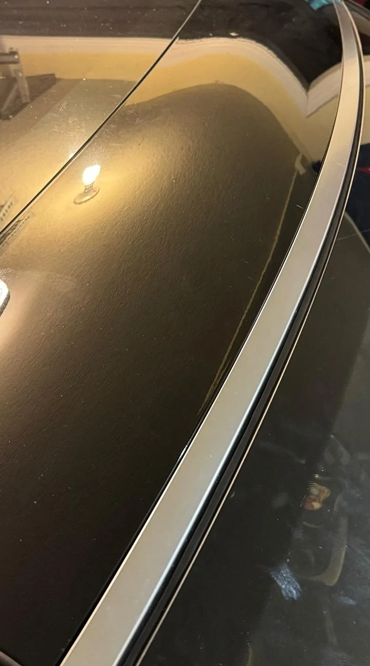

If anyone is having wind noise from the top of the windshield 8mm uxcell rubber tubing fit mine perfectly. I had also bought the T shaped seal but wasn’t a fan of the look.
Did it fix the wind noise?
