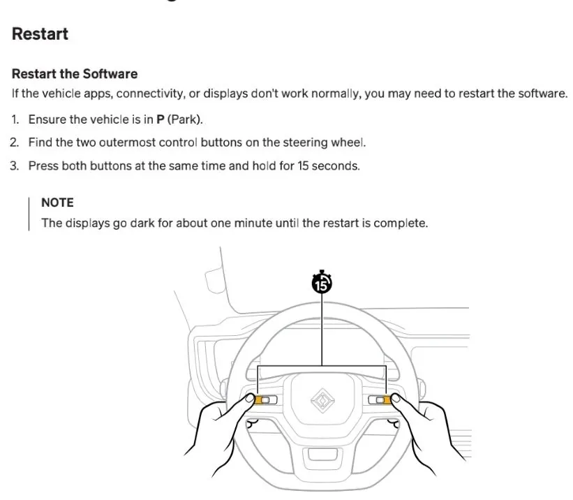

You have a USB drive, flash drive, portable external hard drive, or something else plugged into the center console? Unplug it and plug back in. Test it on a PC while it's out, if you want. If that doesn't work, try infotainment reset:

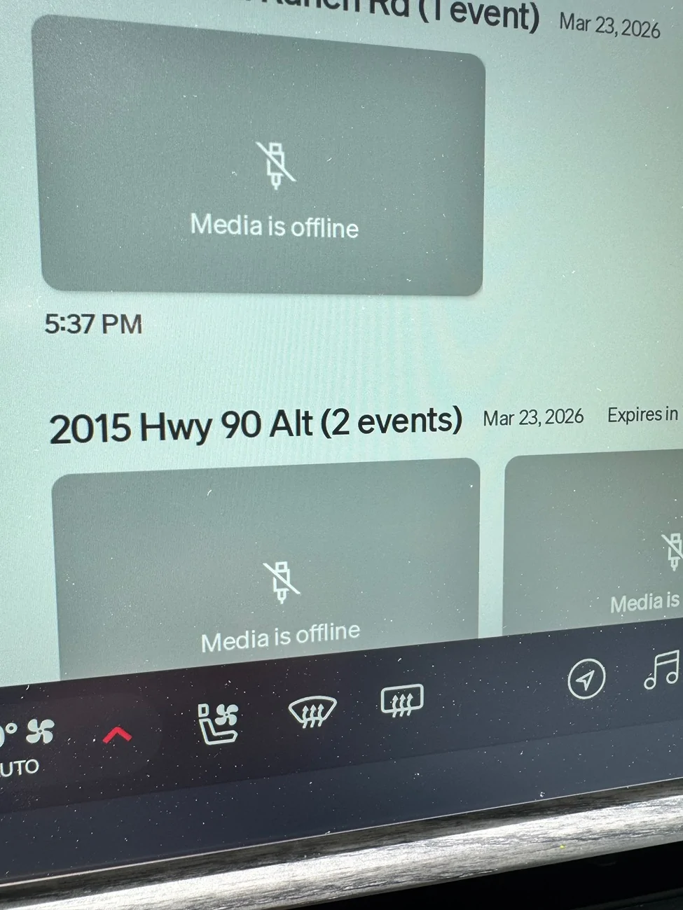

yes, I have a 1 tb Sandisk Extreme Pro SSD in the center console. I unplugged and plugged it back in and it didn’t fix it. I can see the recordings when I connect it to my computer.
This is actually the 2nd time it happened. 1st was fix by a soft reset. I’m curious why this is happening.
